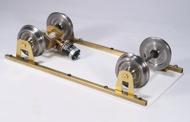

Model Story
It seemed like a good project to make with polystyrene sheet, which I haven't used for a while, so a set of wheels were turned up early this year during a lull in track construction. Building an IP kit might have been easier, but this cost a tenth of what the kit does and can't get lost in the mail.
The model is based on the well known Tralee & Dingle railway Inspection motor, which was built on a Baguley chassis in 1922 and powered by the drive train of a 1922 Ford Model T (or maybe a Ford TT truck, the sources aren't specific). I've changed/added a few details to make it a little more Australian and it is built in 15mm/ft scale.
The model drive is the same as that fitted into the recently built gang motor, a small 6V motor with a 60:1 reduction gearbox and bevel gears on the drive axle. This time around there was space for two more batteries and the wheels are larger, so it can manage a scale speed of 25mph, about twice the speed of the gang motor. It will easily haul a small mail/luggage van if needed.
I learnt the hard way not to trust plastic for scratchbuilt chassis work many years ago when working in HO, so this model has the gearbox, chassis rails and w-irons fabricated in brass for strength and stability.
Construction started in mid-July and the first photo shows the chassis structure assembled and screwed to the floor of the model. As always, I had run out of 60 thou. and 80 thou. polystyrene sheet, so the floor was laminated from two layers of 40 thou.
This assembly tested out OK on the bench using a HO controller, so the next step was to wire up the electric bits. The original intention was to fit it with a manual speed control, but in the event the simple on-off switch used on the gang motor was fitted. This photo shows it wired up and running, controls are from the left, reversing switch, charging socket and charge/run switch.
This was in the dead of winter, so most of it's test running was done on the hall floor, much to the ginger cat's disgust when he saw it. Even with no rails it runs quite straight, so I know the axles are installed square and parallel.
