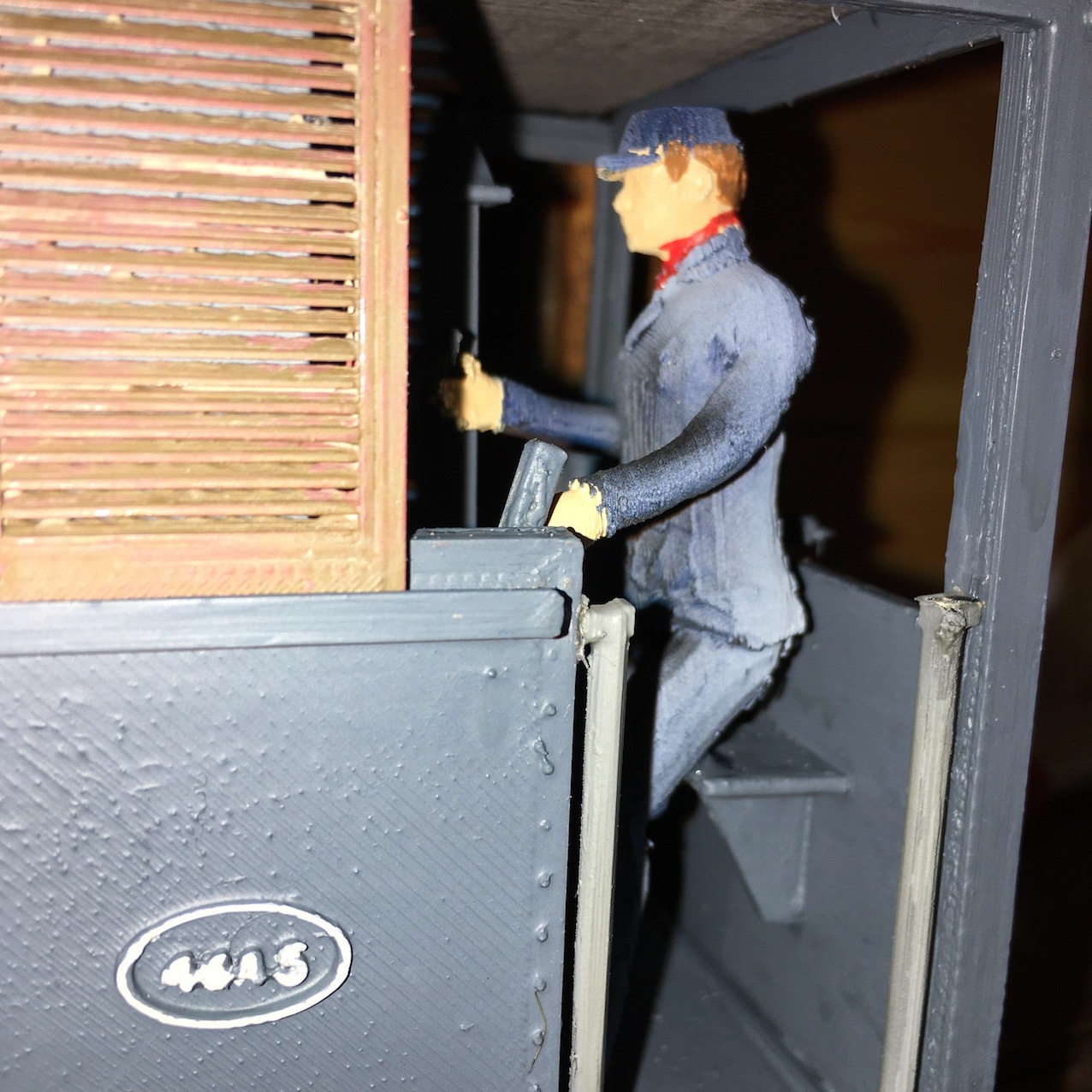

Pursuing my preparations for trying out a new resin printer I have been working out how to create specific figures. I know the printing is very rough - and that makes it impossible to get the painting right - but it does indicate where I can get to with this so far. Drivers for the Wren and 4415. I have created these drivers in "Makehuman" and adjusted their arms and legs in "Blender". Took a few tries to get it right, but here are the results.
The driver for 4415 straight out of the printer:
and cleaned up and offered up to the loco:
and finished:
and similarly the wren driver:
At least the figures look as if they fit in the space. The clothes are just cobbled together from the clothes that are on offer as pre-created "assets" in the "makehuman" community forum. That is a bit limiting - and I am working on how to at least modify those clothes, if not make my own. The big potential advantage of this as a process is that individual figures can be created. Just imagine making that quarry workers train (I made this time last year now) - with 100 different figures!

Looking good Trevor, much better than stock figures.
Interesting that the fascets are visible on yours, the same as they were on mine. Not sure if its an artefact from MH or Blender

Do they print out with the same facets on the resin printer?
- Posts: 6028
Re: 3 D Printing 16mm models
Trever,
The short answer is yes, they appear to be much the same.
If you look at https://gardenrails.org/forum/viewtopic ... r&start=15
The driver figure at the bottom of Steve's set of pictures is my MH-> Blender figure which he printed on his resin printer. It looks a better print than my 'Dr Who alien' effect, further up the thread, , but still shows the facets.

Yes I realised after I posted it that I had seen that set of posts and remembered the facets. I suppose its just the mesh which defines the surface of the figure / clothes being printed accurately.
I have tried to use the shooting feature in sketchup - which works on the screen but seems to revert to the actual outline when exported as an STL file. Have you any experience of success with that feature?
