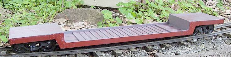

Instead of building a new wagon, I dug out the well wagon I built in 2005 but had seldom used and decided to use it to fit a ‘drop-in’ pool . It’s 550mm long with the centre ‘well’ about 300mm long.

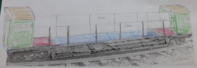

So it was time to start sketching and planning. (planning is usually done while lying awake in the middle of the night.)
So this is my rough sketch. green is the shower/change cubicle and red is the sunbaking area.
Not shown is the ‘bridge’.
to be continued when/if I get motivated.

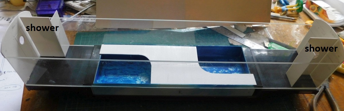

This is a mockup with the 2 pools, sunbake area between and at ends and shower rooms at each end. I can start painting soon.
this video shows more testing with the 2 pools. I think the wave action is acceptable now.

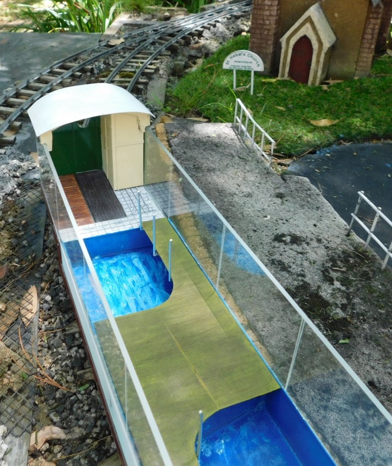

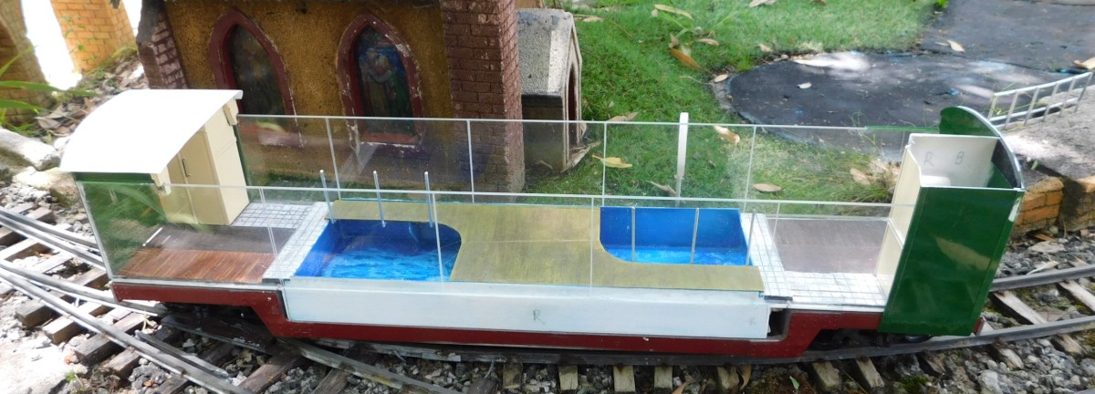

A little more progress as time permits.
The 'cabins' at either end are taking shape, as well as the walkway between the 2 ends.
The work remaining is the safety fence along the walkway and some sun lounges and swimmers in the water.
I have decided it will be called 'the Oasis pool" with decal signs on the perspex on either side, something like this....
