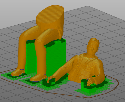

I would cut the horse in half and print the bottom half legs up and the top half head up and bond the two parts together. This way you get a good finish for the top side and the bottom side. I do this with my figures, especially sitting ones, cutting the body at an angle to minimise support required for the arms. Also reduces the re-print time if something goes wrong on one half of the object.Trevor Thompson wrote: Fri Nov 27, 2020 5:34 pm The problem with printing them this way up is that the roughest parts of the finished item are on the top where they are so obvious.

Now that is impressive.
Bookmarked for future reference

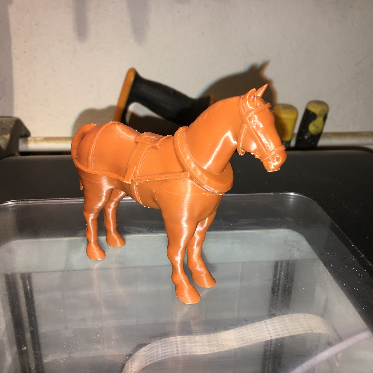

The horse. I have printed it the right way up - and it has worked. I thin my previous failures involved PLA rather than ABS, tree like supports and a more slender horse - more of a thoroughbred. This looks much more like a carthorse.
Printing in two parts seems a good idea - the supports are then in the middle and get glued together. As far as printing the tack separately - it won't work in this case. Look back at the screenshot showing the tack and you will see that the harnessing is formed from solid sections which are superimposed on the horse. The solid sections go through the horse, and only print because the slicing software recognises that only the outer surface is printable - the rest is solid. Well by slicing software does this.

So the horse the right way round - straight out of the printer:
and with the support filament knocked off:
I will try printing something in two parts soon. Probably most appropriate for a figure. This horse has printed very cleanly in one piece. Any roughness is underneaths where it isn't visible.

The horse looks really good now.

That is a flipping brilliant horse....

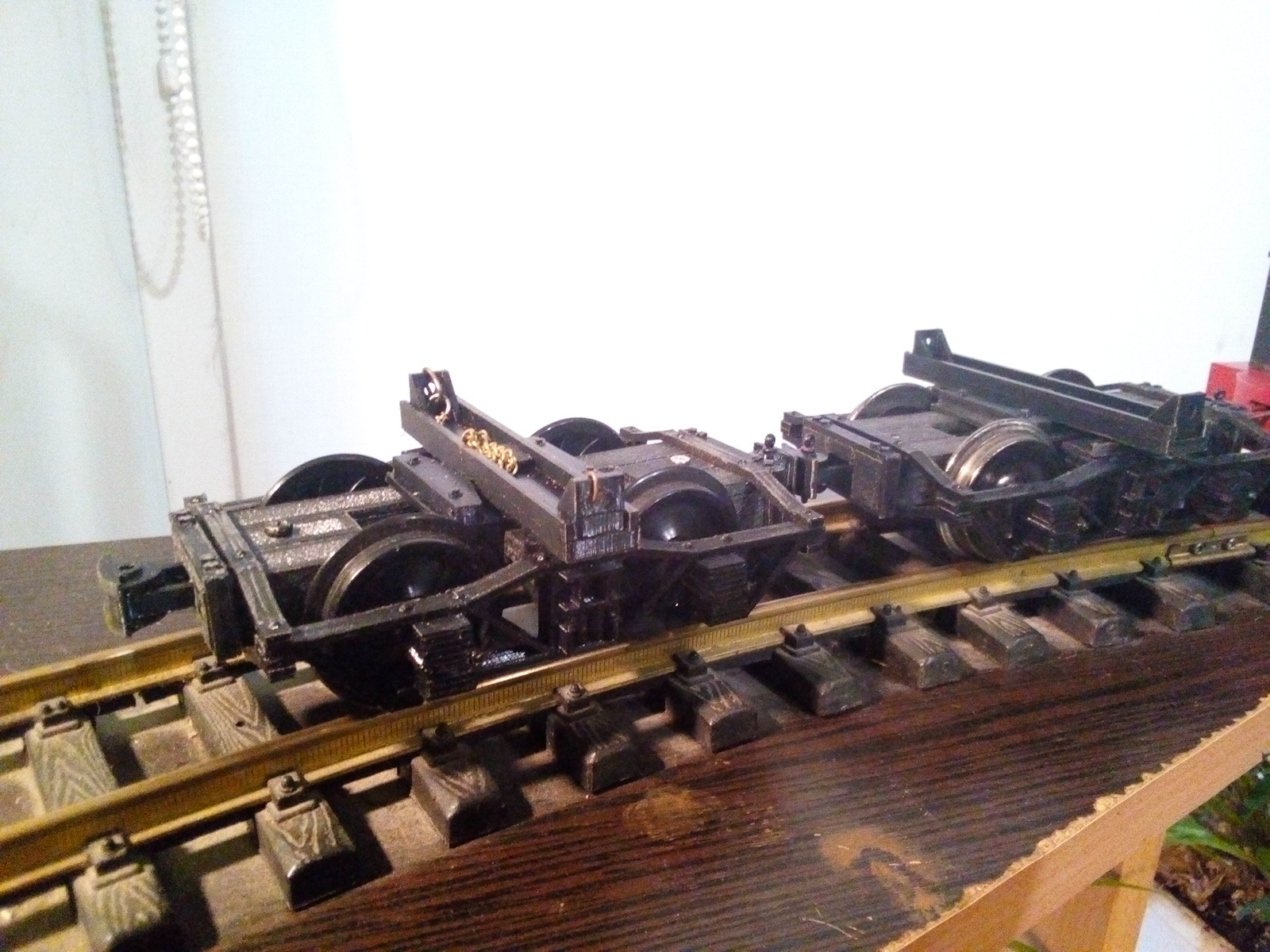

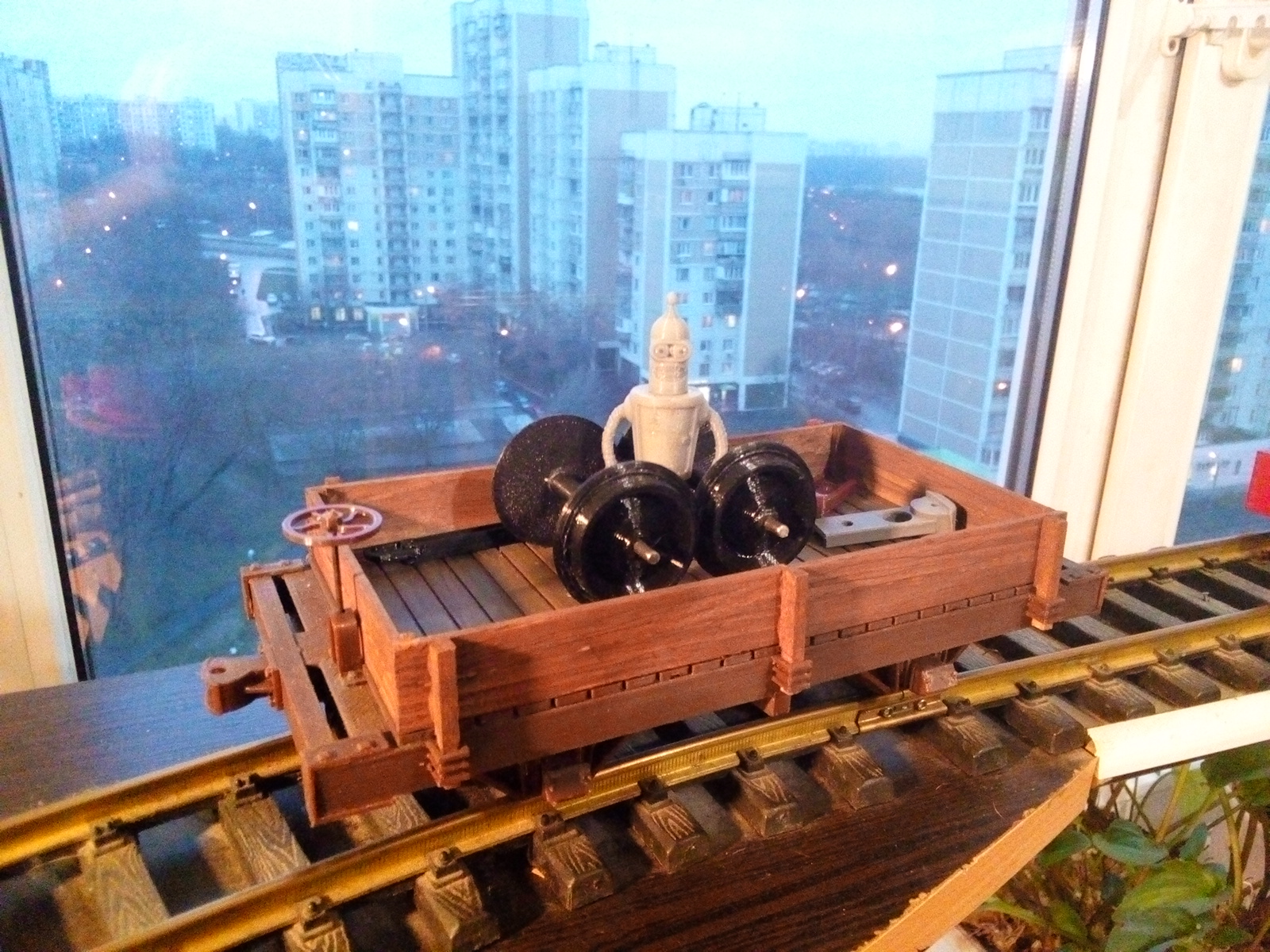

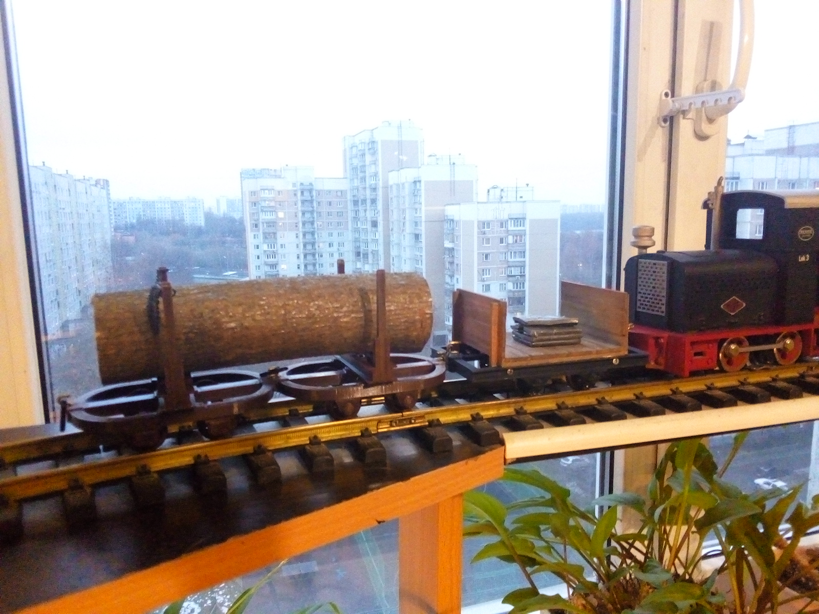

Hello! I follow the topic with interest. I have the same for a 3d printer. Htre is a photo of my models. I am using Tinkercad. I like the theme of logging and mining.

That is some fantastic work in Tinkercad, well done. I use Tinkercad too, which I know a couple of other people on here do too

Ruby, That is some beautiful work. The first picture is fabulous.

Great looking models. TinkerCAD is my chosen 3D drawing package. So much more intuitive than others I've tried.

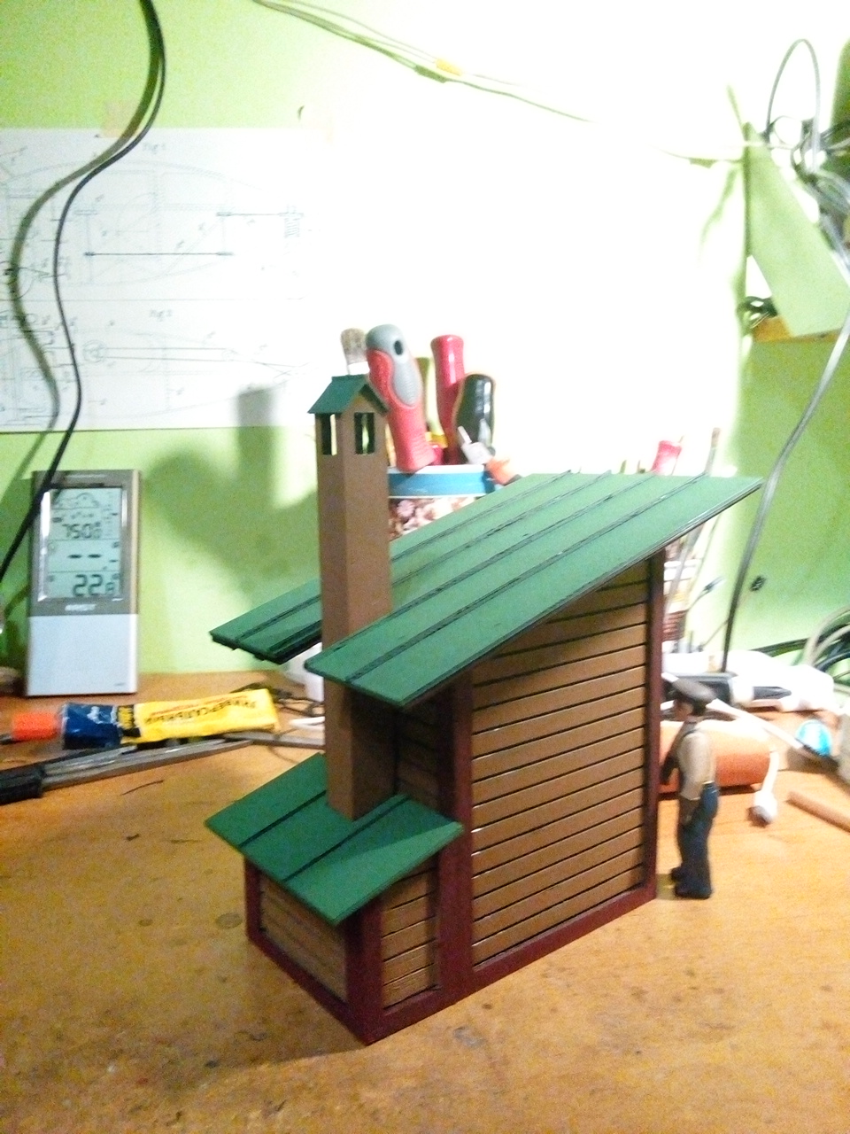

Very important 3d building
! A typical old railroad toilet.

Brilliant work Ruby!
I like the detail you are able to generate with TinkerCad.

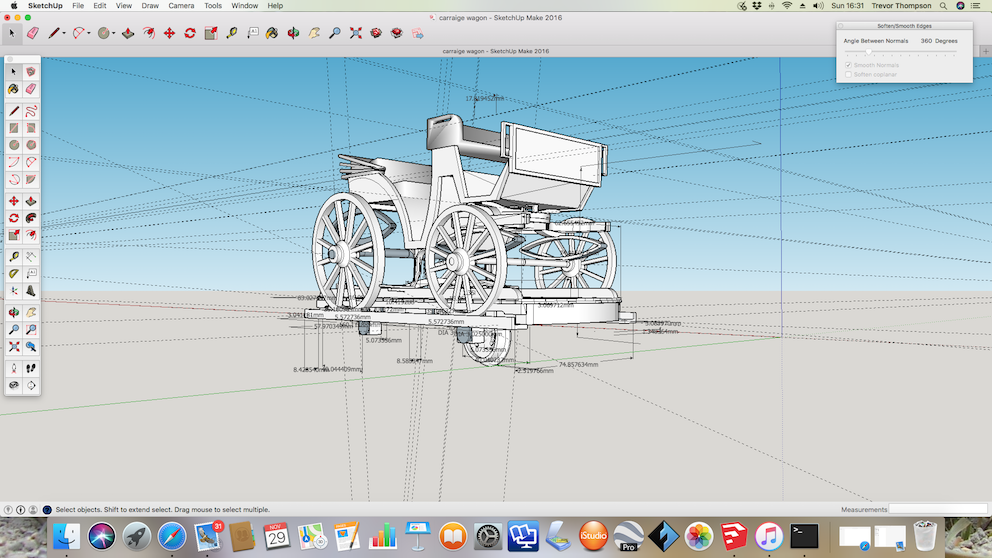

I have almost finished the Phaeton, and am about to start printing the carriage truck:
Just the passenger seat and the mudguards to go. The shafts in this case are separate, (which is why the front ends are resting on the ground) so that they can be stowed on the deck of the truck.
