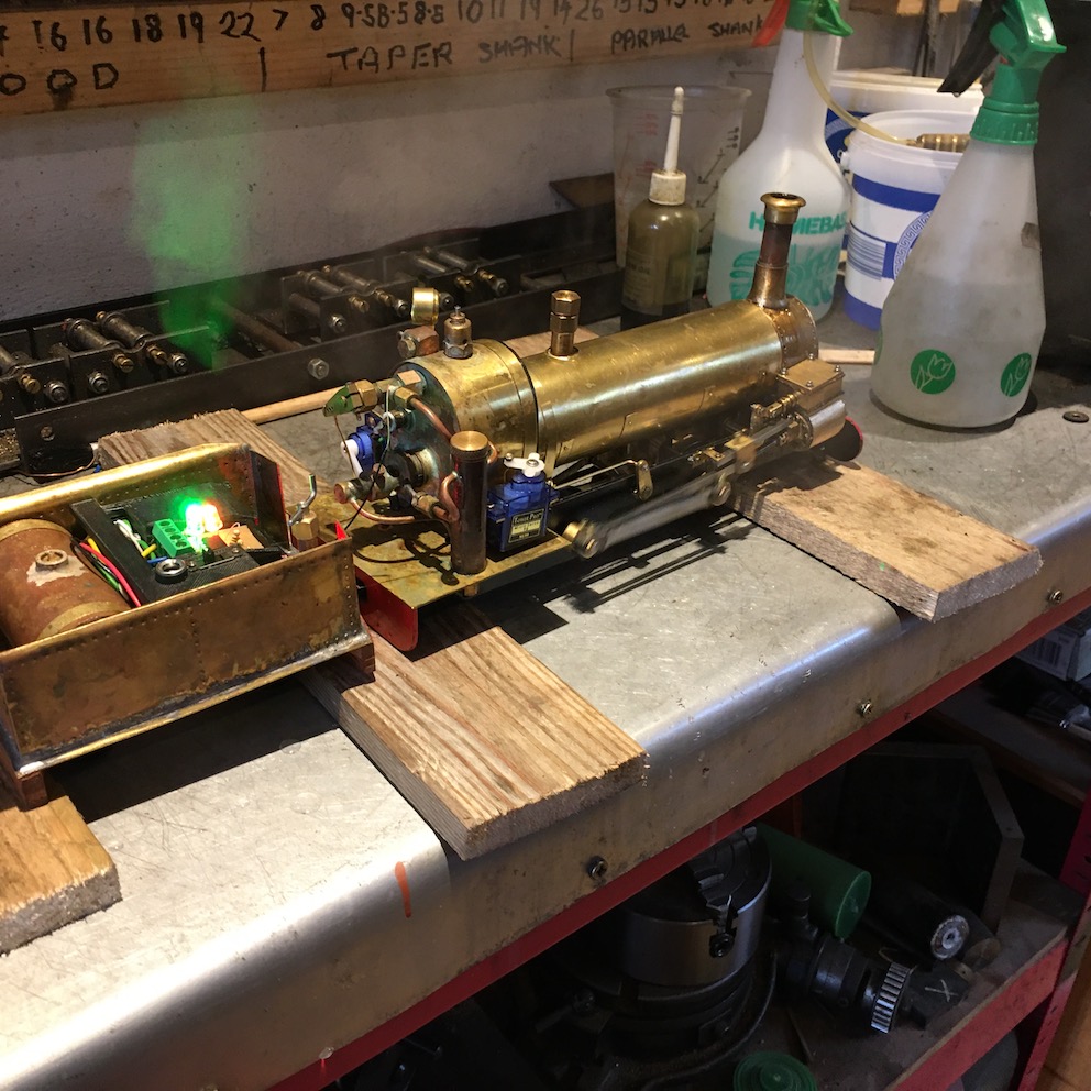

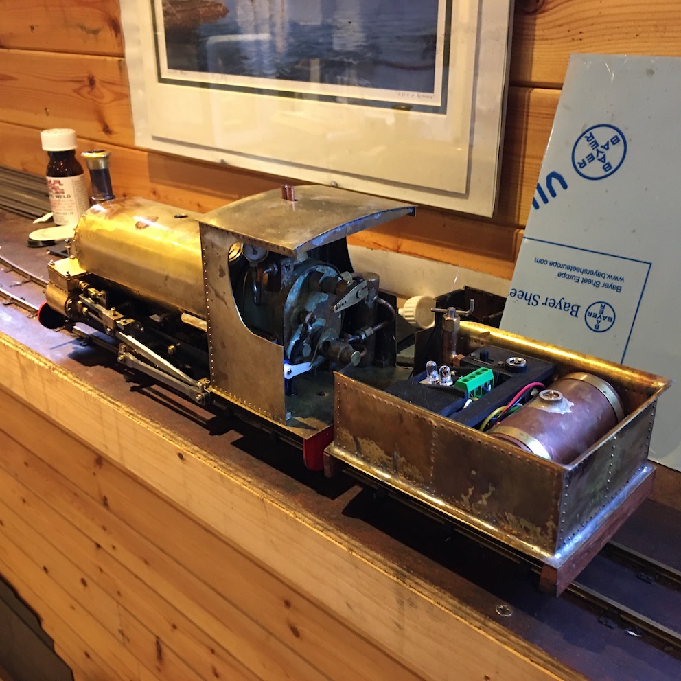

I think you are going to have to make some of these parts.
You should have received a set plastic cranks with each servo, as well as the screw to hold the crank to the servo.
Then you will need to drill a hole in the regulator arm and reverser arm. Exactly where may take some experimenting. and more than one hole would allow for adjustment.
Joining the two ends together can be done with lengths of brass or steel wire. Perhaps 0.8 to 1mm diameter. Just bend the wire to suit. If its wrong use another length of wire to try again.
Some examples.
A length of wire as a reach rod: wire for the regulator connection: and a close up of the regulator and whistle valve connections using wire: Trevor
Some examples.

In converting my Regner Konrad to RC I bought some "Pushrod Linkage Stoppers" which a friend in the Glamorgan and Gwent group advised me to use (I just went and searched on eBay...!)mymodeltrain wrote: Thu Nov 12, 2020 3:27 pm I had a Regner live steam locomotive in the past but I sold it. For somehow I started to get some interest in live steam again; probably, the approaching holidays always give me some good mood about garden trains. I just bought a second-hand Accucraft Mortimer on Ebay. And I also bought some servos and the receiver for RC modifications. I wonder where to find some connection gears, like the tiny screws, rods for connecting the servos to the regulator.
I found these absolutely invaluable - both in saving labour and allowing for easy adjustment of the linkages.
