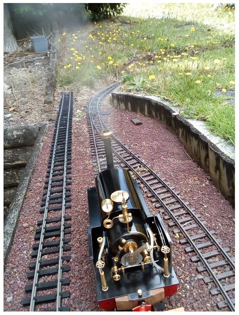

Post by dewintondave » Fri Jan 17, 2020 7:06 am
Had a great run this morning. The loco trots up the tight return loop like a welsh pony, this is normally difficult for a non-geared loco

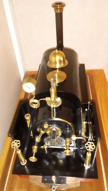

Post by dewintondave » Thu Mar 12, 2020 6:10 am
The final aesthetic, replacing the clear silicone water tubes with black coloured :thumbup:

That final picture shows what clean, solid work you've done on this engine. That is true industrial art.

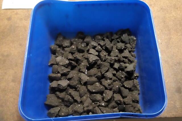

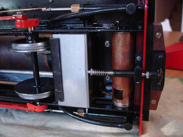

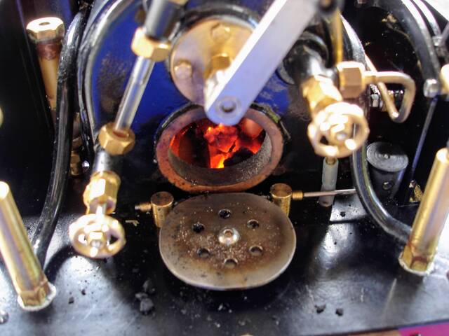

Tom, before the forum goes *poof*, yesterday I ran the loco on coal :king:
I had to come up a method of keeping the grate and pan in position
Ashpan knob below the buffer beam
First dump :thumbup:

Re: Wild Rose ~ Quarry Hunslet
Post by tom_tom_go » Sat Nov 07, 2020 4:43 am
I hope you enjoyed the smell!
Did you film the run?
Post by FWLR » Sat Nov 07, 2020 7:57 am
Fantastic bit of engineering there Dave. Well done...Brilliant.

Post by dewintondave » Sun Nov 08, 2020 1:56 am
Thank you lads! The smell was lovely! No filming yet, it was very stop and start, building up pressure, and running low on steam. Not helped by pumping too much into the boiler - the crown sheet was well covered :thumbup: Very little ash came through into the pan. I need to learn how to fire it. Not too much ash came into the smokebox either, I may need more blast

Had a great run on the rolling road yesterday. It's a good way to observe what's going on. I've downsized the exhaust nozzle from 2.0 to 1.5mm, but I may go further as exhaust is not as effective as blower at my speeds, and it's a shame to run the blower all the time. I'm using coconut based BBQ briquettes as fuel. The first run on the line a few days ago I filled the firebox and then lit with the blowtorch for top down burning. This time I lit individual pieces with the blowtorch and dropped them into the firebox (it's deep) for the first layer on the grate. With this "charcoal" very little suction is needed for them to catch alight and my weak little homemade fan is fine. After a while the blower can take over and this generates a lot of heat. I'm getting ash out of the funnel :thumbup:
