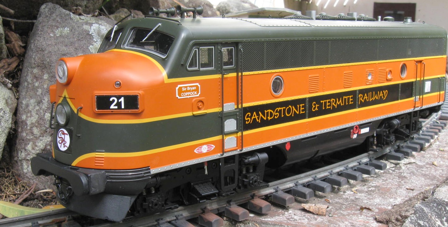

Quite a few years back I bought a USA Trains F3 diesel from a friend’s Estate.
This is a short description of how I converted it for use on the Sandstone and Termite.
Externally there is virtually no change. I added the lettering along the sides by printing onto glossy photo paper and gluing on. I named it for my late mate (and Knighted him!)
It comes with two motor blocks, but I always consider that an overkill, so I removed the front one (for a future scratchbuild). I kept the side frames and used a piece of wood and some plastic wheels for the front bogie. I also removed the lead weight over the rear, powered bogie as it has rubber tyres and I didn’t want to ever stall the wheels.

I ripped out all the existing wiring and circuit boards for the lighting. Then fitted a 3000 mAh 12V LiPo battery, Hobby king 2.4 GHz receiver and speed control. And a Talking Electronics sound board. BUT I also used a Picaxe circuit between the receiver speed control signal and ESC, to introduce a delay, so that the revs build up before the loco starts to move. (Later I’ll do a video so you can hear the effect.)
It had a speaker mounted facing down in the fuel tank but it did not provide enough volume, so I mounted a bigger one in the roof so the sound can get out through the long wire ‘grilles’.

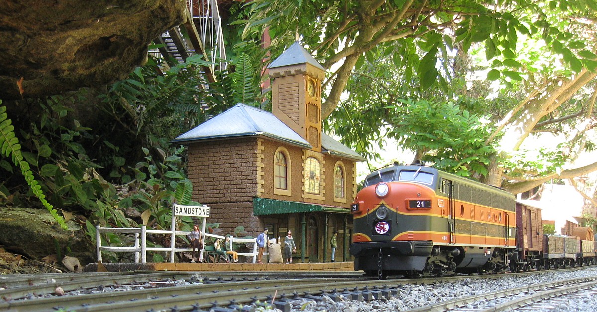

So imagine it is 1953 and the loco is newly delivered to the SaTR.
Arriving with a goods train at Sandstone.
