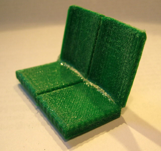

This may not look much but getting to grips with Sketchup and figuring out how to get curves on curves for the seat backs was a challenge in itself! I need to improve the mounting between the seat and the back, but basically I'm almost ready to go into production..... :sunny:
Also need to tweak the size slightly, but that's easily done.
Feeling quite chuffed!

Post by BorisSpencer » Mon Apr 20, 2020 4:48 pm
It looks like you've printed them pre-upholstered with some sort of velour.

Those are excellent Rik. Well done at such an early stage in the learning curve.

BorisSpencer wrote: Mon Apr 20, 2020 4:48 pm It looks like you've printed them pre-upholstered with some sort of velour.
I could say I planned it that way, but in reality it was pure happenstance.

philipy wrote: Mon Apr 20, 2020 5:36 pm Those are excellent Rik. Well done at such an early stage in the learning curve.
Took a fair bit of trial, error, watching YouTube videos and googling but they've turned out ok. I'd like to really get to grips with SketchUp. It looks like it can do some amazing stuff, but it's not always intuitive.

ge_rik wrote: Mon Apr 20, 2020 9:47 pm but it's not always intuitive.
No it isn't although I found that once I did actually find a specific technique it was kind of obvious. The one thing that I still CANNOT get to work consistently is rotating an object. I know how to do it but I can never select the correct plane, dunno why.
BTW in case you haven't found out about them yet, there are two plug-ins that you should get. One is the stl exporter and the other is the consistency checker which is called Solid Inspector 2.

philipy wrote: Mon Apr 20, 2020 9:56 pm No it isn't although I found that once I did actually find a specific technique it was kind of obvious. The one thing that I still CANNOT get to work consistently is rotating an object. I know how to do it but I can never select the correct plane, dunno why.
Hi Philip
Same here. I did actually manage to rotate the seat back from vertical to horizontal but Im not sure I could reliably repeat the process. Oddly enough, when I imported it into Cura it was vertical again - and I found it's easier to rotate it and lay it flat in Cura. A lesson learned.
I'll seek out those plug-ins. I exported the drawings as .obj and they imported OK into Cura. Not sure which format is the best at preserving detail.
