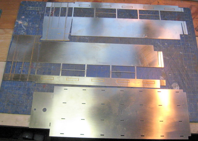

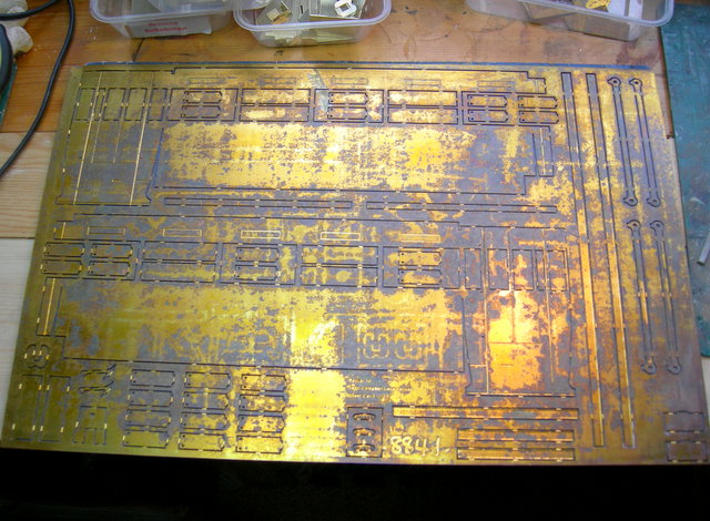

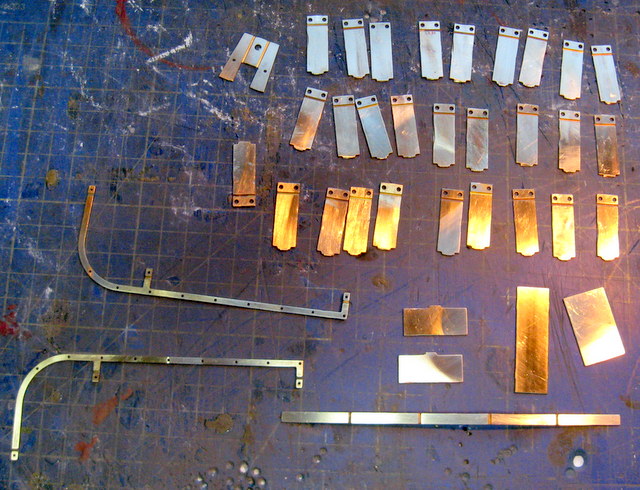

I've separated and cleaned the parts from the first fret, which comprises mostly parts for the cab. .
Thanks to some excellent help from Graeme (GTB) on the Coronavirus Project thread, I have now identified where all the parts fit. I looked online for a copy of the book your recommended, Graeme, but the cheapest I could find was £37.50, so I'll pass on that. In the meantime, I've tracked down one photo of No.10 in Tom Ferris's The Irish Narrow Gauge Vol 2 and three photos of Railcar No.14 (another Walker half-cab) in The Swilly and The Wee Donegal by Anthony Burgess in my collection of books. I've also got an Ian Beattie drawing of No.10 in her Clogher Valley guise. The drawing gives the main dimensions but doesn't show all the details such as the rivet strips around the engine compartment.
I am presently separating the parts from the second fret. This is mainly the sides and what I assume are the seat supports for the passenger compartment. Slow and painstaking work, but then I'm in no hurry ..... .
Progress so far......

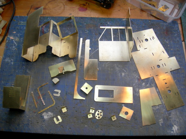

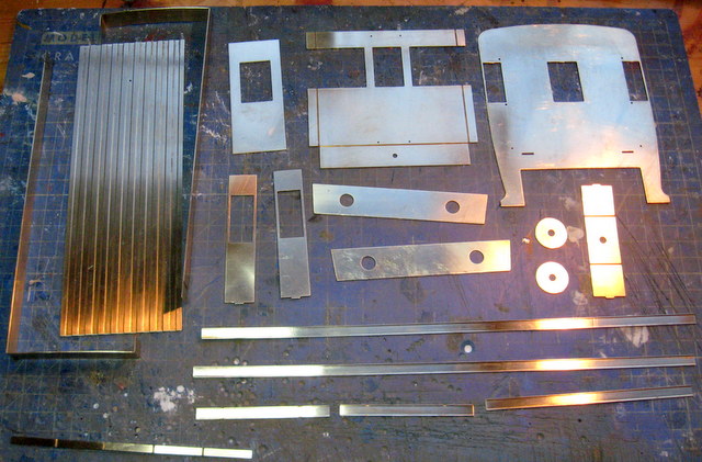

Latest update.
Now separated and cleaned up all the remaining bits. . . .
I've got most of them figured out, but there's still a few I can't decide what they are or where they go - mostly small, fiddly bits.
I've also realised that there are quite a few bits missing - which presumably would have been made of whitemetal or maybe resin castings. The radiator, the bogie sides, the interior of the cab I can make out of plasticard offcuts. The other bits, such as the curved roofs, the curved rear end of the passenger compartment and the 14 bus-type seats will be a bit more challenging. I might end up making a mould for the seats and casting them in resin.

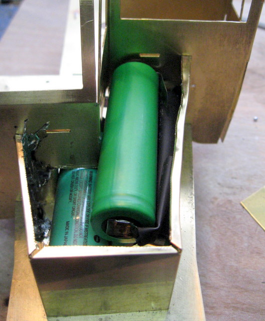

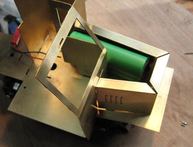

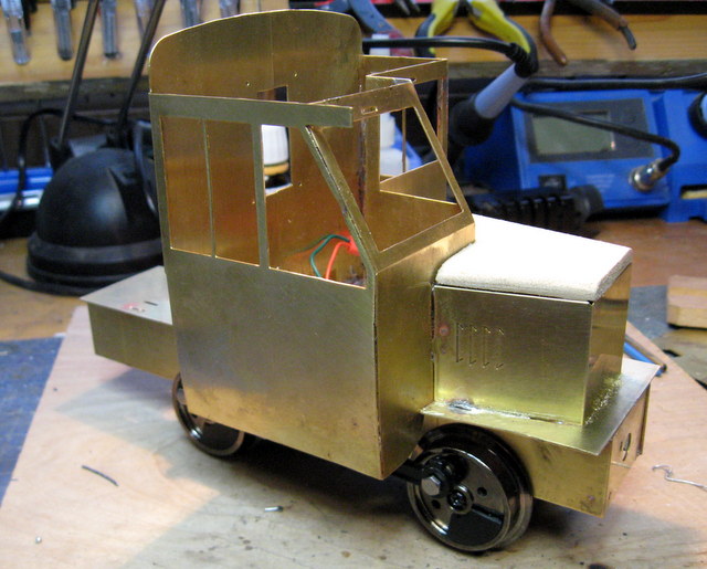

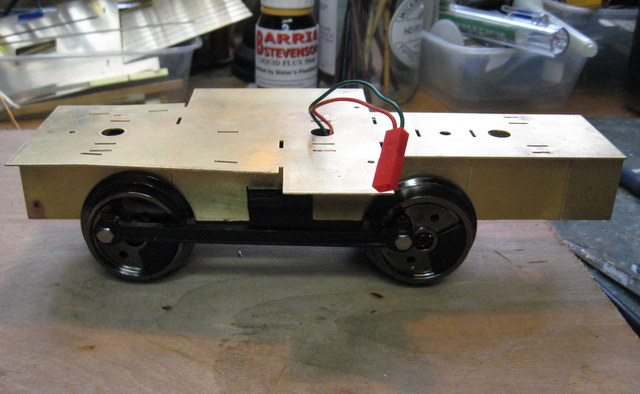

OK - A bit more progress today on this build...
I had to modify the chassis to make it fit over the motor block. It was also a non obtrusive way for me to develop my brass soldering skills, which are still very rudimentary. .
I took a while on the dry run of the cab body. I wanted to find a way of fitting three 18650 li-ion cells into it. Although there would be plenty of room in the passenger compartment, I felt the cab should be where the main electrics should be located. I could only fit two cells in the engine compartment but ..... .
..... after consulting plans and photos, I noticed there was an additional engine cover in the cab, which by happy coincidence was exactly the right size to accommodate the extra cell. A bit of hacking about was necessary but I can now squeeze three cells in. .
I needed to make an engine cover which wasn't part of the original kit, but I have the satisfaction that it is prototypical. .
It means I won't be able to model the railcar with the engine compartment open but I will need to construct another railcar to partner this one, so maybe that one will have an uncovered engine!.

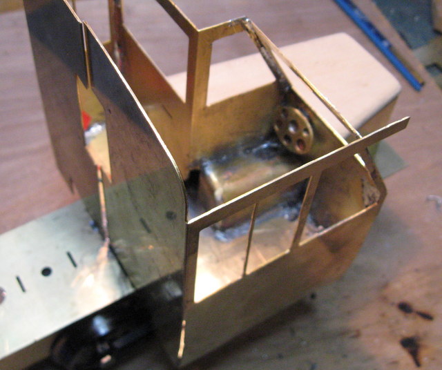

It's beginning to take shape. . .
It's very much a steep learning curve for me. One thing I have discovered is that melted solder runs downhill ...... so propping the model up to get the next seam angled the right way makes life a lot easier. I've also learned that it would be a lot easier if I had another hand - and that wearing a glove on the left hand does make life easier when things get a bit hot!
