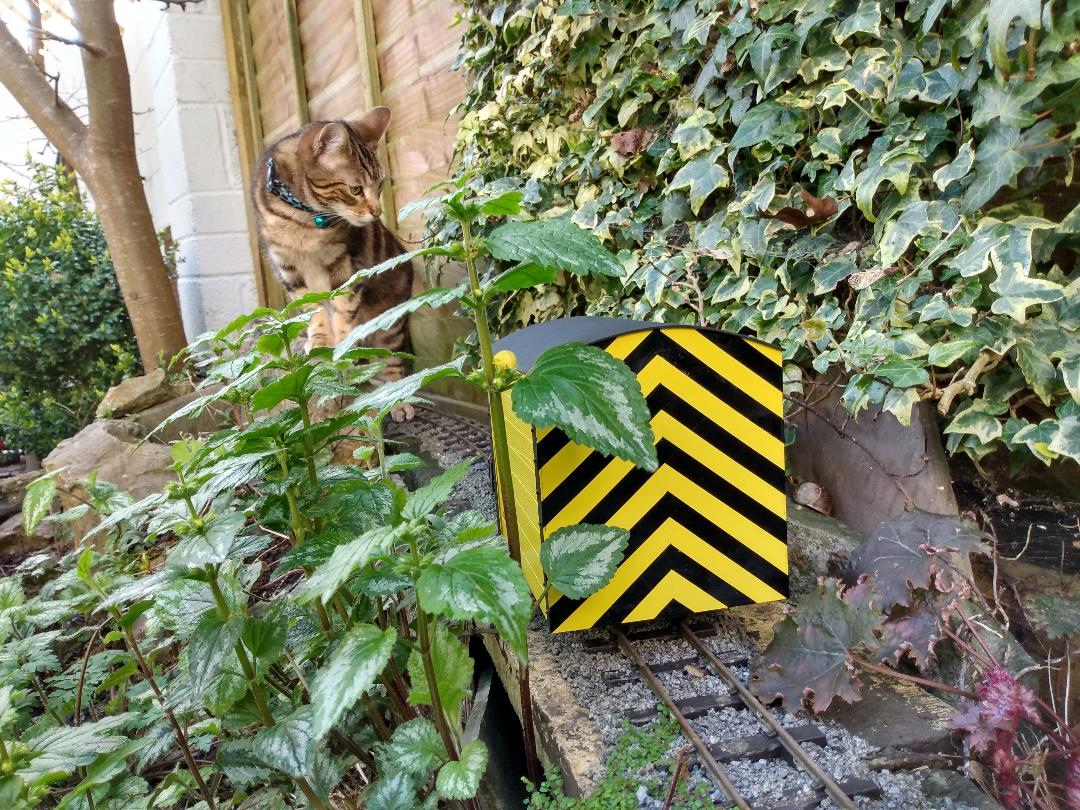

On the whole, I'm not a terribly fast worker. Work, family and other commitments mean that even a simple wagon build can take months to complete, or even longer.
Not this one! This curious beast took me less than a week start to finish:
- BBYV 1.jpg (214.15 KiB) Viewed 12717 times
That's not its best side, but even its best side is pretty ugly! It's built entirely from foam board on an old Faller chassis, and has a huge lump of wood inside for weight. As far as I recall, it's also the only thing I've ever sprayed yellow.

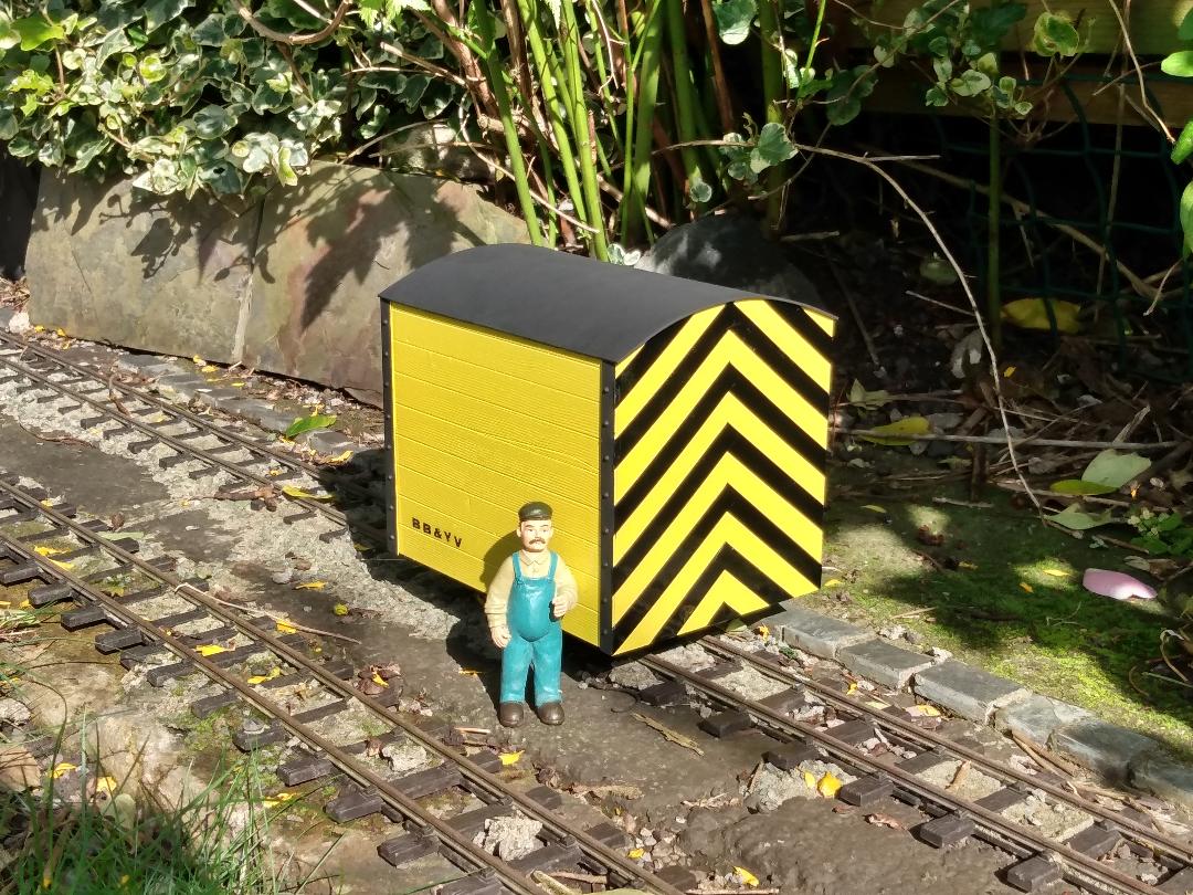

So what is it? It certainly doesn't look like anything that ran on the old Welsh Highland, or anywhere else come to that, it lacks detail, is much bigger than most of my other wagons, and with a coupling at only one end it won't be much use in a train...
Well... It's my answer to Network Rail's Structure Gauging Train. I like to have vegetation growing near to the tracks, but find it hard to judge how close is too close, resulting in derailments, damage, and carriages streaked with oil that locos have deposited on overhanging leaves. This wagon is designed to solve that - it's slightly bigger than my biggest loco, so before each run I'll simply attach it to a battery engine and push it slowly up the line, clipping anything that it comes into contact with. I just had a trial run, and it worked really well - those wasp stripes are actually quite useful in spotting leaves etc!

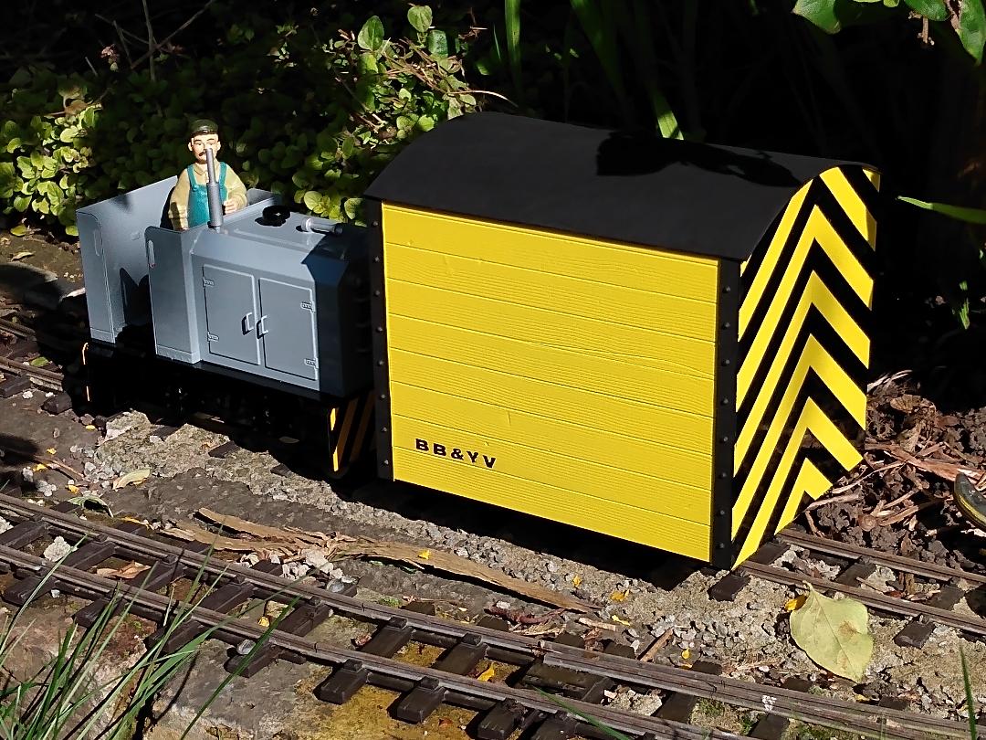

Here it is attached to my new battery loco:
- BBYV 2.jpg (210.13 KiB) Viewed 12717 times
And again, this time in action - ivy can be quite a hazard for trains, as can Ivy, next door's lovely but very inquisitive cat:
- BBYV 3.jpg (245.84 KiB) Viewed 12717 times
