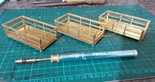

The three wagon bodies are now cut from the frets and i have now folded and put them together with their bases ready for soldering tomorrow. I have used some old wire to hold them together while i solder. The top rails are just resting in position on their tabs so i can remove them after soldering to ensure the top edges are perfectly flat before re positioning and joining them permenently.
In the front of the mat is the butane torch I use. Reading reviews, some folks don't get on with this model but it works fine for me providing I follow certain rules.
- fill with butane downwards for about 10 seconds.
- Allow to rest for a minute or so.
- On first lighting the flame is yellow and coarse and may pop itself out. This may happen a couple of times but does settle down and give the correct double blue pointed flame.
- I can then turn it off and on as required. I soldered the three underframes in one session on two fillings.
- I brush on La-Co flux to stop oxidation on the surface of the brass and it washes off easily afterwards. Being a resin flux it is non toxic (I read).
These torches, by the way, I buy online for £3.29 inc postage and they give a lovely small and controllable flame. I am on my second one in two years, as the 1st. developed a slight leak so I binned it. At that price it is affordable to always have a good one.

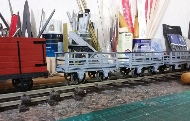

Firstly, I have now completed the Slaters slate wagon kits, an IP wooden slate wagon kit, and have scratch built a Ffestiniog 2 ton coal wagon. My next jobs are to R/C my PDF Baldwin and scratch build more wooden slate wagons.
Trying to couple and uncouple using the small hooks and loop couplings is so fiddly however with the wagons being so close together. I just don't seem to have enough hands (or patience). Looking through my bits collection I came across half a dozen pairs of Timpdon magnetic couplings that I bought at Stoneleigh about 8 or 9 years ago. So i replaced the hook and loops with these magnets and was amazed how powerful they are. Just push the wagons together and the magnets flip up and grip together. A sharp pull and they come apart. They hold my six wagons together perfectly, even with a gentle snatch start on purpose to test. Here is a close up of one pair.
Not being able to find any more on line I was wondering if anyone knew of a supplier or had any knocking about that they would be willing to sell. I would love to see how many wagons I could pull using them.

It was tested on my local model engineers outdoor track earlier today. The couplings are strong enough to stop the whole train if I hold back the last wagon. I am definitely going to get more to add to the three new wooden slate wagons that I have just cut the materials for. I wonder how many wagons I could pull in total before the train gets too heavy. The 1st truck is a scratchbuilt FR coal wagon in which i am going to house the batteries, receiver, sound card and speaker under a false coal load. The blue box in the second truck holds the batteries at present and a manual speed controller.
