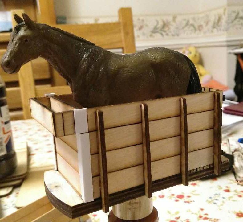

FR dandy waggon. Based on the replica built in the 1980's. The horse is being modified to have pegs in it's hooves.

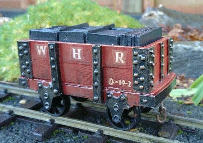

One of the two plank wagons has been finished. The grey twin is awaiting a slate load. Slates are made from card, cut and glued into blocks.

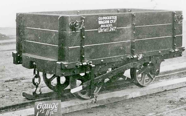

Those are looking very impressive - I think the 2 plank is the little one that appears in the Wheeler book? You've captured the shape better than I managed to I think... I love the Gloucester wagon too - the strapping's looking great, and the distinctive bufferbeam shape. One of those is fairly high on my list...

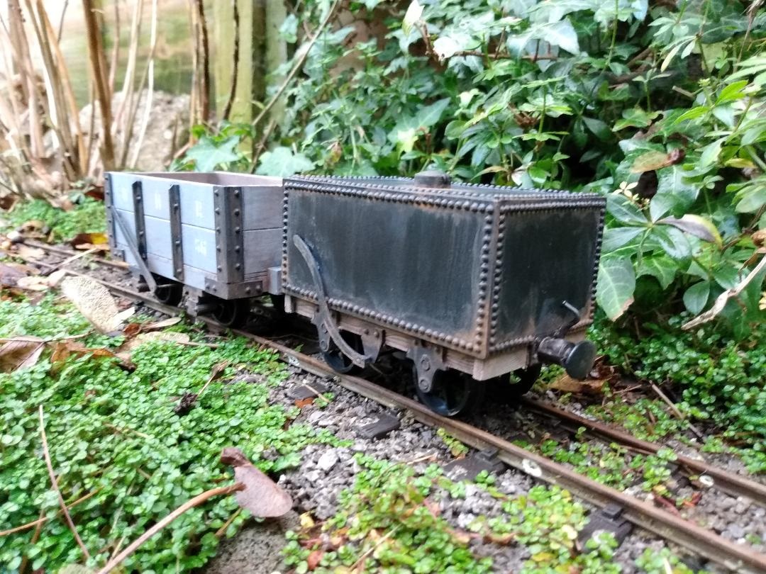

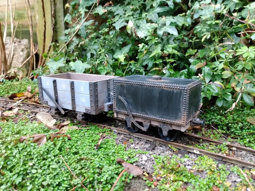

I've also been busy on the wagon front, out-shopping these two today - the Ffestiniog brine tank and the second small WHR open:
Jan wagons 3.jpg (225.34 KiB) Viewed 14738 times
Jan wagons 2.jpg (352.02 KiB) Viewed 14738 times
Jan wagons 1.jpg (293.14 KiB) Viewed 14738 times
I've been out tidying up the garden a little - these two might just get a test run tomorrow...

This all looks terrific. The weathering (and the rivets) are completely convincing. Seduced by all of it, I went and bought a load of Nail Art stuff, so I could plaster rivet heads over everything. But it’s a nightmare! I can’t imagine how you all manage to organise and glue the damn things into neat, equally spaced rows. I can’t even pick β€˜em up...

Glad you like 'em, thanks!
For the wagon strapping etc I make little jigs to get the gems in the right place - usually just holes drilled in offcuts of thin ply. I use a pen to mark the part (a fine permanent marker if I can find one), then apply plastic cement, then add the gem with the tip of a knife blade. The tank was more of a challenge (!) but I discovered that the gems can be placed in more-or-less the right places then pushed into a straight line with the edge of a ruler while the glue sets. If you can't use then in your modelling you'll just have to stick 'em to your nails as intended...

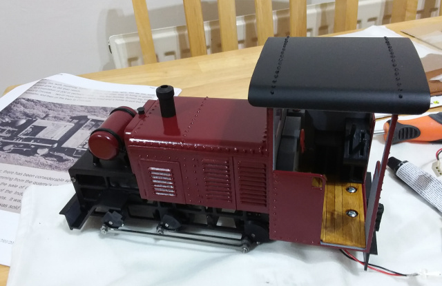

Hi all.
I am just finishing a PDF Baldwin tractor (gluing on the fuel tank and splashers today and adding glazing to the front windows) and thought I would add my rivitting method to this discussion.
First I draw a straight line for the rivit heads (Cambrian models), then draw a cross line every 5 mm along this line. After adding a small puddle of superglue into a plastic lid i dip the end of a cocktail stick into the glue and tap a little onto 2 or 3 of the cross lines. While the end of the cocktail stick is still damp with glue it will pick up a rivet and if i then touch it into place on the cross it will let go of the stick and adhere to the cross. If I work quickly I can do another 1 or 2 rivets before having to glue more crosses. I use a dry cocktail stick to move the rivets quickly if necessary.
There are about 300 rivets on my model and it took a few session to add them all. Yours look straighter than some of mine Andrew.

Makes up to a great looking model David, I admire the style of these Baldwins.

That looks about 420 rivets on that tank wagon Andrew. :-)
