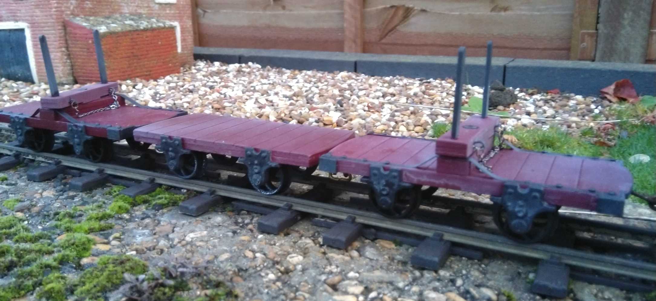

Individual planks are the way to go.
The laser cut kits don't look realistic with their perfect precision planking.
The weathering looks just right Andrew, great work.

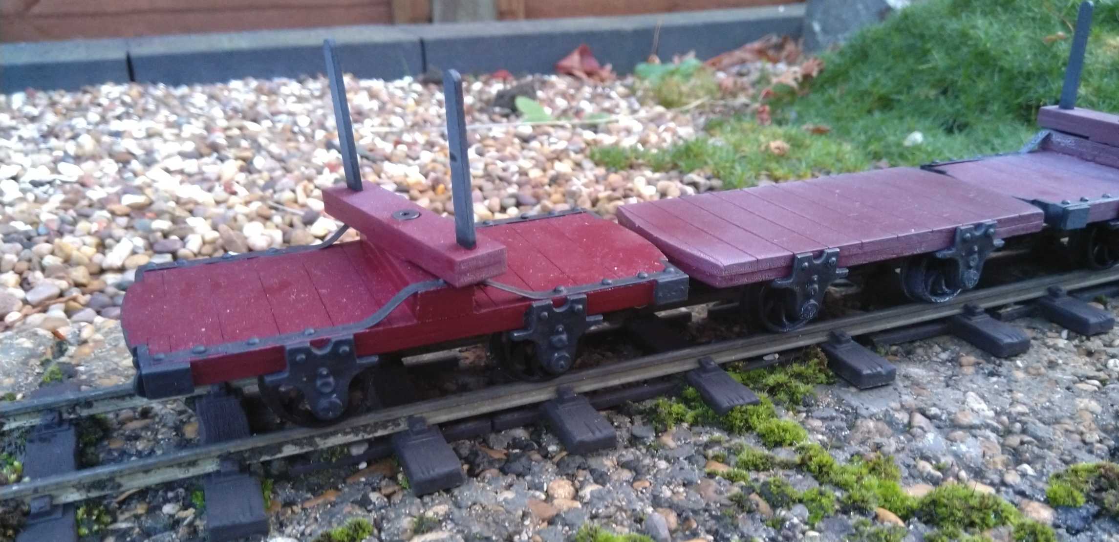

Glad you like the wagons chaps, thanks.
Good ideas re the planks Grant, I may try that next time, thank you. Attacking the paintwork with sandpaper to create a worn/faded/peeling look does highlight the different planks to an extent, but I don't want everything to look quite that knackered! With the open I'm currently working on I chamfered the edges of the planks a little more than I did last time, which may also accentuate the planks.
Rod, the corrugated roof on this one's plastic, from Bole Laser Craft - I think I used it after you'd found success with it on your garage build. I heated it a little to help it take the curve - I quite like the way it distorted a bit so that the edge isn't quite straight. These vans were essentially coal trucks with modified doors, and the addition of an extra plank and a roof, so should look a bit rough and ready! The strapping is home-made on these wagons - I had to do that so that it would look like the original. It's mostly knocked up from plastic strip and angle from the model shop, with nail art gems for rivets. I should make strapping for the inside of the wagons too really, but I don't have the patience. I was pleased with the van's iron hoops (for tying back the doors?) which are from slices of biro barrel, with a little piece of the pen's inner ink tube as the fastening.

Thanks Andrew for the information. I forgot all about the corrugated from Bole Laser Craft. You did a brilliant job on getting it bowed. It really does look realistic...

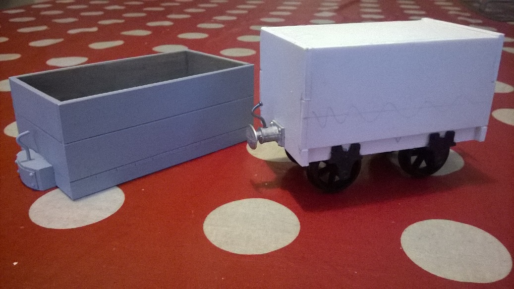

The small WHR open has now been assembled and painted - lettering will be next. The ironwork is mostly ready to go, I just need to assemble some axleguards. They've turned up now, but last weekend I'd misplaced the little roller bearings I needed, so I temporarily turned my attention to a new project, the Ffestiniog brine tank wagon. See the Ffestipedia page ( https://www.festipedia.org.uk/wiki/Brine_tank_waggon) for more information, but essentially it carried salt water from Porthmadog to to the Oakley family home at Plas Tan-y-Bwlch and later found itself sitting on a pile of sleepers as a water tower at Pont Croesor on the WHR.
My model features Binnie running gear and a foamboard shell - that's scribed for the wooden bits and will have plasticard cladding added to represent the tank. I think it should be a quirky and characterful addition to the fleet...

Interesting use materials for this build Andrew. It's look great already.

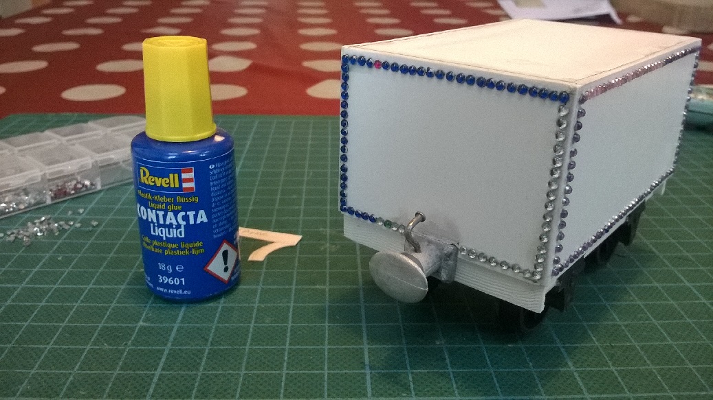

Thanks Rod! One of the reasons I'm doing this one now is to assess the suitability of the method for other projects, including my proposed Kerr Stuart diesel. The jury's still out - it works quite well, but foamboard seem to bring out my slapdash side, I had to use a fair bit of filler!FWLR wrote: Sun Nov 10, 2019 7:37 am Interesting use materials for this build Andrew. It's look great already.
Unfortunately for me, one of the main characteristics of the brine tank is the rivets all the way round the edge of each side. Here's the progress so far - it'll use up most of my nail gems... It'll be a shame to paint it really, it's going to look like something out of a circus train when it's done!

That's a GEM of a joke Tom, you really put your FINGER on it...
Sorry!
Actually, my wife's also got in on the act. With a completely straight face she asked me which railway the wagon ran on, so delighted at this unusual interest in the minutiae of my hobby I told her... "And was that during the Ffestiniog's Vegas era???" she replied - I'd just been adding silver gems around the white top of the wagon, and it is indeed strangely reminiscent of Elvis's jumpsuits during those latter years of his career.
It's more Rolling Stones really - I'm gonna Paint it Black...

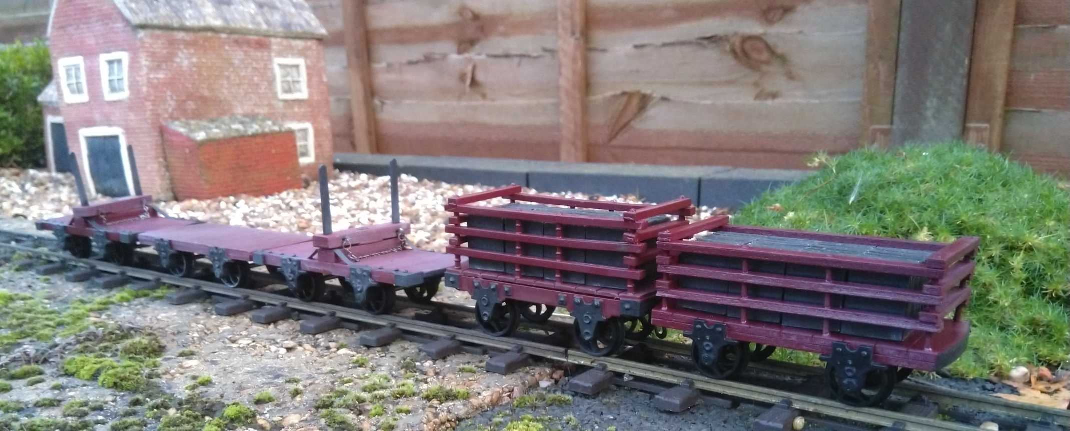

As requested. The two slate waggons are a Lineside Hut followed by a Binnie. These are representing the NWNGR first generation slate waggons (apparently "almost identical to the FR type"). The bolster set are modified from a Lineside Hut kit to represent the NWNGR bolster waggons.
All the Lineside Hut kits have white metal axle boxes instead of the MDF(!) ones. This does involve grinding at the floor of the waggon with a Dremel and sanding mop. They ride much better than with the MDF boxes. The brake van is also progressing, gaining most of the "fiddly" bits like handles.

Nice! I particularly like the bolster set - that's on my list too. MDF is an add choice for axleboxes, isn't it?! Lovely cheap kits, but less of a bargain when you've bought new axleboxes! I've got two Binnie slate wagons in their FR guise and another one awaiting construction which will represent the NWNGR variant - I'll probably add brakes, as per the one in the maker's works photo.

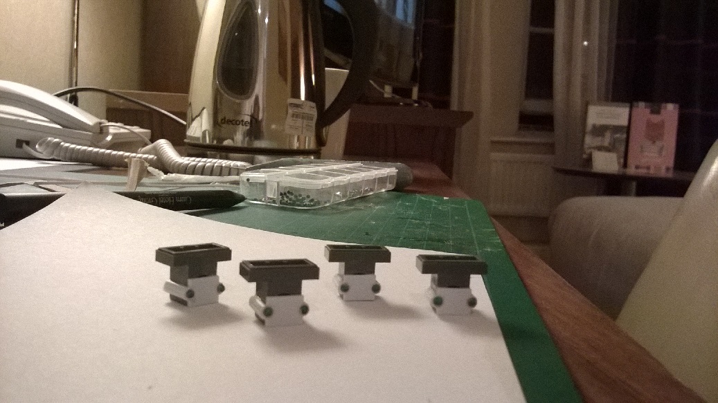

Also interesting to hear of you assembling the axle boxes in a hotel room, you have your priorities in the right order. Reminds me of sitting in the back of my four wheel drive on top of an embankment overlooking the main North East line and assembling HO railway kits as the trains pass by.
