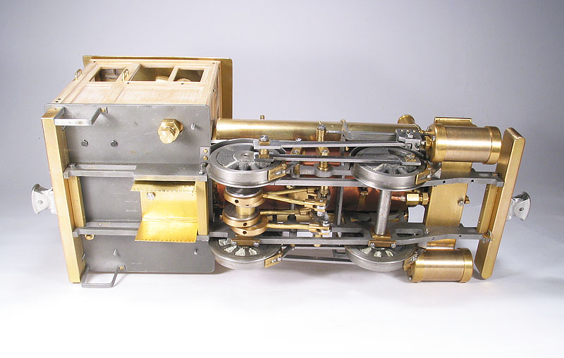

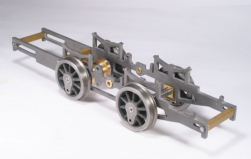

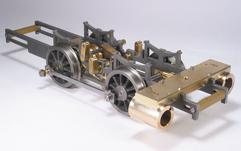

The frames were fretted out from 3mm hot rolled steel sheet (black iron) using a piercing saw and a paper template stuck to the steel sheet. After a bit of cleaning up with needle files, the frames were abrasive blasted. Blasting worked much better to remove the surface scale than previous efforts with files and sanding blocks. The result looks more like a casting in some ways and the surface is more corrosion resistant than previous frames descaled by other methods.

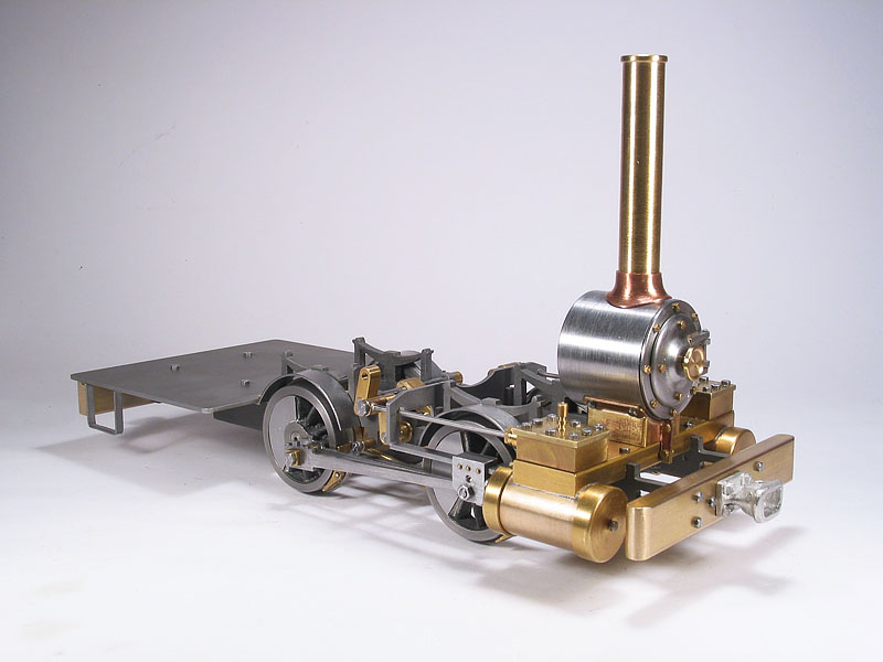

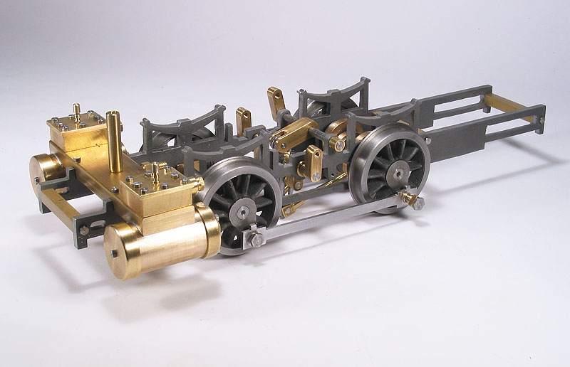

Next up were the cylinders, fabricated from gunmetal and brass. The fun part with this design is drilling the steam passages in the stretcher, which involves drilling a 1/16" and a 3/32" hole from each side and hoping they meet in the middle. (They did..... :shock:) The next photo shows the cylinder 'casting' and the inside Stephenson valve gear fabricated and installed as far as the rockers that transfer the movement from the inside valve gear through to the outside valves.
The next photo shows the cylinders and valve chests completed and the coupling rods fitted. This was the first loco built after I fitted a DRO to the vertical mill and the rods went together with little adjustment needed to get it running smoothly.
This photo shows the con rods and valve rods connected, as well as various detail bits. Still some detail bits to fit, but it is now ready for setting up the valve gear and test running on air.
It lives....... ;) This photo shows the loco chassis running on air on the test stand, ticking over on less than 10psi supplied by my old airbrush compressor.

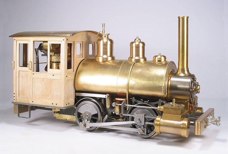

Next jobs were to fabricate the smokebox, smokebox saddle, cab floor and headstocks. Making the smokebox door so it can be opened takes a bit of effort, but well worth it, as it makes lighting the burner much easier.

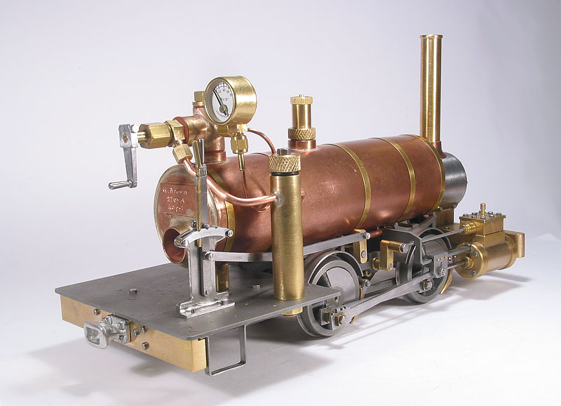

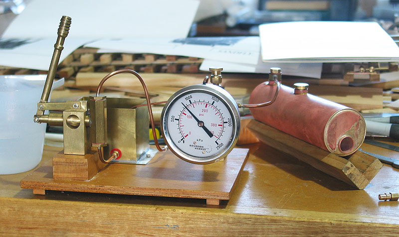

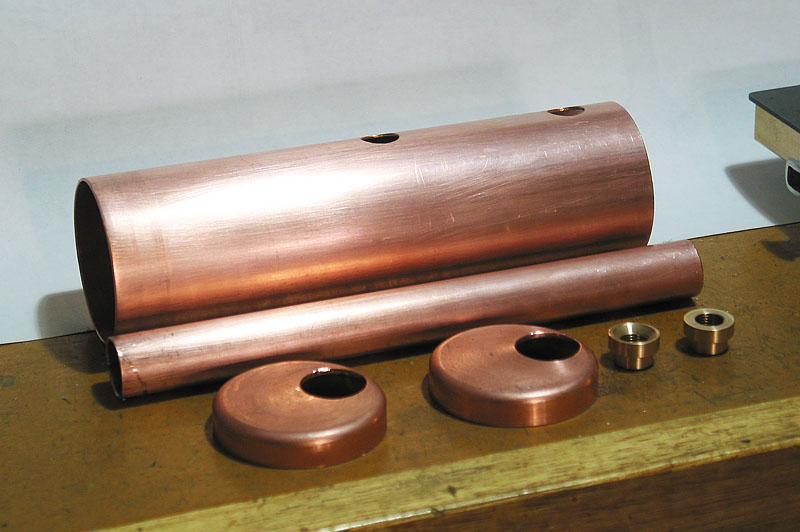

Boiler construction was next and this one was simple. The cab of the model is very cramped, so a gauge class wasn't fitted. Just a bush for the safety valve and another for the throttle and steam manifold. The first photo shows the parts ready for brazing and the second shows the completed boiler holding test pressure. Being a simple design it was brazed in one session.
These little Baldwins were very small locomotives and a scale diameter boiler would be 35mm dia. and 135mm long. Far too small to get a decent length run, so a larger boiler was crammed in. It turned out that a 1.75" dia by 150mm long boiler would just fit under the saddle tank and fit into the cab. Fitted with a 3/8" flue and a burner with a 0.15mm jet, this will carry enough water for a 20 min. run.
The next photo shows the boiler fitted to the frames, with a mounting bracket on the smokebox and a sliding block on the cab floor.

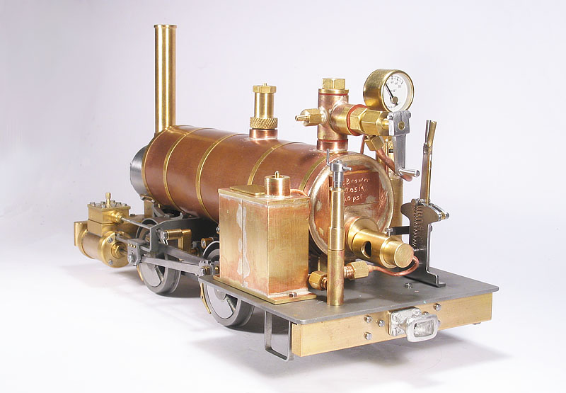

The next jobs were to fit the reverser, lubricator, regulator and safety valve, shown in the next photo.
The last parts needed to make it a working steam loco are the gas tank, gas valve and burner and these are shown fitted in the next photo. Using square tube to fabricate the gas tank allowed it to be fitted below window level in the cab and carry enough gas to run out just before the water does.
........ and there it sat for a few weeks while I fought the Walker railcar into submission. I finally got back to the Baldwin and fabricated the cab out of birch ply, then made up the saddle tank and the boiler fittings in brass.
Baldwin domes and sandboxes of this period are much easier to make than those on a british loco, basically just flycut the base so it sits nicely on the saddle tank, then turn the body curves. No flared bases to make....... ;)
The saddle tank was riveted in the usual way with the punch tool I use, then rolled to the correct profile and the front soldered in place. The next photos show the more or less completed model ready for the paintshop (when the weather improved). Note, the gap between the saddle tank and cab front is deliberate, Baldwin left a gap there on the real ones.
This photo shows the valve gear fitted to this model. The Stephenson gear is a Gordon Watson design and fully working.

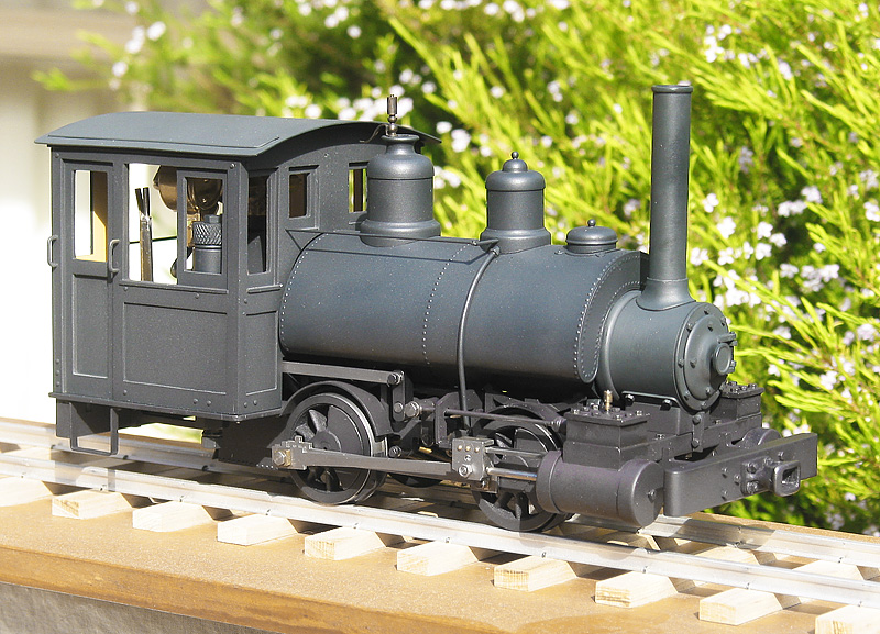

Finally, I ran out of excuses and the model was dismantled for it's trip through the paint shop and the usual colour scheme of four shades of black. This photo shows all the parts painted and laid out on the bench ready for assembly. Now if this was an Aster kit, it would have arrived looking like this....... Not as much fun to put together though........
Fully assembled, the valves set and now ready to be run in on the bench before it does line trials. Before that happens it is shown sitting in late afternoon sunshine while it's portrait is taken. Unfortunately I forgot to include the usual figure in the cab to provide some scale. The real Baldwin 4-10 1/2C class locos were very small, about the same size as a quarry Hunslet, or a 7" Bagnall. The cab looks large, but the firebox extends well into the cab and I've never seen a photo of a driver standing upright in the cab on the prototype locos.
The weather is steadily improving here, so I should be able to photograph it in service soon once it is run in.

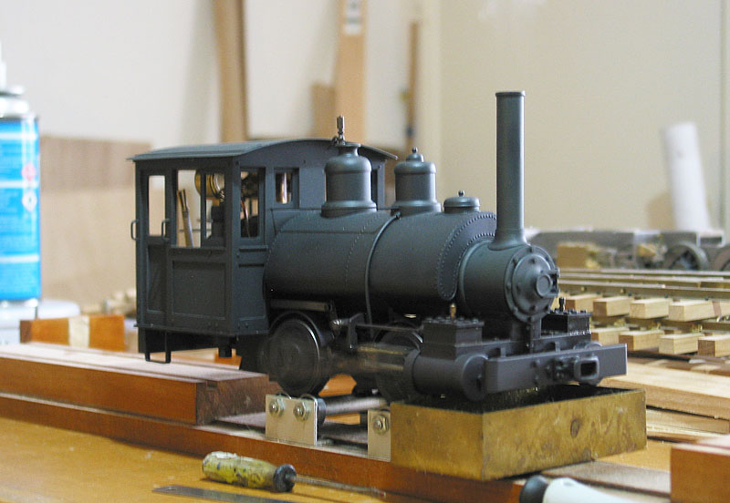

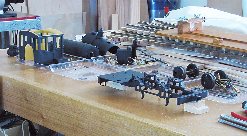

I've started running the Baldwin in on the bench and the photo shows it on the rolling road while it was steamed for the first time a couple of days ago. The workshop isn't well lit, so the photo is a bit dark and grainy.
It ran, but had some problems to be sorted out. The throttle wasn't closing fully and it ran better in reverse than forward. The exhaust arrangements worked well though, with a nice steam plume and only a few small spots of oil on the saddle tank at the end of the run.
The throttle has been modified and the valves reset, so if todays run goes better, it will be run in over the weekend. My usual procedure is to use a full can of gas on the the bench, before moving on to track testing.

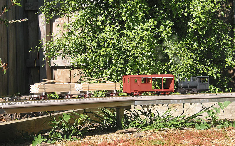

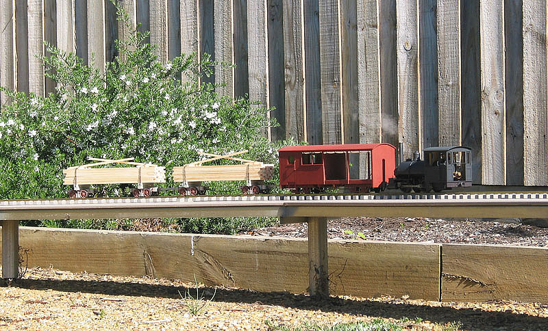

Between recalcitrant burners and lousy weather, the bench testing took longer than anticipated, but the new Baldwin finally ran it's track trials this afternoon. It was a nice warm day, no wind and not a cloud in the sky, good for boiling some water.

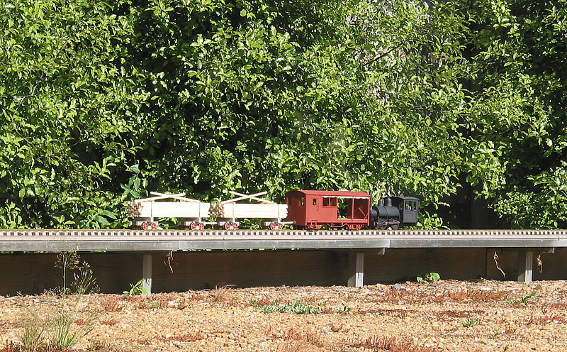

The first photo shows the loco setting off with a short train for a run south on the timber tram. Probably a heavier load than the original loco. would have handled on the Loch Valley Tramway. The only published photos of the Loch Valley operating show the Baldwins with only a couple of 4 wheeled flats. The fairly basic passenger vehicle in the train is based on the smaller of the two vans that ran on the Mapleton Tramway in Queensland. The timber pairs with bell brakes are typical of those that ran on timber trams in Victoria.
Twelfth Steam Run 1.jpg (262.08 KiB) Viewed 20226 times
It's easy to tell it's spring here, the weeds are going crazy. Even worse than the grass and dandelions, there are blackberries sprouting all over the place. Time to send out the weed spraying crew again.......
The next photo shows the train trundling south on the long straight in the afternoon sun.
Twelfth Steam Run 2.jpg (290.27 KiB) Viewed 20226 times
The last photo shows the train rounding the curve at the southern end of the track. It was a warm day, but the loco was leaving a visible steam plume while running. The camera battery died at that point, so no more photos........
Twelfth Steam Run 3.jpg (223.56 KiB) Viewed 20226 times
The loco managed eight trips around the track at a steady 24 scale mph. The train is well within it's capability, so it wasn't slowing noticeably on the curves or the slight grades near the bridge. I still need to do some work on the burner though, as it is noisier than I would like and although it lights easily, it is a bit unstable when running.
