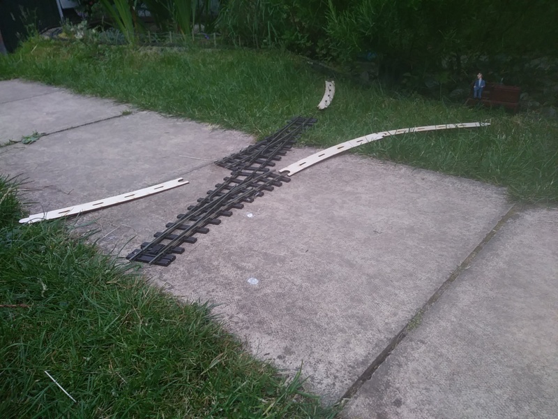

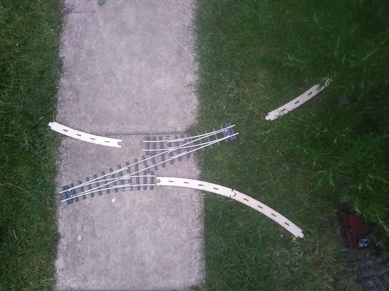

So, the extension is partly planned and the first challenge will hopefully be clear from these photos...
The existing line might just be visible to the right of the photos.
The new section needs to cross a path which is in regular use for accessing the main part of the garden, including dragging the lawnmower and full garden waste wheelie bin (and children's ride-on toys) over the crossing point. I reckon the chances of permanent track standing up to that punishment are slim. Also, it's a narrow point so I don't want the railway to make it too much narrower.
As the photos show, I also want two sets of points on the removable section, which also needs to account for diverging tracks (basically two continuous curves with a junction route between them) and a length of perhaps three feet or more - sorry, not currently there to measure!
I've had two thoughts so far:
1. Remove the affected path slabs and replace with concrete with a channel in it. Fix the removable track to a wooden board which fits in the channel. Cut a heavier-duty wooden board to fill the channel when trains are not running.
2. Slightly lower the slabs. Construct a low-profile "bridge" from Dexion* or similar, with slotted angle for the sides and flat metal transverse pieces linking them and supporting the track. Probably insert or fix rubber or wood packing under the "bridge" so the slab supports it.
Are there other options I haven't considered? Any tips on practicalities, including fixing the removable section quickly in the right place to line up the rails correctly each time?
Many thanks for any advice!

As I see it you couldn't have points in a worse position than that! The chances of having a successful removable section with all those connections to be made every time are slim to non-existent. I know you are restricted by your situation and need to find a way around it so my first thought would be to leave the track in place and alter the path in such a way the slabs are raised just above the level of the rails and have a removable section of path instead of removing the track.
I think this could satisfy the domestic needs as well as maintaining your sanity.

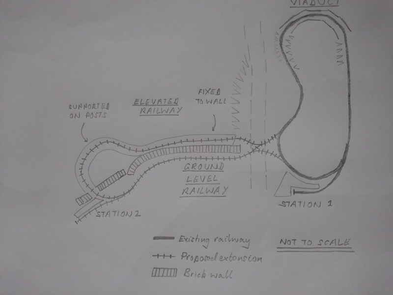

I went for the low-tech approach! Hopefully you can see that including the points in that awkward position:tom_tom_go wrote: Thu Jul 11, 2019 5:57 pm Do you have a track plan because all I see is a crossing that doesn't require points?
1. Creates a reversing triangle.
2. Enables trains to change direction round the circuit from anti-clockwise to clockwise (although not in the opposite direction) without stopping or reversing.
3. Provides an end-to-end run between the bay platforms of the two stations.
4. Provides an out-and-back run from the bay platform of Station 1.
5. Provides an out-and-back run from the bay platform of Station 2.
That's why I'm quite keen on having them there!

I've looked again at your sketch plan and without an accurate drawing its difficult to be sure if it would work, but how about this for an idea?:
Could you move the top (RH) turnout to the right and the bottom (LH) T/o to the left, straighten both sections of track and join them by a short length of diagonal track. You would then have three lengths of plain track crossing the path which could be permanently fixed in some way similar to mine (above).

I think the approach above described by Philip is the best yet if you can live with moving the points. Least obstrusive and least maintenance.
Re: Suggestions please: removable ground-level section
I also agree with Phillips suggestion. It would give you a lot more and you don't really need to be lifting anything...

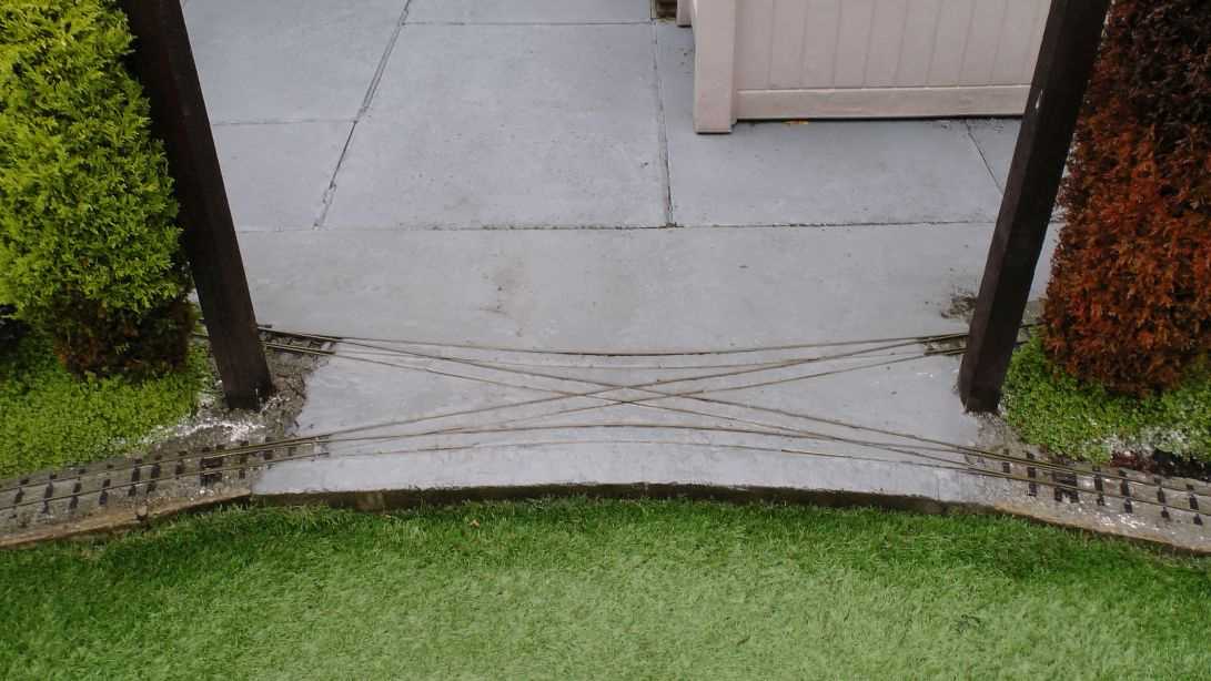

Here's my contribution.
I'm not telling anyone how to do it, but what I did and what works for me:-
[attachment=0]MR190712-001.jpg[/attachment]
The patio step is the main access for washing line (crucial!) and steam-up meetings etc.

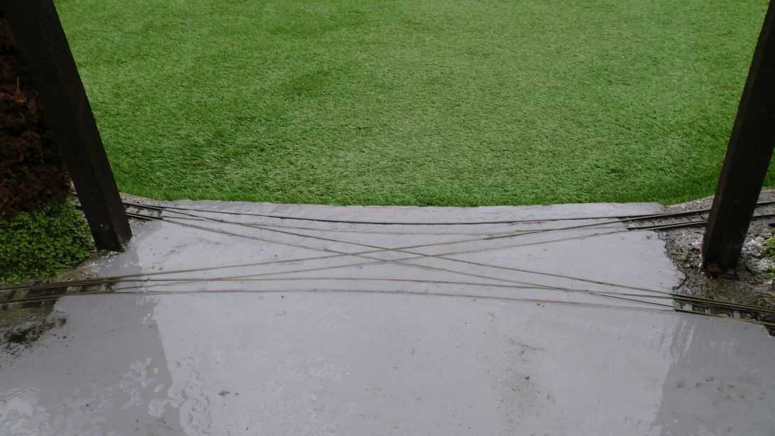

[attachment=1]MR190712-002.jpg[/attachment]
Yes, it was raining this morning!
[attachment=2]MR190712-003.jpg[/attachment]
The astro turf shows there is no need to drag a mower over the track, but the wheelie bin makes the crossing for veggie bashing.
After 4 years, it's standing up well.
Best to move the points apart so the moving bits are clear of the concrete.
The fine detail around the frogs etc is "enhanced" with Isopon filler.
