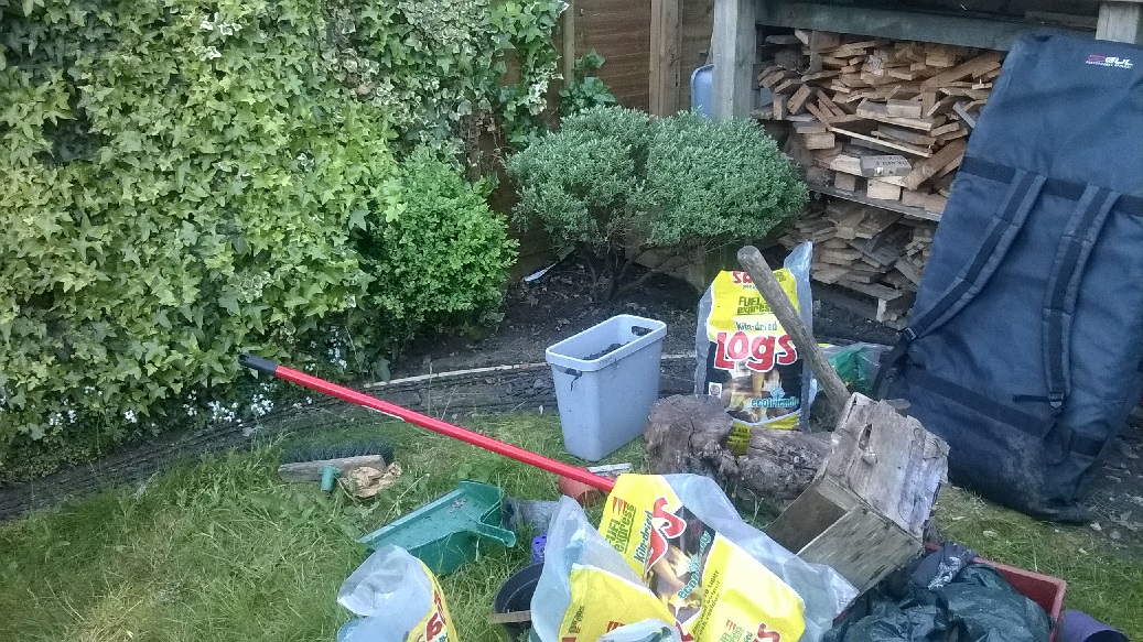

I do love this time of year, when you can just pop out for an hour or so in the evening and move a project on a little - which is what I did last night.
Because we no longer have a shed, the corner of the garden I'm currently working on will always have to be used to store a certain amount of stuff, but last night I added a sort of retaining wall from scrap timber, which will both contain the junk and help define the bit that's "railway". There was still a little time left to start work on the siding too, so I started digging the trench that will be filled with old bricks and Postcrete to form the trackbed.
Here's the whole corner, complete with junk, which will either be stored, used (in the case of the bags of slate chippings) or disposed of:

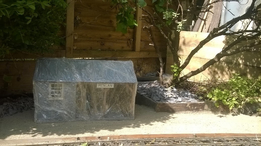

This morning's task was to add the platform. I'd prepared the ground a little earlier in the week, painting the wooden edging with preservative and walling in the hebe at the back of the platform with scraps of slate, so this morning was about spreading the Postcrete that forms the surface, representing the old WHR's simple earth/gravel platforms.
Here it is awaiting a spray with the hose, with the station building wrapped in clingfilm for protection and then nestled into the cement in an attempt to avoid there being a gap:

You can't see it in the picture, but behind the station the new siding is ballasted and covered in plastic sheet while the SBR dries. Typically for me, I lost the turkey baster I purchased for SBR application before I'd even used it, so it was back to my old syringe, but with the flow controlled by my finger rather than the plunger. Probably not strictly in line with the H&S guidelines on the container, but I seem to have survived unscathed...
Family duties permitting I might be able to get the rest of the ballasting done this weekend, paving the way for running some trains on the next one. We shall see...

Andrew wrote: Sat Jun 01, 2019 10:58 am the new siding is ballasted and covered in plastic sheet while the SBR dries.
If your weather is anything like ours ( 26-27deg forecast today) then I'd uncover it pdq and let the warmth dry and set it. I've found that once it has a firmish skin a small amount of rain doesn't harm it even if it's still soft underneath the top layer. It goes white when wet but that goes again as soon as it starts to dry and each time it happens it gets a bit less.
Post by Andrew » Sat Jun 01, 2019 4:09 pm
Good advice Philip, thanks!
I needed to cover it earlier while I watered in the Postcrete platform (actually, I think that may have been an idea I pinched from you!) but it's now drying beautifully in the afternoon sunshine...
