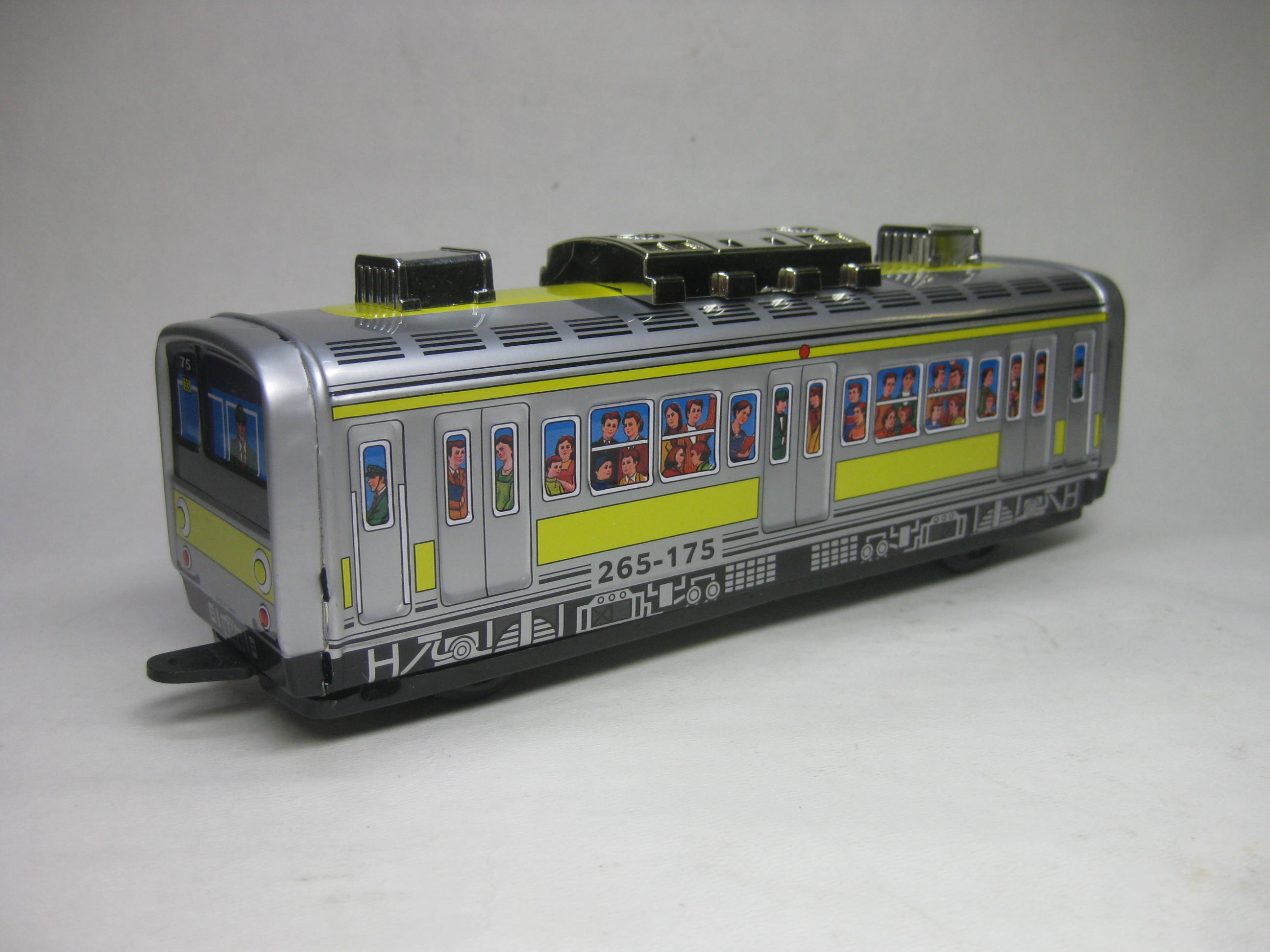

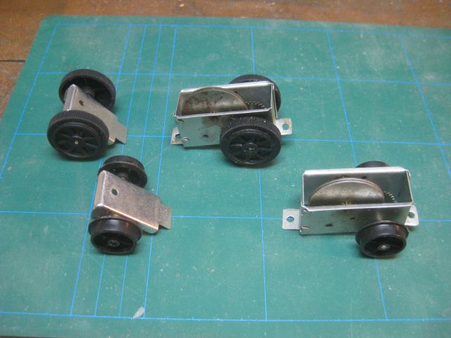

I have recently finished putting an electric motor in a Chinese made tin plate model of a Metro car. The friction motor taken out of it has been on my bench for several days now; I have previously modified a toys friction motor to make a SloMo wagon. Looking at this example it looked as if it would be easy to modify and it is! Just pull the plastic wheels off and Binnie wheels are a good fit on the axles it even has mounting brackets! The model cost £7 including P&P direct from China.
The model as bought.
001 IMG_3643.JPG (350.79 KiB) Viewed 4029 times
The friction motor.
IMG_7481 LR.jpg (51.67 KiB) Viewed 4029 times
Binnie wheels fitted.
IMG_7483 LR.jpg (46.49 KiB) Viewed 4029 times
The other wheel and axle bracket could also be used.
IMG_7484 LR.jpg (48.95 KiB) Viewed 4029 times

That's very similar to the device I used in my Slomo wagon before installing the SSP Slomos:
