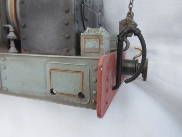

Since my last post I have been busy fitting brake gear to all of the four wheel wagons, all done now. Having done that another missing item stands out, and that is vacuum hose connection. Some of my stock has them fitted when I was fortunate enough to pick them up used or as a job-lot. (they aren't cheap and I need lots of them!). I have also made some in the past and am pleased with their appearance.... it's all about distance.
The way I made them is by using brazing rod, carefully bent to shape then made up with heat-shrink and plastic tube.......
After fitting the plastic tube the brazing rod can be bent at right angles to be fitted either through, or under, the wagon ends....
The separate pieces are bonded together with super glue before painting.
This is my output for this afternoon.....
Painting tomorrow and fitting as soon as they dry.
Post by tom_tom_go » Sun Jan 13, 2019 8:56 pm
Nice work Peter!
That design is a much cheaper way of fitting out stock with vacuum hoses than buying white metal offerings...

Post by ge_rik » Mon Jan 14, 2019 8:20 am
Great solution. I like the inspirational use of the brazing rod.

Post by FWLR » Mon Jan 14, 2019 9:10 am
Impressive Peter. I like the way you have thought out and used the materials and like Tom says, it must be a lot cheaper to make your own and may I add, better looking........

Post by Peter Butler » Mon Jan 14, 2019 4:31 pm
First few fitted today and I'm pleased with them..... lots more to follow.....

Brilliant solution. I fit vacuum pipes to all my locomotives and passenger stock. Until the 1970s even British Rail ran unfitted wagons. They only had a hand brake. A small point for anyone making them, the hoses should be fastened to the stand when not connected up. If they aren't then no vacuum can be created and the brakes would be "on".

Peter Butler wrote: Sun Jan 13, 2019 8:43 pm I am pleased with their appearance.... it's all about distance.
IanC wrote: Tue Jan 15, 2019 9:49 am Brilliant solution. I fit vacuum pipes to all my locomotives and passenger stock....... A small point for anyone making them, the hoses should be fastened to the stand when not connected up. If they aren't then no vacuum can be created and the brakes would be "on".
Hi Ian, I'm pleased you approve in general even though you have pointed out where I have gone wrong! As you can see from my opening paragraph, I think that including them, even if they are imperfect, is better than not having them at all, as they will not be seen close-up.
In all of my models I aim for an overall impression rather than perfect scale. Most other stock I have seen have fewer details included, either from manufacture or additions, but as long as they satisfy their owners that's fine.

I very much approve of them Peter, and it's a minor point really. I approve of them so much, I intend to copy them, if that's ok?
