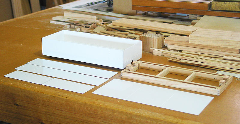

The first photo shows the two steel dropside trucks in the course of assembly. One with the basic body fitted to the underframe and the parts of the second laid out. I learnt from the steel bogie trucks built previously and this time the sides are one piece and overlap the underframe, as the previous models don't do this and there is a built in weakness where the sides meet the underframe.

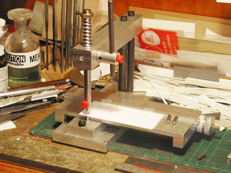

The next photos show how the rivets were added to the polystyrene sides and ends using a modified NWSL rivet press. The press has been modified so both horizontal and vertical runs can be made on large scale parts. The first shows a horizontal row of rivets being punched into a wagon end.
The second photo shows a vertical row being punched into a wagon side.

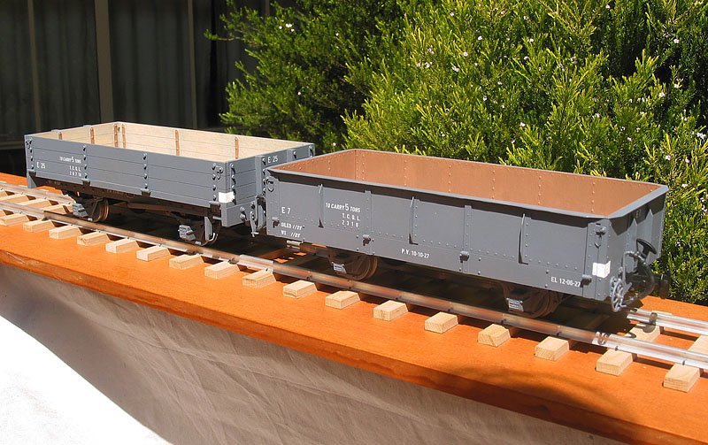

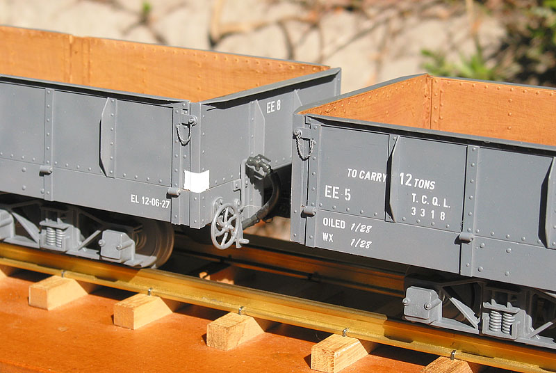

The third photo is a closeup of the bogie steel open trucks built a while ago to show how the rivets turn out when painted.

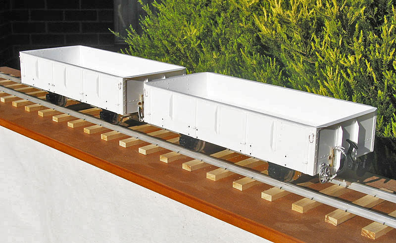

The next photo demonstrates how difficult it is to take a photo of an unpainted model made from white polystyrene sheet. Not helped by the weather at the time, which was grey and miserable with low light levels and little contrast.

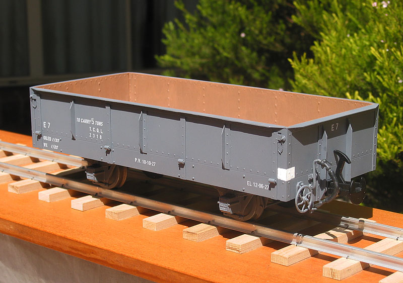

Much easier to see the detail when the photo is taken on a sunny day and the model has been painted and lettered.

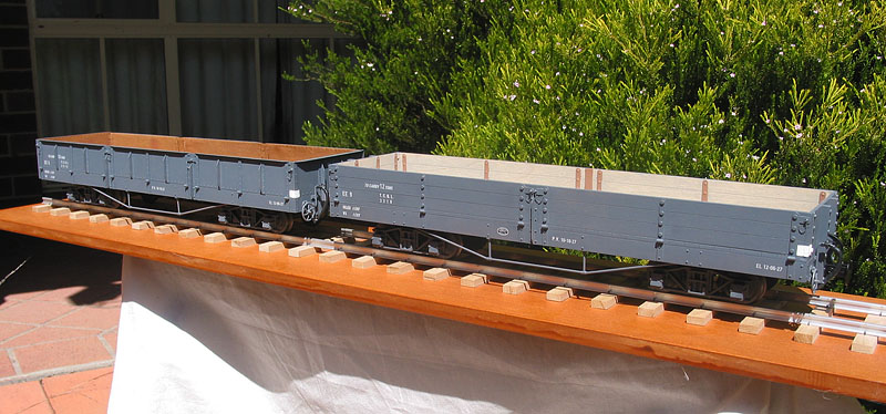

The final photo shows one of the steel dropside trucks with an older model of the wooden version for comparison.

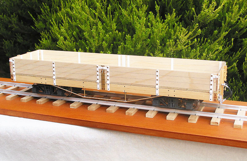

The other three models built were bogie wooden dropside trucks. No particular prototype, but they are the same construction as the wooden 4 wheel open trucks and similar to ones used on other Australian ng railways.

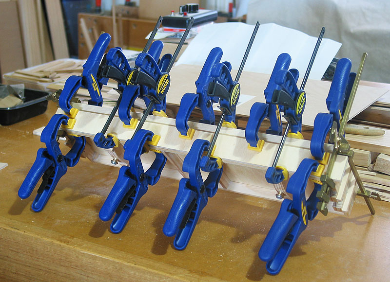

The first photo shows one with the bodywork parts being assembled onto the chassis. I use aliphatic PVA glue for wood (Titebond brand usually) and you can't use too many clamps when glueing up wooden models.
The next photo shows a model assembled and detailed. The stanchion between the two drop doors was fabricated in brass and riveted to the underframe to strengthen the sides. There is a joint between the doors and the underframe and also the doors had to be cut in two parts and joined.

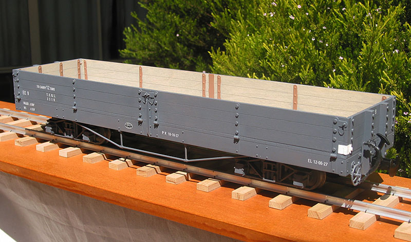

The last photo shows one of the new wooden open trucks with one of the previously built steel open trucks for comparison.

Construction is by my usual methods, wooden underframe with ply and polystyrene bodywork on the wooden prototypes and wooden underframe with polystyrene bodywork on the steel prototypes. The wagons are freelance, but based on Australian practice and with a family appearance to other models of TVT open trucks.

You may not be alone in that, so..........tom_tom_go wrote: Mon Oct 29, 2018 9:15 am Am I the only one who has realised from this post that you can stamp Plastikard to mimic rivets rather than adding them separately?!
Adding individual rivets isn't my idea of a good time, so I bought the NWSL rivetter 30+ yrs ago for scratchbuilding in HO, then made larger punches and modified the press when I moved up in scale. You don't need anything that complex though.
There's a couple of posts on here somewhere with a sketch and photo of the simple rig Grant built to use with his bench drill for punching rivets, which includes details of how the punch and die are made.
The tool design that both Grant and I use stretch forms the rivet head. The size of the hole in the die sets the dia. and the pip on the punch determines the height. I've found with polystyrene you need a separate punch for each thickness of polystyrene sheet. The thicker the sheet, the higher the pip needs to be to extrude enough plastic into the die to form the right shape rivet head.
The basic body parts of the steel open trucks shown in this thread are made from 0.040" sheet, door hinges are 0.030" and the rest of the rivetted strips are made from 0.020", so I needed three punches and one die. It's close to impossible to punch rivets into a narrow strip, so things like hinges and angles are riveted by putting several rows of rivets in a piece of sheet, then cutting out strips of the required width. If there is a need for punching rivets in thicker sheet than 0.040" (1mm) then it is probably better to punch them in thinner sheet and laminate to get the desired thickness.
As Philip said, polystyrene sheet can become brittle with age, especially if it is exposed to light. The white polystyrene I get here doesn't have much UV stabiliser in it, so starts to go yellow and brittle in a year or two if left exposed to light. I keep my large sheets sandwiched between sheets of ply in a dark part of the workshop and they are still flexible, although it's been over 5 yrs since I bought them.
