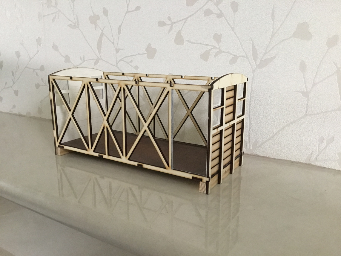

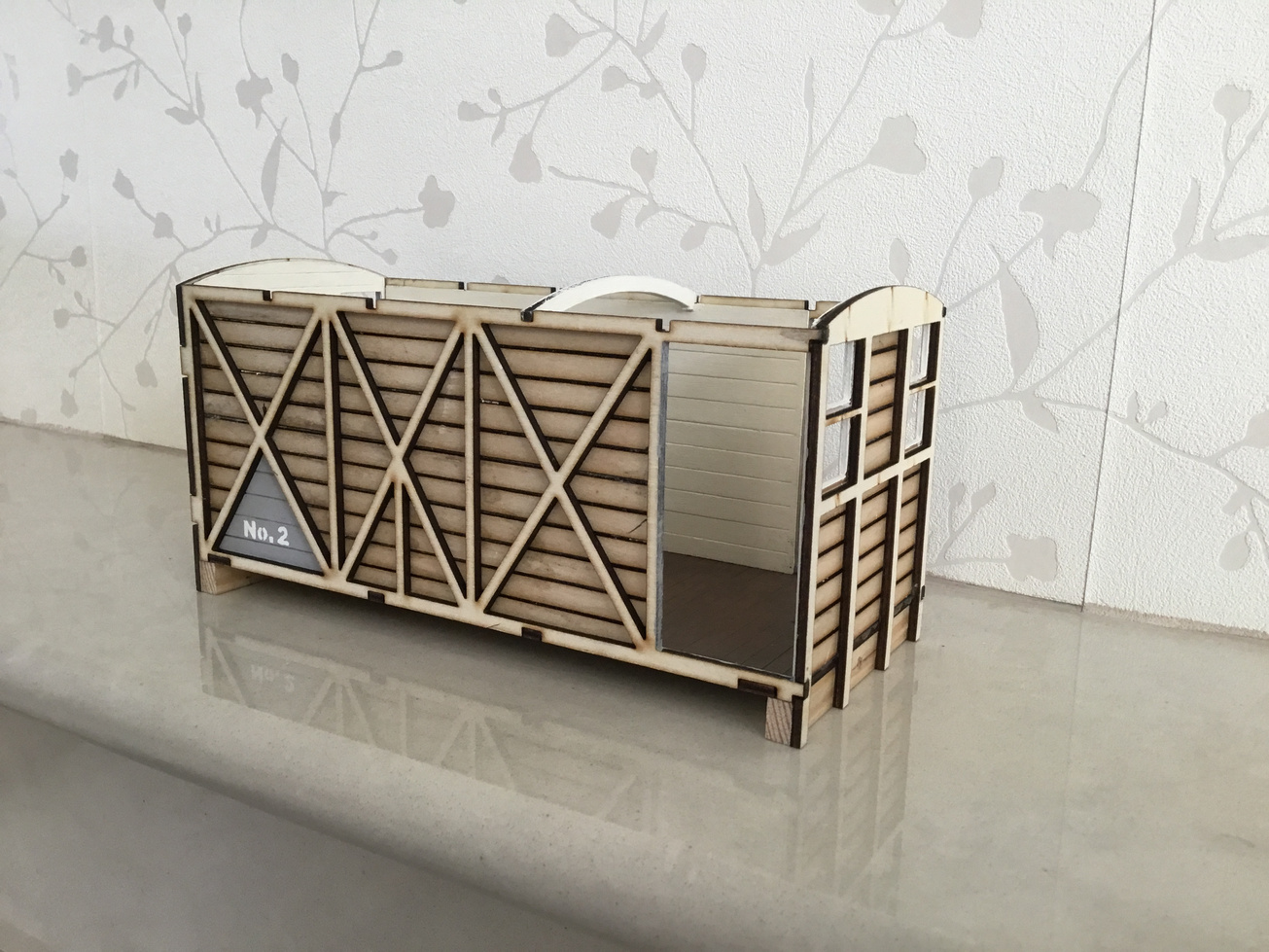

My first Topic on the forum! I thought I would share my experiences about building The Lineside Hut kit for the W&LLR Brake van.

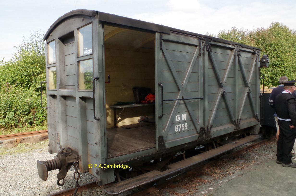

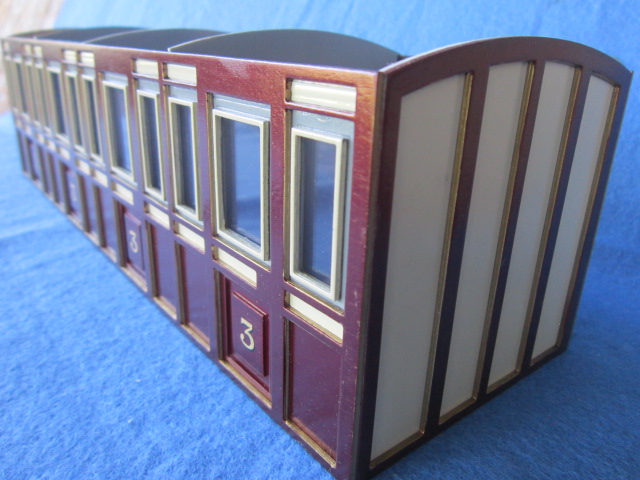

Here's the prototype at Cryfronydd 02.09.2017: The kit arrived in a parcel well protected in bubble-wrap. In addition to the body kit, I purchased the chassis kit and a pair of centre buffers. Some of the outside frame parts are very fragile and one of the end frames had a piece broken off, which was repaired. The internal sides have the planking made by cutting completely through the ply with the laser, with just 2mm or so at the end of each cut retained to keep the part together. These are again very fragile and I managed to break both of the long side parts. In truth, the laser cutting on these two parts were excessive compared to the ends and doors. There were cuts of about 0.75mm width. To improve the strength I ran neat PVA down each cut with a fine brush and the wiped the excess off the surface. This filled the gap and had the advantage that when painted, the paint would not leak through from one side to the other. I wish to paint the interior light cream and the exterior light grey. In order to keep the side flat whilst the PVA dried, I placed a weight on it, whilst sat on plate glass. The instructions suggest constructing the external framing first. Care must be taken as the ends in particular are very fragile. The floor was stained a dark oak colour and when dry, was glued to the external frame work. This improves the strength somewhat, but care is required when handling. The inside surface of the ends was painted light cream and glued to the assembly. When all was dry, I tried a trial fit of the windows to the ends with the outer parts which keep them in place. The windows as supplied are thicker than the ply that they sit into and the outer parts would not sit flush with the ends. I dashed an e-mail off to Lineside Hut asking for help. A reply was received within the hour offering a solution. Additional ends are going to be cut from 0.8mm material and posted to me. These will be attached to the existing end framework to thicken it. This is rather good customer service I think.

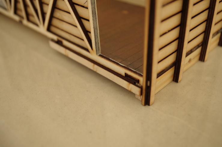

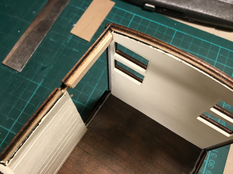

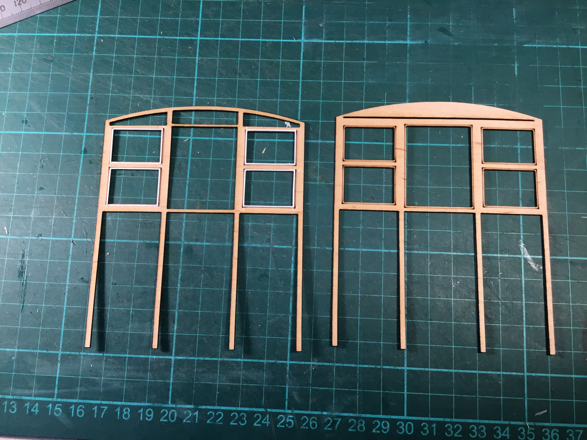

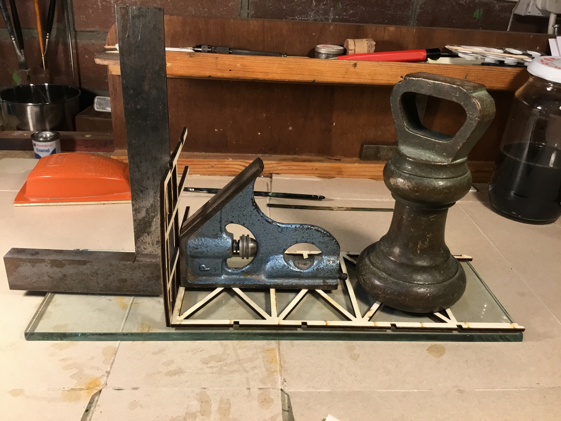

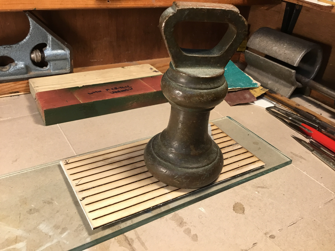

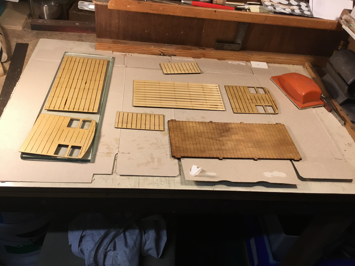

Simon at Lineside Hut explained that the problem with the Windows was because of material tolerances. The windows were at the top limit and the ply at the lower limit. His prompt reply and solution is good.
The planking issue is a manufacturing problem. Either the laser was set too high or the ply cuts more easily than ‘normal’. I think that in using a single pass of the laser to create planking on both sides is probably done to reduce costs. To part cut from both sides would increase laser cutting time and costs.
I’ve been building kits in 7mm and 16mm scales for 30 years and and only a minority’s have been built with no problems; either design, manufacturing or packing. I’ll reserve my final judgement on value for money until the project is complete.

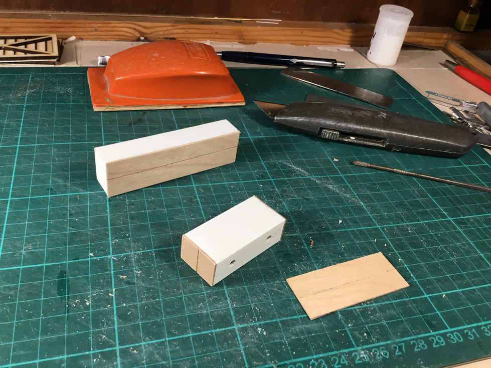

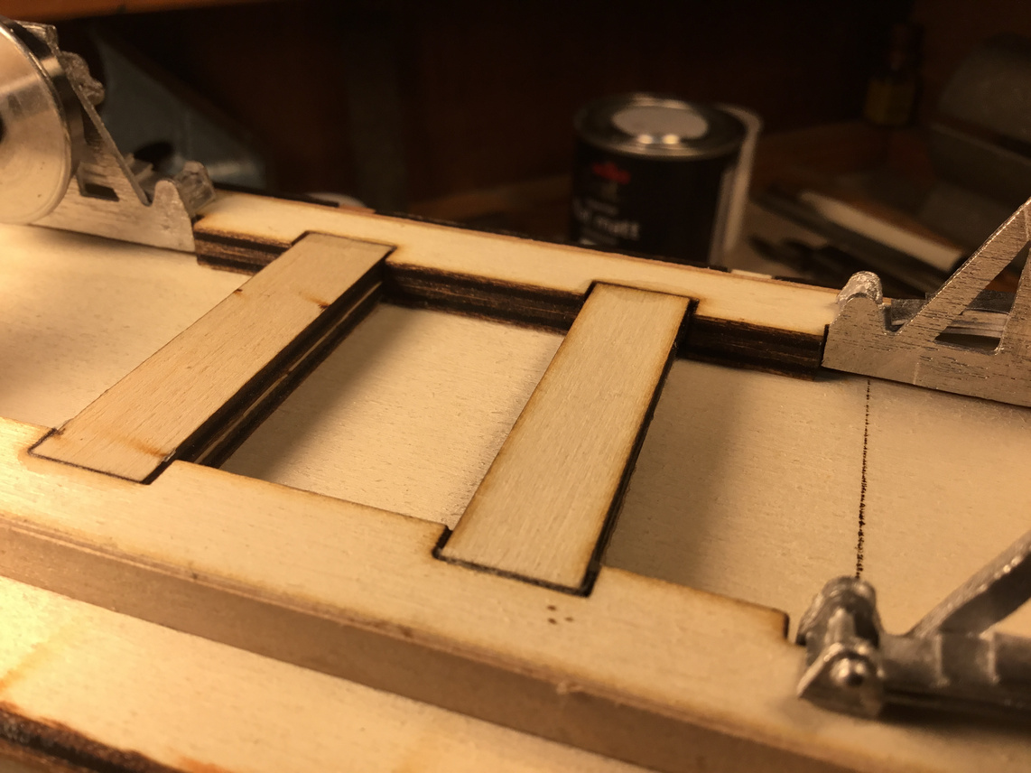

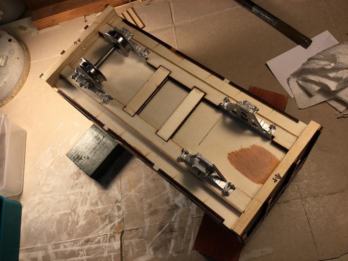

The Chassis Kit
I purchased the chassis kit a) to see what it was like and b) because it was about the same price as buying separate wheels and axle guards. To quote the instructions: The chassis kit contains four long sole bars and four short spacers, these require gluing together on a flat surface to double their thickness. Once dry they need to be made up into an "H" like shape....."
Well, this makes up a solebar that is 6mm thick, but the headstock is 12mm deep. Hmmm..... I think the saving grace here is that the underpinnings will mostly be hidden by the full length foot boards.
The photos above convey what's going on. The intention is to glue the axle guards into the rear recess of the solebars. I'm not over struck with this as it relies on a single glue face for integrity. Garden railways can be a harsh running environment and I subscribe to the 'belt-and-braces' school of engineering. So I made up pockets for the top of the axleguards to fit in.
When the glue had set, a temporary trial was made on a spare piece of (shock horror) 7mm scale 32mm gauge track.

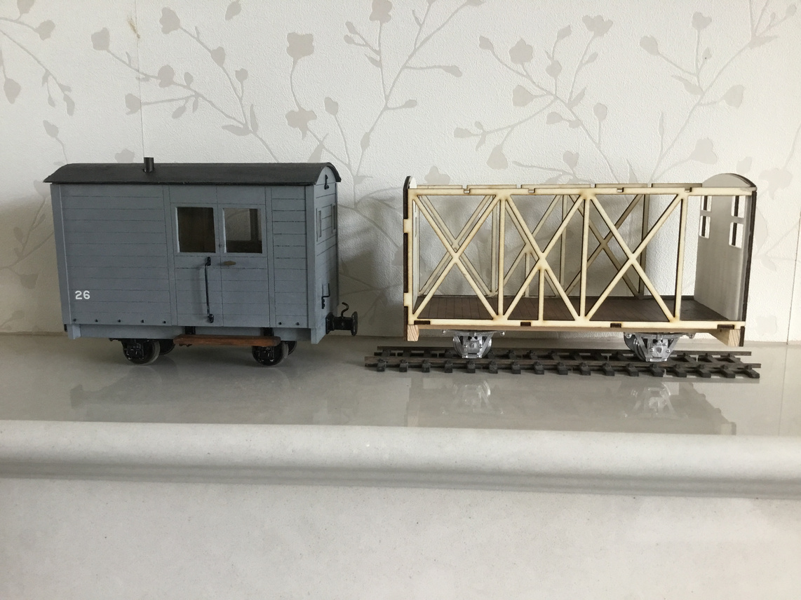

The other brake van is scratchbuilt and is loosely based on a photo of a Ballymena and Larne example.
In conclusion, I don't think I would buy a chassis kit again, preferring to make one up from strip wood and sourcing my own components. However, if one is not confident at making ones own chassis, it does provide a kit to use.

The Chassis Kit

Looking really good so far - and I love the scratchbuilt brake in the picture too. Admirable attention to detail around the windows - it's that sort of thing that turns a quick build into a very lengthy one!

The additional 0.8mm end frets arrived today. A quick dry run showed they will solve the problem. Now glued on and will try again when all dried
. A quick response from Lineside Hut to solve this problem. Photos of progress to follow, but now off to move 3 ponies who trashed an electric fence this morning and ripped a wire out the energiser

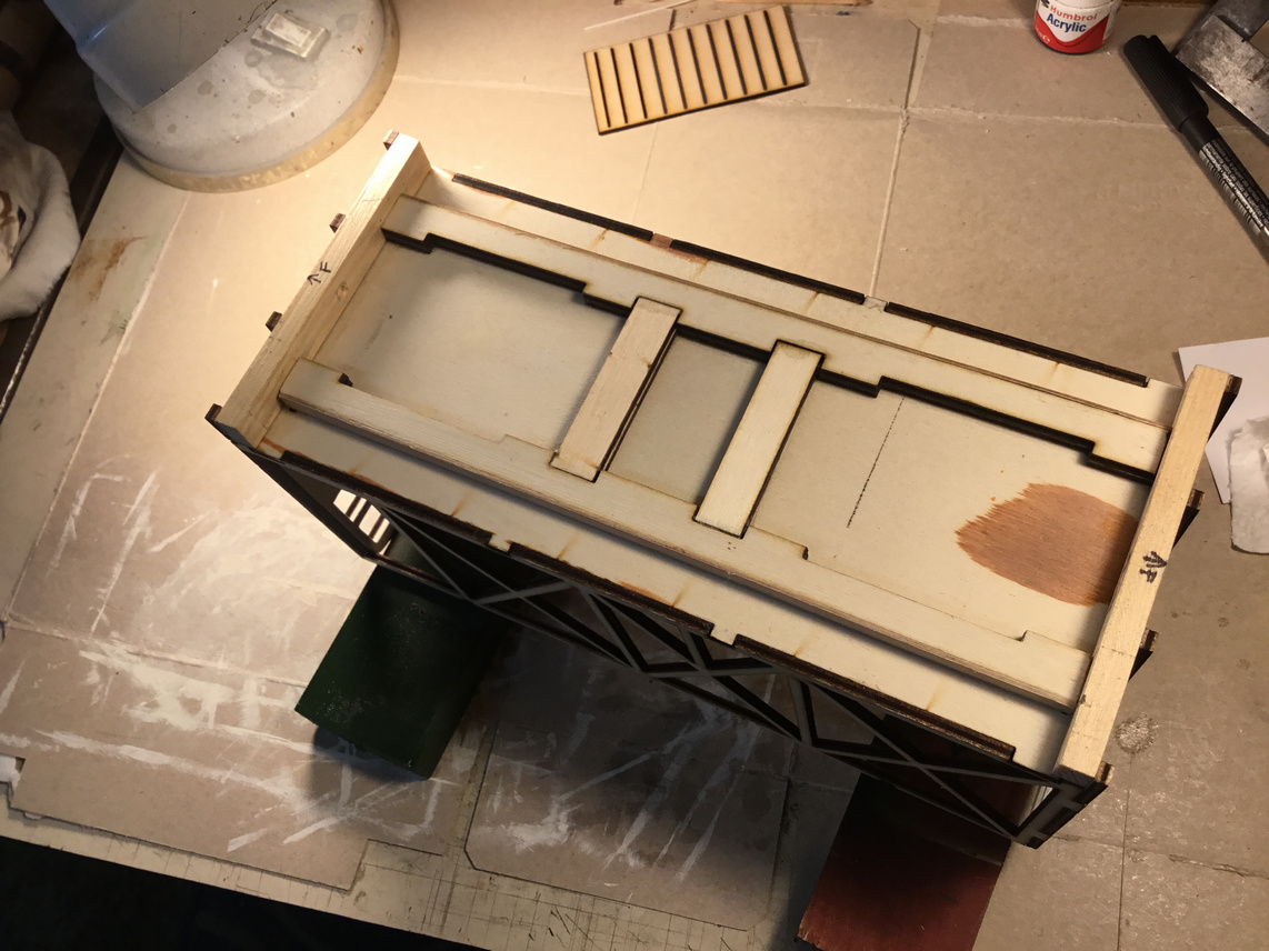

I have now glued the ends and sides into the body framework.
The odd painted panel in the bottom left had corner is because I used the 16mm association stencil to letter up the van.

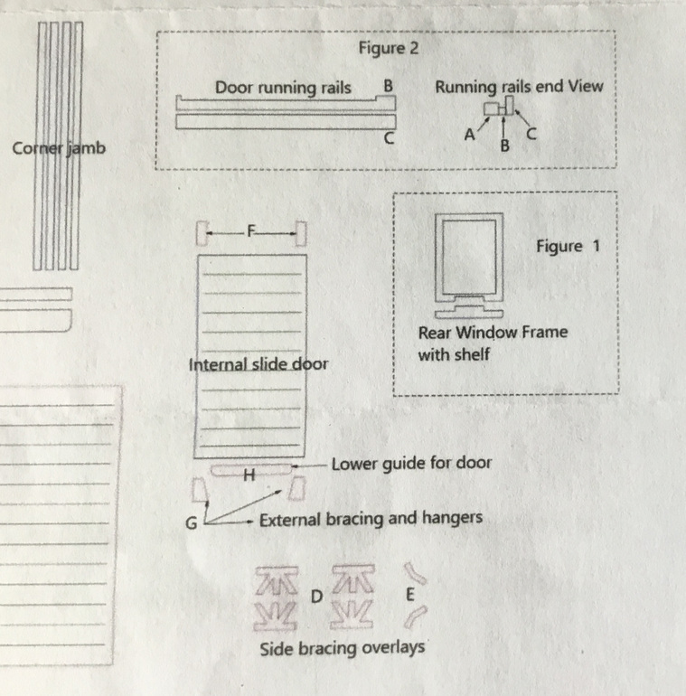

Next, I made up the door runners. I pondered over the wording of the instructions. This extract from the instructions shows in Figure 2 how the runners fit together. Part B is handed and Part A is shorter than B & C. 'A' fits under the floor and behind the headstock, hence the shorter length. For 'B', the 'thicker' end, shown on the right hand side in Figure 2 goes at the end AWAY from the headstock.
This photo from underneath shows how it all fits.
A top view.
I then added the two corner jambs at this point, rather than later as per the instructions. Note that the kit provides 4 of these jambs. Two are intended to go at the non veranda end. The prototype is not fitted with these, so I omitted them. If you fit them, you will not be able to fit and corner ironwork that you make to detail the kit.

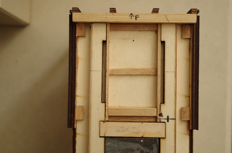

I have made up the doors as per the instructions. The lower door guide 'H' was stained, but in reality will not be seen. The beading for the windows on the end overlays has been completed and this has been spray undercoated using a Halfords Primer rattle can. These goodies arrived from Trenarren Models last week (very prompt service!)
They are:

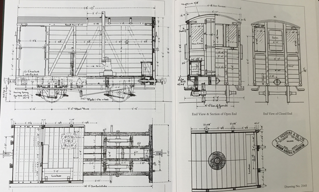

Finally a photo of the Pickering GA of the original build. I am going make up and add the two lockers from scratch. The short one by the door will be moved to the other side of the van as photos of the vans in the condition that the kit represents shows the stove to have moved there! The doors can be made to work, which I will do. However I expect the van will run with them always open so that one can peer in and see the details.

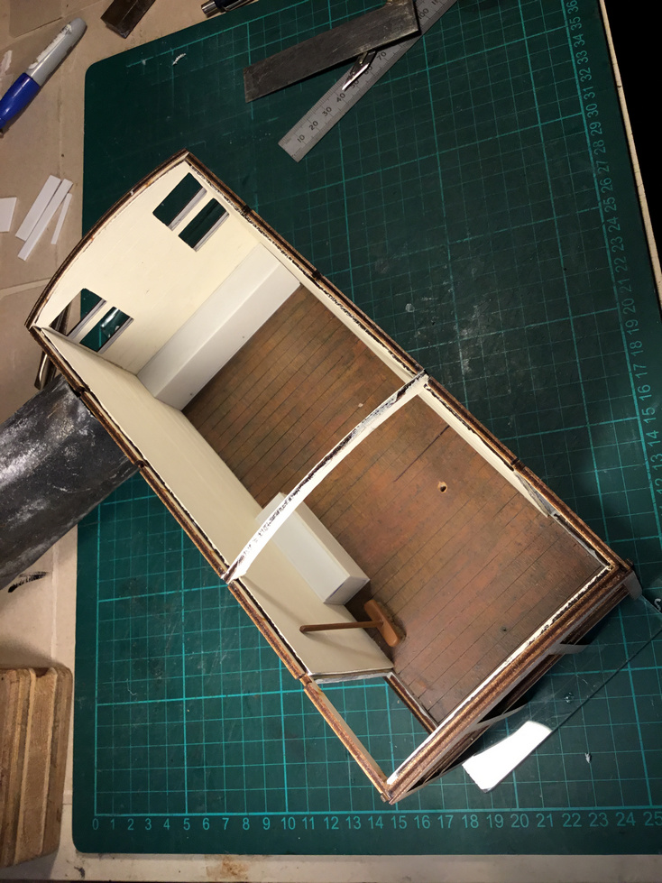

Some more progress. I have been working on the internal detail and am in the process of making the lockers/seats. Because all of my woodworking tools are in storage, I made the basic shape for the lockers from plastic card. The 'boxes' are well braced internally to prevent warping. Hole were drilled in the base pieces to let any trapped solvent evaporate.
I scribed up some 0.8mm ply to represent the planking and glued this to the box, using basic clear glue which works for both wood and plastic card.
Additionally, I strengthen the sides over the door openings. I felt this could be a potential weak point. Two lengths of 'coffee stirrers' trimmed to length did the business, taking care not to obstruct the cut outs for the transverse roof supports.

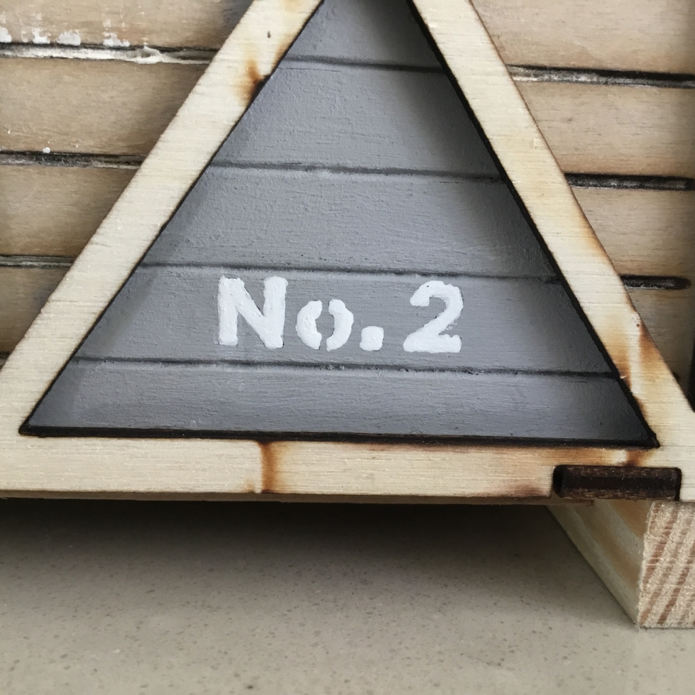

Progress has been slow as I’ve been painting the sides by hand. It really is a case of watching paint dry as it takes about 90 minutes per side for a single coat. By the time I’d finished the last panel, the first was dry!
I think there’s a typo in the instructions. In setting out the position of the split pins that hold the door upper guide rail, 50mm of the copper wire is to be cut. I made it 90mm for the door to work correctly in the lower channel. I used 1.4mm hard brass wire instead of the copper as I’m my opinion, it’s too soft.
