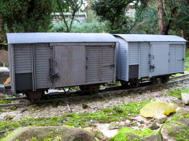

Another new van for the PLR
Posts: 6062
Re: Another new van for the PLR
Post by philipy » Tue Aug 28, 2018 9:40 am
If I didn't know, never in a million years would I guess the origins of that van. Well done.
Posts: 1515
Post by Lonsdaler » Tue Aug 28, 2018 10:42 am
Good stuff - the weathering is just right :thumbup:
Posts: 5723
Post by Peter Butler » Tue Aug 28, 2018 10:49 am
Seeing the transformation of this vehicle from its original form is a lesson in imaginative thinking. The modification and finish are both equally well done and it looks just right.
Posts: 8019
Post by ge_rik » Tue Aug 28, 2018 6:34 pm
Thanks folks, you're very kind. Quite pleased with the way this turned out. These bashes are always a voyage of discovery.

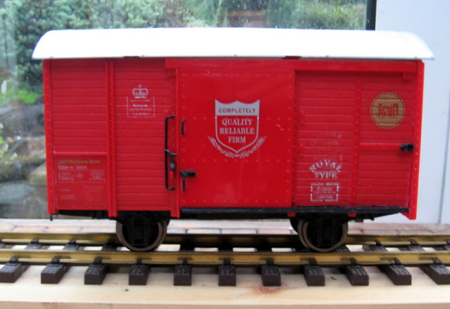

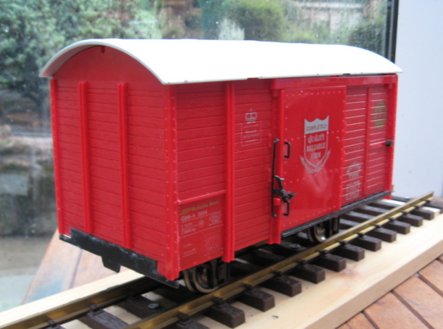

Van #2 now well under way, thanks to the kind donation of another van body from Bazzer42 of this parish.

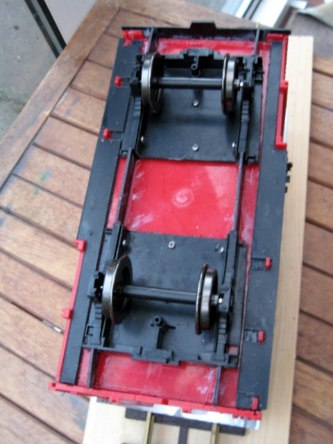

Same technique as previously - end panels removed and ends glued back on to what remains
As the bottom slide for the doors is part of the chassis, I had to make my own from plasticard .....
...... and then use a bisected HLW chassis.
Needs a bit of tidying-up - a few gaps to be filled here and there and of course a paint-job. Oh yes, plus couplings and brake gear. Probably about three hours' work so far - but who's counting?

Second van now more or less finished. A little bit of tidying and of course weathering needed.
The HLW chassis worked out quite well - provided you don't look too closely.
Here's the new with the old.
Quite pleased with the outcome.
Many thanks to Bazzer42 for helping the PLR gain another new item of rolling stock.
