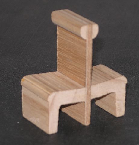

Most impressive indeed Grant. I am not entirely sure I follow what you mentioned about the moulding technique you adapted afterwards but good news I have just found a seller on eBay that provides 1.6mm and 2.4mm square strips long enoughLNR wrote: Thu Nov 09, 2017 12:15 am Hi,
On my first coach, wishing to represent battened seats, I glued down separate battens and getting them all with the same gap was fiddly to say the least.
After that I made a solid seat moulding of timber and heavily scribed the battens, then rubbed it with a dark colour then sanded the tops. Result equally spaced battens, parallel gaps, and through the windows you can't tell the difference.

Hi,
This is the timber cross section I made up for pass. seats. (GTB uses this method, probably where I got the idea!) naturally this ensures all seats are the same. Bit difficult to get a pic. through the windows, but hope this shows the result. Grant.
PS just noticed, in your case it would be minus the front leg.

Very effective Grant, I will be adopting that for the right project
