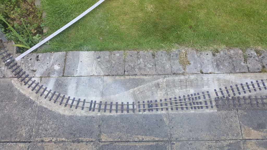

This photo shows the old alignment of the curve (I forgot to get a before picture :roll: ) with the old permanent way removed and the new alignment in place.

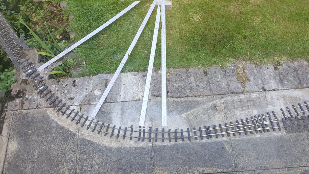

I used a metre rule pegged at the axis of the radius to gauge my curve (with the aim of keeping to 39 1/2 inch radius). This composite photo shows the ruler being laid against the curve.

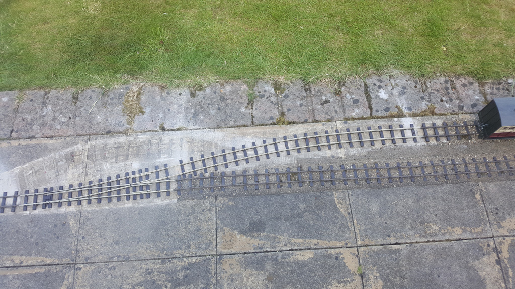

I also took the opportunity move a short radius 38" point (switch) further from the curve in question, and replace it with a 60" radius point instead.
The result is a much smoother curve, even for my stock, and a less ferocious transition from the point, where there was a nasty reverse curve, which also caused some problems. The only issue with this is that it has drastically shortened the passing loop, so similar replacement will take place at the other end, but further down, to restore the loop length.

It's a very nice piece of permanent way work too, if I may say so. The improvement is clear, the old track shadow proves that. A well, and practically engineered, solution. Well done.

That looks to be much better geometry, Ian. Interesting that the SBR comes off fairly easily.

I think a curve template would actually be the best option to avoid these tight spots in future. For now, my metre rule will have to do!
