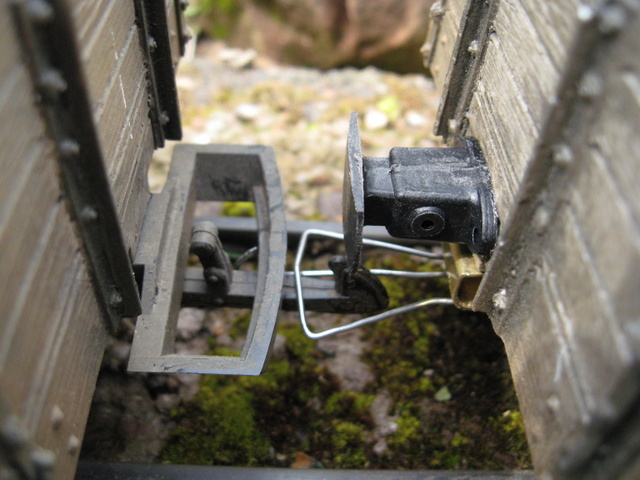

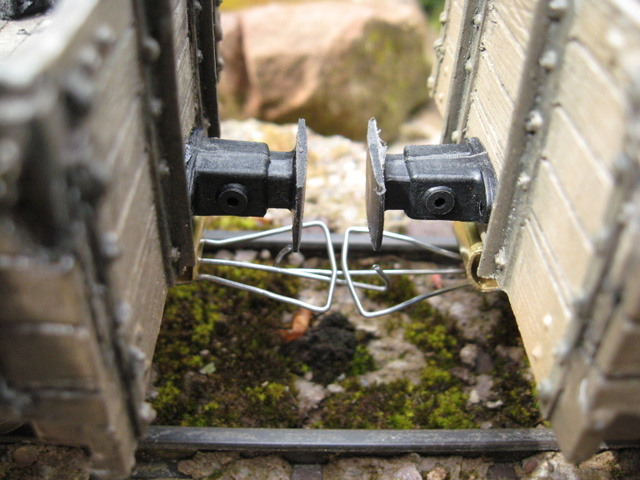

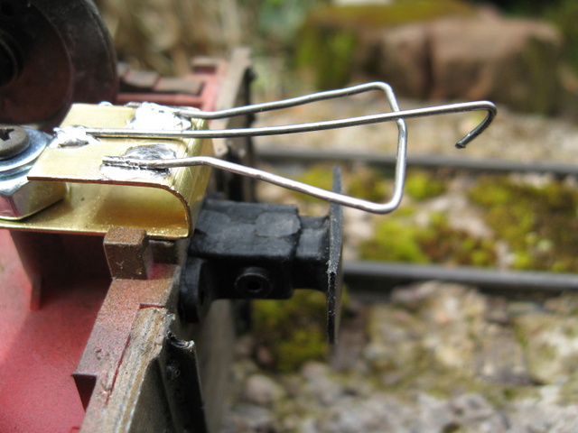

I've been doing some experiments and made some progress on developing my own couplings. I decided that the easiest approach was to produce something which would be a direct replacement for LGB couplings - so same dimensions and same single screw fixing. At the moment, they are very much prototypes - I've ordered some brass rod/wire and more brass plate - oh and some chemical blackening solution.
At the moment, just a couple of paper-clips soldered to a bit of bent-up brass. I'll improve the fixing pedestal as well. .
The hooks engage in the same way as the original LGB versions. .
When pushing, the Binnie Carmarthen couplings bear against each other. I've checked them over the sharpest curves and there's no buffer lock. .
The beauty of this coupling is that it is compatible with LGB coupings and so I can replace them over a period of time and run original and new couplings together. .
I'll post more info once I've made up some 'proper' versions.

Re: Couplings
Agree with blackening these using chemicals rather than painting as it will not last.
I don't see how these uncouple though without having to bend the wire down?
- Posts: 7990
Re: Couplings
Yes, that's right. I'm using the springiness of the wire to provide the auto coupling effect and then pressing the hooks down to uncouple. Same principle as LGB couplings. That's why the hook is soldered further back than the loop.tom_tom_go wrote: Sat May 12, 2018 3:34 pm I don't see how these uncouple though without having to bend the wire down?
Re: Couplings
Having said keep the lgb coupling they look quite clumsy against your home made version. With blackening they will virtually disappear, clever!
