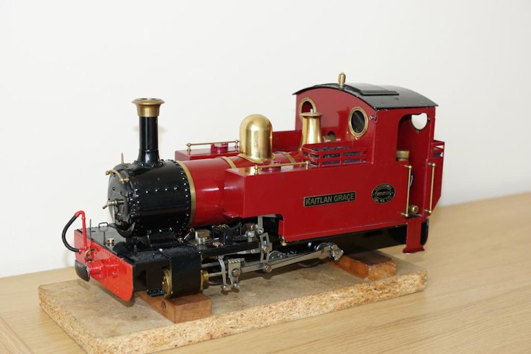

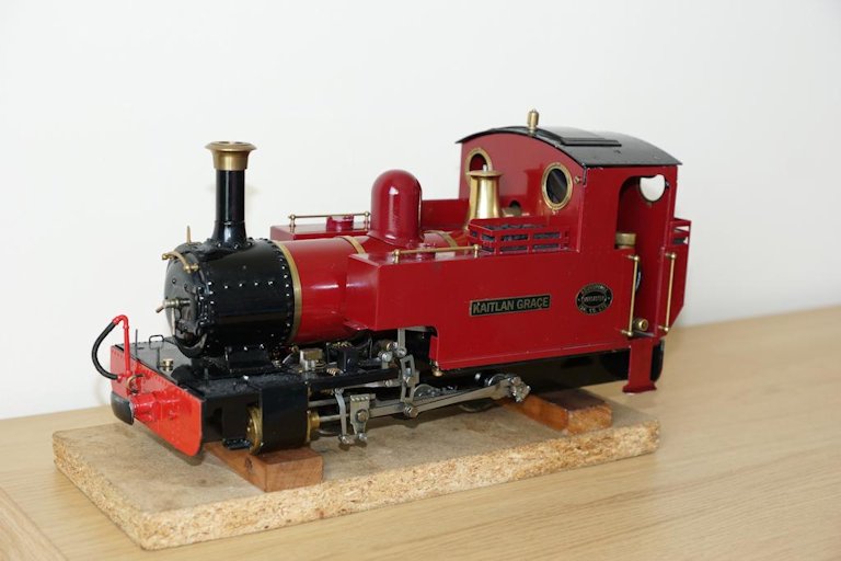

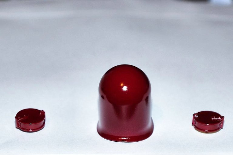

With Rod's permission, here are my pictures and some background of the repainted dome for my Lady Anne.
Most locos have a painted dome so I wanted to repaint mine in body colour. I also wanted a change of tank fillers which were also to be in the body colour. I contacted Roundhouse to ascertain the paint code/shade. (current models paint codes are now on their web site). When I explained my aim I was advised that as mine was an older model (2005 build) the paint used then was Rover Damask Red. Also as my dome was a polished one they suggested an unpolished dome was more suitable for painting. I purchased an unpolished dome from Roundhouse, and some tank fillers from Swift Sixteen.
I bought from my local Halfords the appropriate paint. I suppose any car paint supplier can supply the paint. Halfords is an acrylic formulation in a spray can. Red's can be translucent. I tried first on some scrap metal using black etch primer, but felt the colour not quite right, being a little too dark. A second attempt using grey primer was about right.
So the dome and tank fillers were sprayed accordingly. Two light coats of the final body colour. I will add a varnish in a day or two. The body is only placed on the loco for the pictures as there is a little more work to be completed.
I may also paint the boiler bands and handrails, but I haven't yet decided.
Lady Anne with a polished brass dome
Lady Anne with a painted dome

I do like both of your Lady Anne dome’s and I think the painted dome is very nice and clean, but I also like a bit of brass, so for me I would keep the boiler and handrails brass. But it’s your engine Ian and you do what please’s you mate, they both look great to me.
And thank you Ian for posting and showing me and the rest of the members how you achieved your match, it seems like there is a big difference in paint hues between Roundhouse and other company’s paint’s….

I was undecided about painting my dome originally. When cleaned the brass looks lovely. I have a polished brass dome and a painted dome now so I can ring the changes depending on my mood.

She's got a few mods over the standard Lady Anne. Nothing revolutionary, more appearance related.
She has the dummy union link and combination lever. buffer beam overlay, chuff pipe, Locoworks running boards, a vacuum pipe on the front buffer beam and a Chuffed to Bits top up filler under the dome. I've got more Locoworks parts to add yet so still a work in progress.
