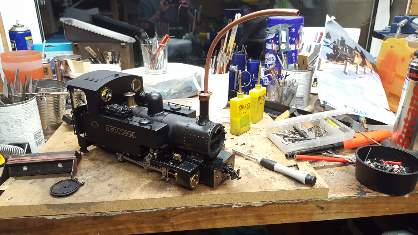

Had another think about this and realised why am I trying to cover the entire chimney when all I need is a pipe to cover the exhaust pipe.
The exhaust nozzle is 4mm in diameter so I have ordered a small length of 6mm copper pipe which I will heat and bend to an angle so I can catch the condensate on start up in a piece of cloth (no more showering the loco in oil).

Re: Copper pipe
Be interested to hear if you have any problems with exhaust back pressure by putting the condensate clearing pipe directly over the exhaust pipe/blast nozzle Tom.

Re: Copper pipe
You won't know until you try it, but..........tom_tom_go wrote: Mon Jan 22, 2018 8:40 pm Had another think about this and realised why am I trying to cover the entire chimney when all I need is a pipe to cover the exhaust pipe.
The diverter pipe over the blast pipe won't cause any exhaust back pressure, as the bore is larger than the blast pipe.
What it will do is destroy the draft by extending the blast outside the smokebox where it can't draw the fire and the fire will then die back, or maybe even go out.
Re: Copper pipe
I am not going to cover the blower pipe so I don't see this being a problem if the blower is on and giving draught to the fire.
The pipe will be only placed on start up for around 30 seconds if that.
Re: Copper pipe
Well it fits but I did have to drill out the hole a bit as it's quite snug (should of gone for 8mm but hey ho):
When our awful English weather clears up I can test it.
