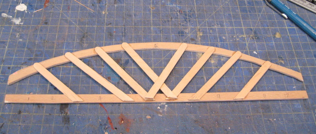

Made a start over Christmas on my latest project - the sawmill at Peckforton.
I wanted to make sure the roof structure worked out OK before doing too much to the rest of the building. My interpretation of Belfast trusses - a bit over-engineered for the size of the building, but I wanted something that looked a bit different.
Next stage will be to clad the roof in corrugated iron - the drinks can donors can just be seen in the background, and then a few more coffee stirrers trimmed down to provide the workers with some protection from the elements.

That's really quite a feat of engineering that you creating there, reminds me of some of the aircraft hangers at Duxford that are still used for storage and restoration. Did you curve the top members or cut them from sheet? Either way another remarkable creation.

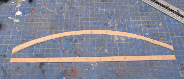

pandsrowe wrote: Fri Jan 05, 2018 8:30 am That's really quite a feat of engineering that you creating there, reminds me of some of the aircraft hangers at Duxford that are still used for storage and restoration. Did you curve the top members or cut them from sheet? Either way another remarkable creation.
Hi Phil
Yes, the Duxford hangers use Belfast Trusses. The curved members are cut from thin ply (very shakily).
Coffee stirrers are then glued on following a pattern I worked out from a picture of a truss.
Once all the struts are in position,
Another curved beam and flat beam are glued on top to make a sandwich
I'm afraid my fret-sawing skills ain't wot they used to be.
