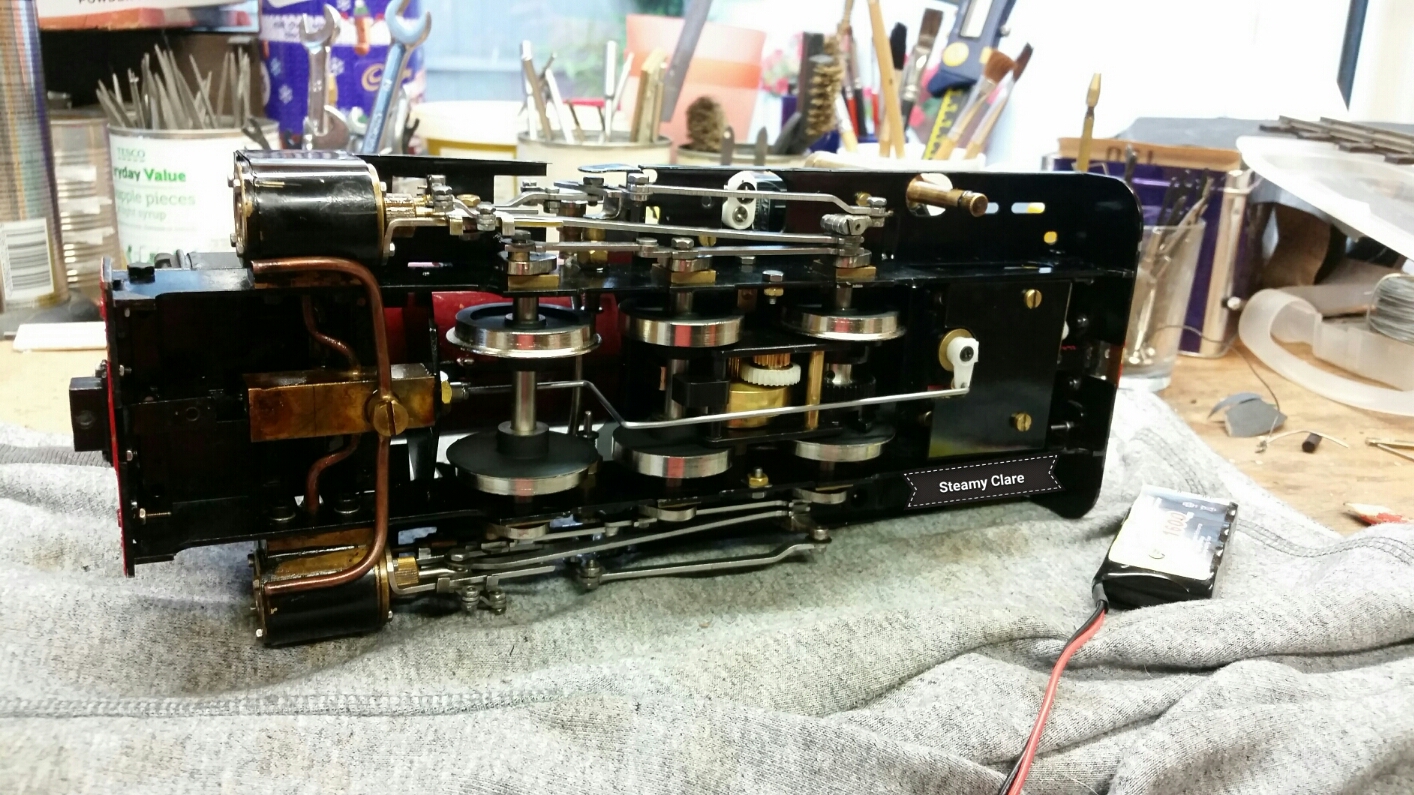

So I finally have a SSP slomo! It was a hard choice between fitting this to my Riverdale Amy or my first loco purchase my Roundhouse Silver Lady but as a gas loco is quicker to get running the SL got the vote.
The SL has a servo that operates the 'simulated drain cocks' which is a slide valve that directs the exhaust up the chimney or through piping under the cylinders. The RH factory servo rod occupied the space where the slomo needed to be fitted so a new one was made.
Mock up rod made from electrical wire:
2017-07-21 21.22.23.jpg (492.31 KiB) Viewed 7266 times
Finished item with original rod pictured:
2017-07-21 21.21.30.jpg (477.38 KiB) Viewed 7266 times
I need to paint the new wheels before fitting as the original insulated wheels cannot be used with a slomo when you run 32mm gauge.

It all fits rather well...
2017-07-28 22.26.44.jpg (883.09 KiB) Viewed 7159 times

First question, you mention a replacement drain cock servo. I did not change the stock one fitted to my Silver Lady so why are you unless Roundhouse have changed the servo layout of the loco since I purchased mine and you cannot fit the Slomo with the current servo fitted?
With the Deltang RC Trains install I did not have to make any changes to the existing wiring or servo adjustment other than fit a servo reverser for the whistle servo as I am using the bind button to activate that servo and you cannot change the 'throw' on the bind button. As you can see in my pictures I did away with the AA battery pack that Roundhouse use in the roof and bought a battery pack to fit in the body but I don't think you want to do this as you mention you already have a a battery?
The servo rod is a standard Roundhouse one so order a couple in case you make a mistake and snap one on your first attempt (I did). It is difficult for me to give you exact dimensions of the rod as it is now installed in the loco so I would suggest you build a mock rod like I did (using easier to bend electrical wire) and then when you are happy use that design for the actual servo rod you intend to you. When you bend the servo rod heat it up as it will be easier but don't go mad with the heat as it's not durable enough to withstand high temperatures.
The rod is threaded at one end which is where you will screw the slide valve back on that controls the flow of steam up the chimney or out the pipework under the cylinders. The other end needs to hook into the servo arm. I found it difficult to bend such a small hook that was in the right position for the servo so I bent the end of the rod into a L-shape instead and then soldered a brass washer on top of the rod so that it would not pop out.
Hope that's enough to get you started but it you need further help let me know.

My first boo-boo: I didn't mean servo, just the servo rod. I'll do as you suggest and get a couple from RH, so they're already threaded etc. If I'm changing it to incorporate 2 right angles, won't it need to be longer, though? I have a friend from work who has offered to help - he's building a 5" gauge Black 5, of all things, so has the kit (and more).

I have fitted a Slomo to my RH Billy that is under construction. Why not just undo the grub screw if you want to run at a quicker track speed without the slight gear whine or drag of the Slomo? I am going to break in my Billy this way for atleast the first few runs. I prefer to run a "scale" speed with my narrow gauge engines, most gentlemen I see on youtube are running way to fast most of the time. Yes, running scale speeds without the Slomo is more challenging, even with good RC control, not so easy with manual control. Of coarse, a really good long or heavy train will tame a jackrabbit engine. But we do not seeing anybody say not to pull heavy trains. If you are doing proper maintance of your motion, flushing old oil and grit out and replacing with fresh oil, then wear should not be an issue. If it does eventually become an issue, new rods are but a phone call away, or drill them out and put bushings in them like the real engines have. Cant wait to run my Slomo fitted Billy! Back to working on him. Mike the Aspie

When you ring RH just ask for the Silver Lady simulated drain cock servo rod as they cut them down to save on postage costs.
