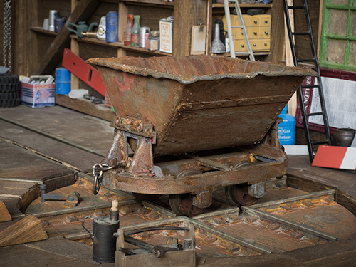

Hi, if you want a lightly weathered or ex-paint shop effect then advice as above, but many Rugga type skips had a hard life and if you search the internet you can get 2 (or some times 3) part art-effect real rust. I use car spray primer then you paint on the gloopy 1st part rust treatment, the after 24h or so paint on the second part and then wait until the effect develops. The current version I got off internet has a third part to stop the process.
Cons: It is real rust so keep away from metal wheels as it can cause them to rust (usual reasons why I know this!), and second it is more expensive than paint. It doesn't keep for ever so I tend to wait until I have several models that would benefit from heavy rusting.
Here is a picture to give idea of the effect on a Binnie tipper, but looks the same on Slaters and Brandbright tippers.

Post by LNR » Fri Dec 15, 2017 10:37 pm
Another atmospheric shot, can smell the oil and paint. Superb weathering, and not just on the wagon, the floor, the track everything.

Post by steamer68 » Mon Dec 18, 2017 2:24 pm
Brilliant weathering affect thanks for the advice. :D
