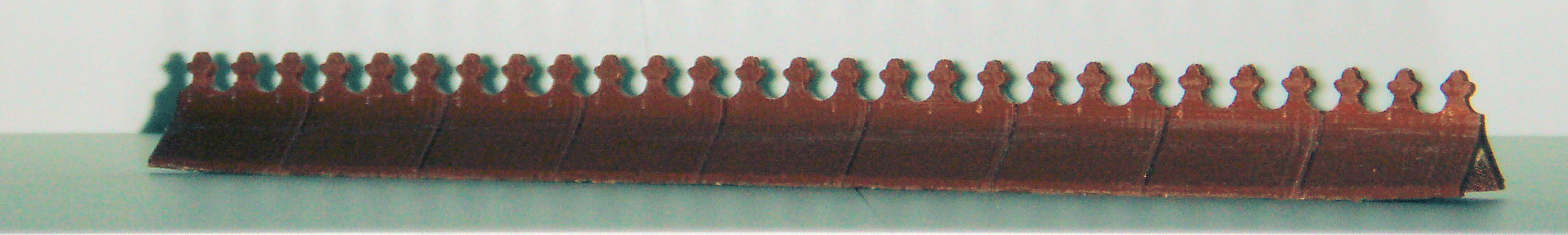

Thinking about what else could usefully be printed, and in the same vein as the gutters, ridge tiles came up as a suitable candidate, particularly the fancy Victorian/Edwardian ones.
I have had a go at two options, firstly a relatively simple cockscomb type. It wasn't difficult to draw and I printed one off as a test piece, which was succesful. I then multiplied it up on the drawing, to see how three would look, and printed that. That also looked pretty good, so I looked on Google for something a bit fancier and found a picture of a reclaimed one with a sort of fleur-de-lys decoration. The drawing geometry took a little bit of thought but it wasn't too difficult. Again I did a one off test print,
...then multiplied it up 9 times to get a length of ridge slightly longer than I will need. I have to say that I am pretty pleased with it. I've just run a file over to remove odd bits, and it still needs some wet and dry, but other than that its not too bad, I think. I still have to print another one, since I have two roofs to do.
Coming back to the PLA vs ABS, the white test prints are in PLA and the brown 'production' version is in ABS.

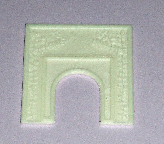

I've been exploring fine detail, just to see what I can do.
Decided to have a go at a cast iron fireplace for the waiting room.
The black one is the finished item, but difficult to photograph. The white one shows the detail from a test print part way through, just to see if it was worth continuing with.

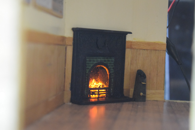

First, the fireplace from before but now in situ:
And then with the fire lit:
OK, the technical details: The 'fire' is a printed block of transparent PLA with a cavity in the bottom big enough to take 2 x3mm LED's. Unfortunately I forgot to take a piccy of the printed block before I installed it, but the drawing for it looks like this:
Now, the spikes are just random extruded triangles but that print is only about 20mm across the face and the printer isn't happy with all those spikes at that resolution, so it kind of mashes down into a sort of random uneveness, which is what I was after.
As I said, there is an aperture underneath for 2 LED's. I got orange and yellow random flickering ( NOT flashing) types and put one of each side by side in the space, switched it on and Hey Presto! Actually, to begin with it was little too bright but some random very small dabs of black paint both simulated coal and took the edge off the brightness. The grate bars at the front are just 3 small strips of Plasticard.
The still photos don't do justice to the flickering effect. This is a bit pale because my wife's iphone got a bit swamped by the light levels, but it shows the effect. The colours are really closer to the still photo above.
