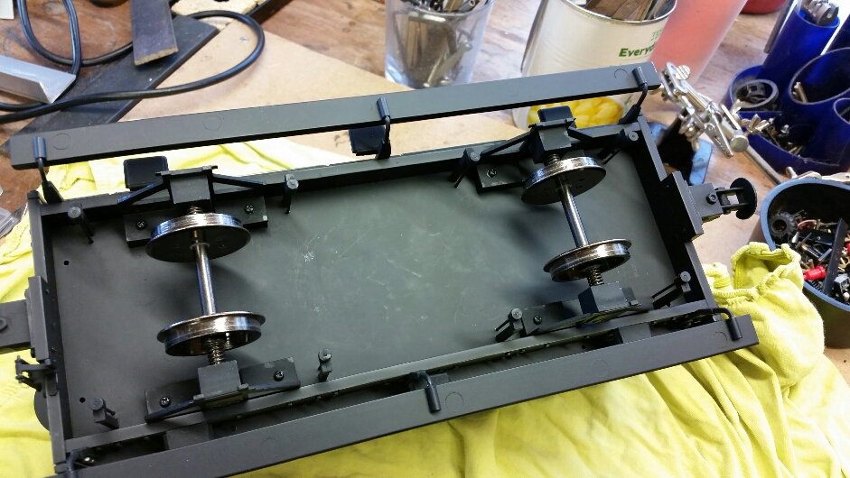

I could not bring myself to perform surgery on this coach so I have found by changing the IoM wheels for Accucraft W&L 30mm offerings which have a slightly thinner wheels it can just sneak around Peco ST605 curves.
Trouble with running 32mm wheels in Accucraft stock is that the axle boxes are always set for 45mm gauge so the 32mm wheels slide about. By adding springs the wheels stay centred:

2017-05-07 19.16.36.jpg (410.77 KiB) Viewed 11228 times

Post by MDLR » Sun May 07, 2017 9:34 pm
Brandbright used to do 32mm gauge wheels on axles for 45mm avleboxes - I've actually got a set. It might be worth enquiring if the new owner has reintroduced them.

Post by tom_tom_go » Sun May 07, 2017 9:40 pm
MDLR wrote: Sun May 07, 2017 9:34 pm Brandbright used to do 32mm gauge wheels on axles for 45mm axleboxes - I've actually got a set. It might be worth enquiring if the new owner has reintroduced them.
Here you go:
http://www.brandbright.co.uk/product_in ... cts_id=270
I am happy with the springs, once the wheels are painted you will not notice them.

tom_tom_go wrote: Sun May 07, 2017 7:23 pm Trouble with running 32mm wheels in Accucraft stock is that the axle boxes are always set for 45mm gauge so the 32mm wheels slide about. By adding springs the wheels stay centred.
They look better as 4 wheelers anyway, well done.
I've never thought of using springs as spacers like that. Just make sure they aren't compressed by much, or they will increase the rolling resistance. Unless of course, you want your locos to work a bit harder so you can hear the exhaust. ;-)
The Brandbright extended bearings only work with their wheelsets. A cheap and simple way to centre Accucraft wheelsets, that doesn't require a lathe, would be to cut pieces of suitable size K&S tube to use as spacer sleeves.

Post by tom_tom_go » Mon May 08, 2017 1:06 pm
Thanks Graeme for the K&S tubing idea but I already had the springs as these were left over from all the Accuraft choppers I have butchered over the years, and I like things to try and use stuff I already have (my wife's 'thriftiness' has finally got into my railway work).
The wheels rotate freely so should be fine. Now that it can stay as a 4 wheeler I can model the leaf springs shown in the picture Keith S found using Plastikard.
