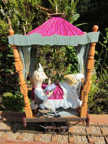

I have made some figures myself, although a little larger than 1/19th scale for my Emetts. For the framework I used floral wire, the sort flower arrangers use to make blooms stay where they want them. It is very flexible and easily makes up into a human form with additional strength added by winding it around itself. Even then it can be altered in shape without breaking. For the torso I used DAS modelling clay, although this is not suitable for outdoor use. Fimo would be far superior and by baking in stages, give additional strength.
After spending time, and a significant amount of money, on materials etc. I think paying for the 3D printed ones suits me better.
They are not detailed as SM32 figures should be, rather more cartoon characters for my particular needs.

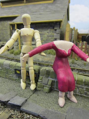

I have seen on the SE lounge someone using wooden art mannequins to build whether you can obtain them to scale 16mm size I don't know. There is also a quick 2 x A4 tutorial by Rob Bennett who makes it sound oh so simple...probably is to some.

I use those too as they are suitable for the larger scales. Available from 'The Works' at about £1.00 each they can be used as a good strong adjustable mannequin. Designed for artists to draw figures in various poses they are almost infinitely adjustable.bazzer42:121357 wrote:I have seen on the SE lounge someone using wooden art mannequins to build whether you can obtain them to scale 16mm size I don't know.
Unfortunately too big for SM32....
