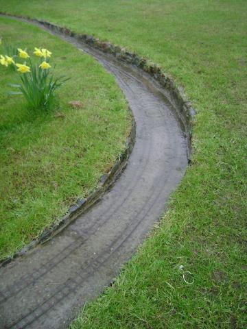

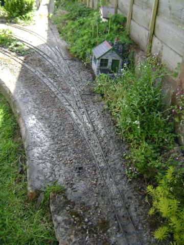

I use 2 parts sharp sand, 2 parts compost (cheaper and more sustainable than peat and the missus has a load over each year after growing spuds in it), 1 part cement. I then add enough water to make a good runny slurry. The mix is poured over the correctly-laid track and persuaded in to shape with a handbrush. Then I sprinkle horticultural grit over the top, pat that down with the brush, sprinkle with a watering can and walk away. Next day, it is still soft so I use a wire brush and the handbrush to remove the excess, clear flangeways, etc. Two days later it is set solid.
Newly laid and still wet...
A few months old on the left, with the rest a few years old...
It is pretty weather proof...
