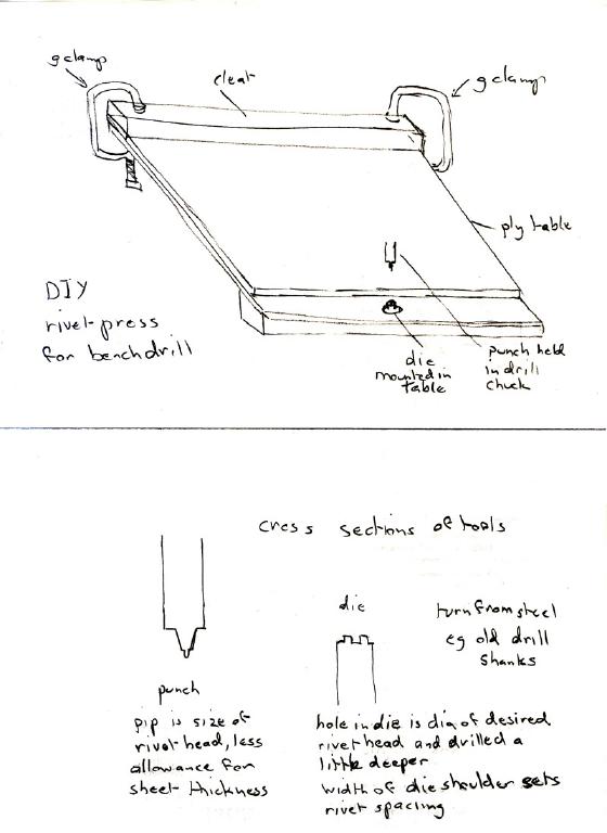

I posted this back of the envelope sketch in another thread a while ago. It's based on one a friend uses in his drill press and it works well. I got carried away and built a scaled up version of the NWSL Riveter to use in my mill/drill, but it doesn't work any better than the one in the sketch......... :roll:
If you know someone with a lathe, the punch and die are a simple turning job in mild steel. It would be possible to turn and drill the parts in the drill press with a file if you are careful.
If all else fails, NWSL in the US have their Riveter back in production if their website is to be believed and they sell alternative punch and die sets for $6.00 US. The 0.050" inch set is about the right size for SM32/45 scale.
The MetalSmith rivet press shown in the Swift sixteen instructions also has spare punch sets available which could be used in a bench drill, but they are a bit more pricey than the NWSL parts.

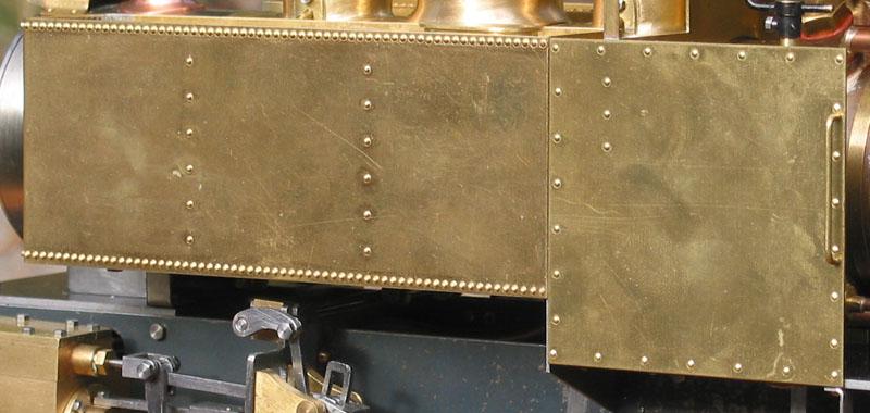

There's 300+ rivets on the Fowler bodywork, some are punched with a punch and die set and some are individual rivets. Tell me which ones are the individual rivets..........
