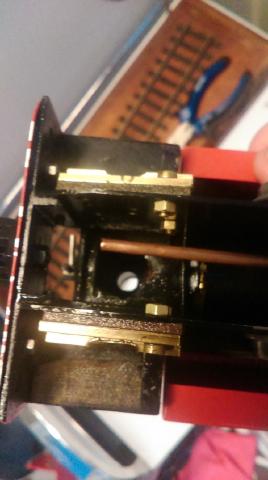

ok, well after fixing the steam leak etc it ran well but when i tightened the nuts holding the cylinders to the frames the cylinders fell off (and nuts and springs) it was all working so well :( so now im left with this:
at least i know when its all tightened and fixed on correctly she will steam very well its just now a case of putting the cylinders back on and i dont really want to take the frames apart as im not that knowledgeable on these matters.

Joe, you can lift the plates that the cylinders are attached to on said trunion, off the frames separately. They cna be fitted and unfitted without needing to dismantle the chassis.

Yeah thanks Doug , I realised I could do that after suddenly having a rare eurica moment :) , just waiting for a nut spinner set to come in the post and then I should have it sorted by this weekend for a steam up . I've got my short circuited diesel to Contend with next :)
