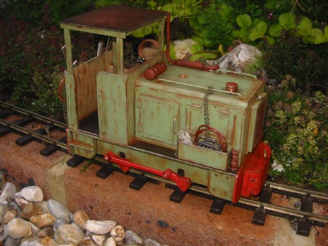

I have a new Roundhouse Little John - but I think the paint is too shiny.
I have tried some different weathering-effects on wagons and buildings, but these are totally painted from the primer to the final paint coat.
Has anyone here good advises about weathering rust streaks, grime, mud and soot on these engines?
And how to achieve a not so shiny look?
And how to seal the weathering effect?
Kjell Anderdal :)

Post by Gremlin » Wed Jan 01, 2014 4:02 pm
I tend to use ground pastels for weathering, just rub on sandpaper
then apply by brush. They won't stick to your nice shiny finish so a coat of matt varnish will be needed. Then another to fix when finished.
Here is an Andel model I finished this way

Post by KjellAn » Thu Mar 06, 2014 12:13 pm
Here is the result of the weathering of my RH Little John and a rake of gravel wagons.
And here is the way I did it. Thanks to all the good advises is this tread. :)
First a thinn coat of matt varnish, then a wash of black and rust colors mixed with white spirit.
The rusty chimney and the footstep are drybrushed with burnt sienna powder color. Inside the cab a woodenplank floor.
The roof is first painted in different rust colors, then a layer of chipping fluid, and a topcoat of silver acrylic paint.
When the acrylic was dry, the roof was dampened with water and scratches made to look like rust spots.
Then some ruststeaks and some soot from the chimney.
Finally the little beast was given a matt varnish to seal the weathering.
Those gravel wagons were also weathered in the same way as the roof of the engine:
First painted in different rust colors, then a layer of chipping fluid, and a topcoat of grey acrylic paint. When the acrylic was dry,
the wagons were dampened with water and scratches made to look like rust spots.
Finally ruststreaks and a topcoat with matt varnish to seal the weathering.
Kjell Anderdal :)

Nicely done and changes it from a toy look to something much more realistic. I'll have a word with my crew as yours obviously take more care of their loco :lol: To finish off I'd dirty up the cranks a bit, they shine too much now.

Post by KjellAn » Sun Mar 01, 2015 7:57 am
RuneK:108610 wrote:Where do you get all the materials needed?
First I paint rust colors - Hubrol Enamels - on the engine/waggons.
To make spots and lose paint flakes of the top coat, I have used this stuff:
http://www.amazon.com/Ak-Interactive-Ak ... B00AMB67W2
You may also use a hairspray from your girlfriends stuff in the bathroom. :D
When the chipping fluid/hairspray is dry, then spraypaint a top layer with the right color of the engine/waggons. Here it is important to use a watercolor/acrylic paint.
When the acrylic paint is dry, then you can make scrathes in it. The chipping fluid/hairspray makes the acrylic paint to loosen from the surface, then to expose the rusty colors under.
To make ruststreaks I have used Humbrol or other enamels witch are washed out with whitespirit.
Finally to protect the rusty finish, I spray a thinn layer of matt varnish on the engine and waggons.
You may also find more about how I did this in SMT #150, page 22-23.
Kjell Anderdal :)
