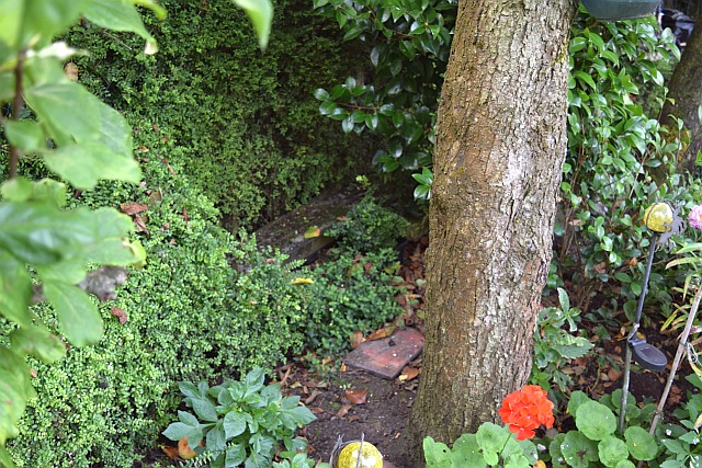

This shows the future location of the lower end, the sump will be just in front of the roof tile ( I have a number of theses dotted around the garden to give me somewhere to stand and get at the track if necessary). The leafy green lump at the LH side is a Lonicera Nitida tunnel.

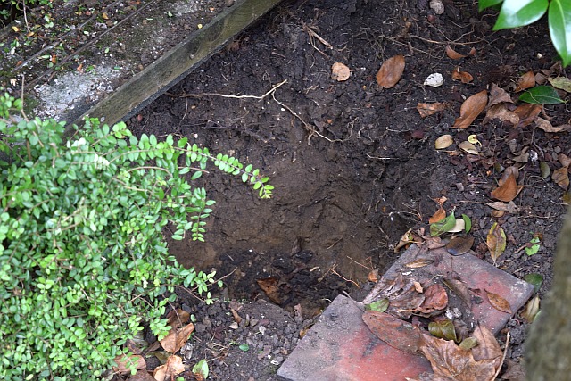

As I said, I made a start yesterday by excavating a small trench from the lower side of the bridge to the sump position and a sump hole. These are just to check the viability before I irrevocably attack the existing trackbed and will need enlarging in due course to make room for the bank rocks, etc. So far all seems OK.
