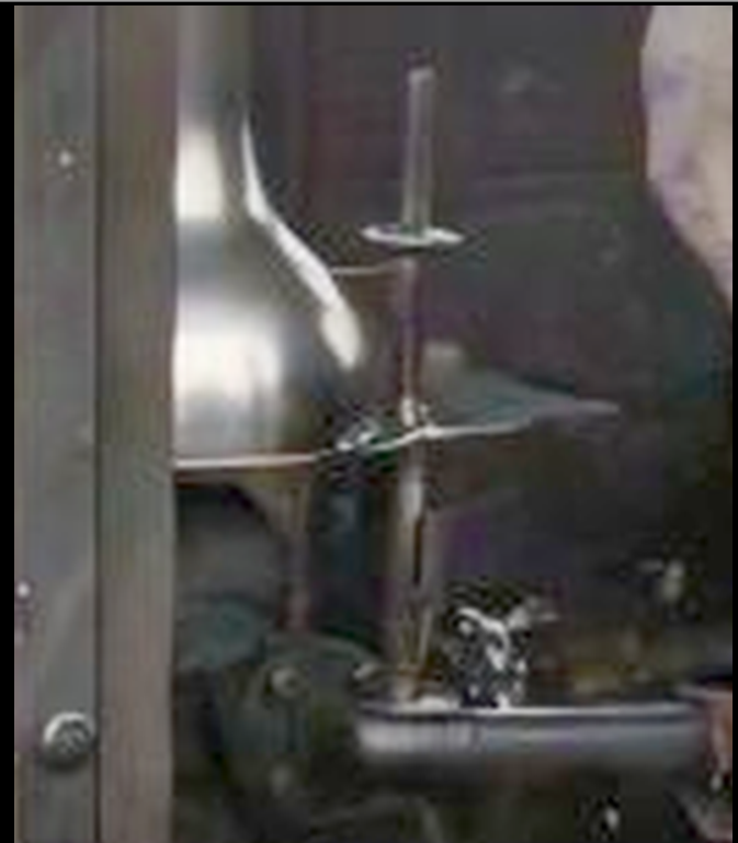

GTB wrote: Fri Jan 07, 2022 10:44 am
The boiler has a Salter spring safety valve on top of the dome, mostly under that polished brass trumpet cover, but the spring column is just visible beside the cover. Presumably there's a hole in the roof for steam to escape, unless the loco doubled as a mobile sauna.
I'm afraid that I'm getting myself bogged down with detail on this project, instead of getting on with actually building it ( although it is getting there and does actually run). My excuse is that the weather is too cold and damp to be able to go out into the garage and paint it!
Anyway, I'm after advice/suggestions re the safety valve. As Graeme says, the spring column is fairly visible to the right of the polished dome cover, and by enlarging the pic, it is just possible to make out the horizontal arm linking the spring to the valve on the dome. However the arm looks as though it goes behind the dome cover, which seems very unlikely, so would there be a slit or hole in the polished cover?
Screenshot 2022-01-25 06.56.58.png (297.41 KiB) Viewed 14440 times
The other two points about the SV arrangements are
(1) the vertical pipe out of the top of the cover ends in an upward facing bell-mouth a short distance from the roof and a plain piece of pipe has been joined to it to extend it up to a presumed hole in the roof This again tends to suggest that the complete assembly came from a steam launch originally.
(2) the photo colourisation suggests that the cover is polished steel, whereas to my limited knowledge they were normally brass. Any thoughts anyone?

Post by GTB » Tue Jan 25, 2022 2:02 pm
philipy wrote: Tue Jan 25, 2022 7:05 am
<snip>
I've got the opposite problem, The workshop temperature was 35 degC this afternoon, if I tried painting, the paint would dry solid in the airbrush between filling the cup and pressing the trigger...... :shock:
There would be a slot of some sort in the dome shade, as the operating arm of a Salter type safety valve moves up and down.
The dome shade/safety valve cover could be made of anything, as most of the colour of a colorised b/w photo is just a guess by the operator, or the AI software. It's not to difficult to figure that a european face is pink and that trees are green, but that's as far as it goes.
An experienced sheet metal worker could form that shape out of either mild steel or brass. I'd lean toward brass, as it is common in marine use and on locos as it looks more decorative when polished. Polished steel would rust while you watched it on a steam launch with hot steam wafting around.
Posts: 6051
Re: Contractors Loco Project
Post by philipy » Tue Jan 25, 2022 2:48 pm
GTB wrote: Tue Jan 25, 2022 2:02 pm There would be a slot of some sort in the dome shade, as the operating arm of a Salter type safety valve moves up and down.
Thanks Graeme, those were my thoughts on both counts, but confirmation is good. Anyway, brass will add a bit of colour to the "any colour you like as long as it's black", of this beastie.

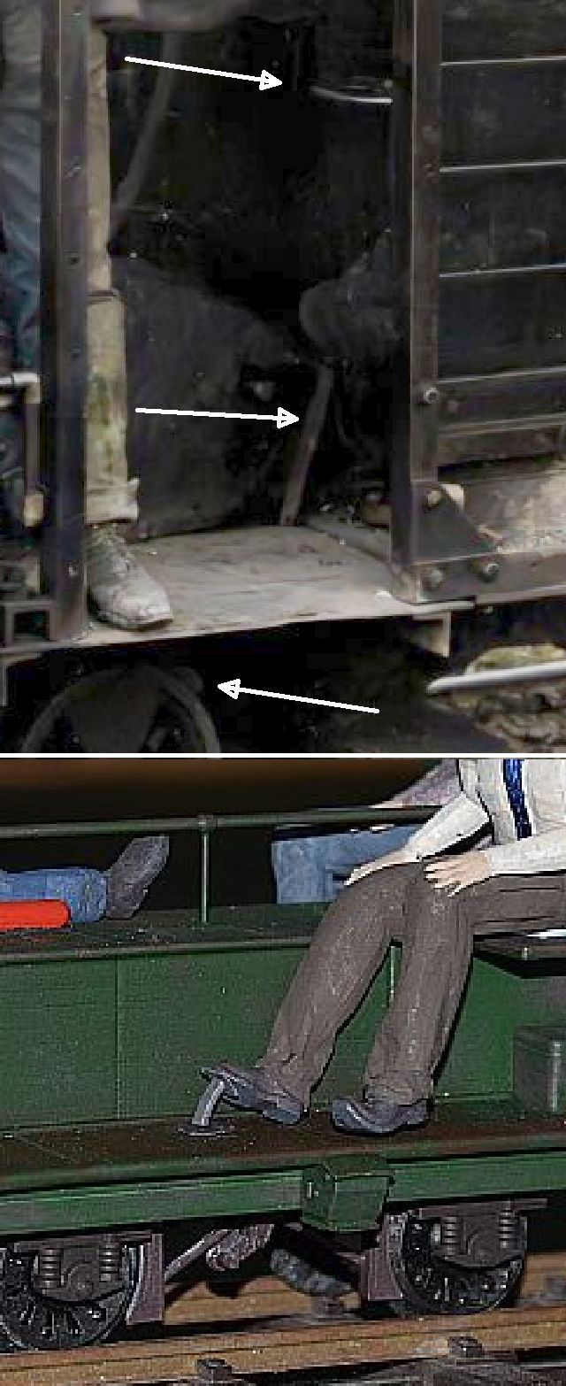

Posts: 6051
Post by philipy » Thu Jan 27, 2022 6:56 am
I know we talked about brakes some while ago and I keep coming back to it - there must have been brakes somehow, somewhere. This contraption would have been pushing and pulling unbraked skips etc and it would have been the only way of stopping them from running away.
Three things on the photo seem relevant: the shiny handwheel just visible floating in mid-air(!), the angled piece of metal under the chaps left foot and a small piece of what looks like wood apparently touching the top rear quarter of the rear wheel.
My thinking is that the handwheel is a parking brake, akin to a brake van. Then I'm wondering if the piece of wood is a rudimentary 'brake shoe' operated by a foot pedal which is the angled metal strip under his foot. This would be crude but very similar to the foot pedal brakes on the Wickham Trolley.

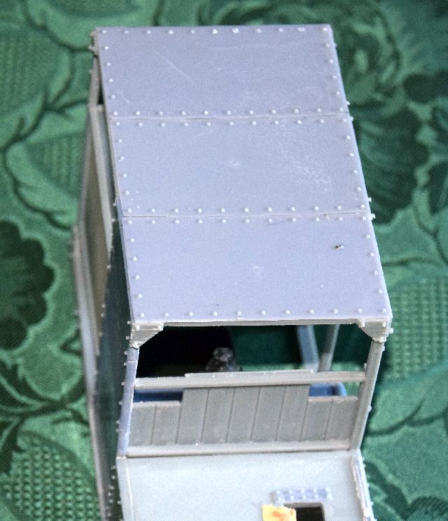

Posts: 6051
Post by philipy » Thu Jan 27, 2022 3:52 pm
After all the drama over printing the roof sheets, I thought I should show the result!
Not fixed yet, but I'm happy with it so far.
Posts: 5717
Post by Peter Butler » Thu Jan 27, 2022 3:55 pm
That looks pretty good to me Philip, congrats on perseverance, very well done.

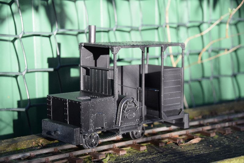

Posts: 6051
Post by philipy » Sun Jan 30, 2022 9:39 am
I think, I can see the light at the end of the tunnel now, I can't believe how long this has taken me so far. Hopefully not too much longer now though. These were taken this morning ( that strange glow is something that I am reliably informed is called "sunlight"?)
Still awaiting fitting of the engine and associated pipework, dome cover, whistle and bits and pieces which are mostly currently in the paint shop, and crew, who are on the printer, and then of course the whole thing needs grottying.
SimonWood
Posts: 803
Post by SimonWood » Sun Jan 30, 2022 10:34 am
philipy wrote: Sun Jan 30, 2022 9:39 am I think, I can see the light at the end of the tunnel now, I can't believe how long this has taken me so far.
I can’t believe how little time has elapsed since Rik posted the photo and you having produced this superb model, with all the detailed research that has gone into understanding what the photos actually showed! It really does look terrific.
Posts: 5717
Post by Peter Butler » Sun Jan 30, 2022 10:36 am
It's a weird and wonderful thing you have created, Dr Frankenstein!!! I fear though you might fall out of favour when the reservoir is dug in the lawn.
Posts: 6051
Post by philipy » Sun Jan 30, 2022 10:58 am
Peter Butler wrote: Sun Jan 30, 2022 10:36 am I fear though you might fall out of favour when the reservoir is dug in the lawn.
Funny you should say that, I was wondering if I could get away with running a circle of track around the pond!
