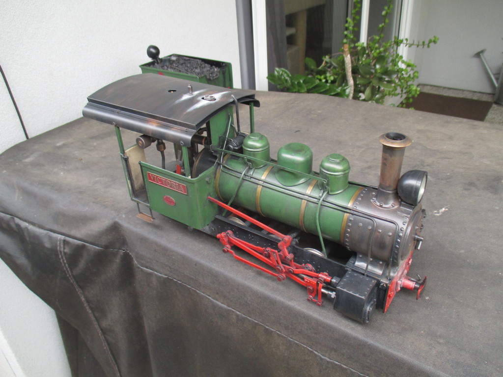

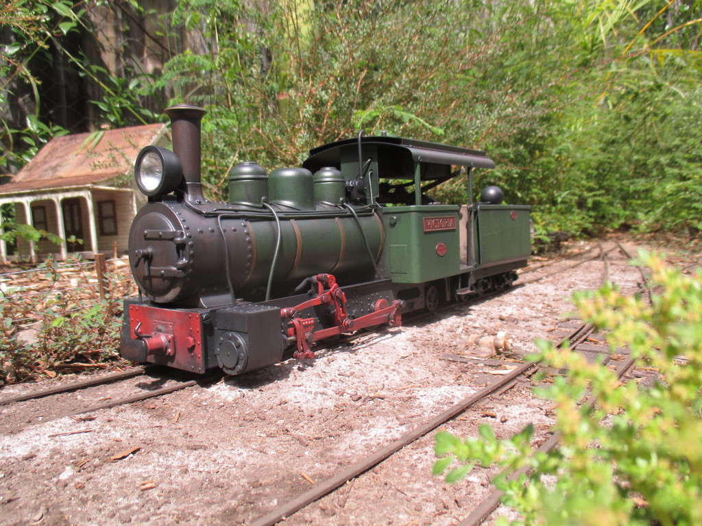

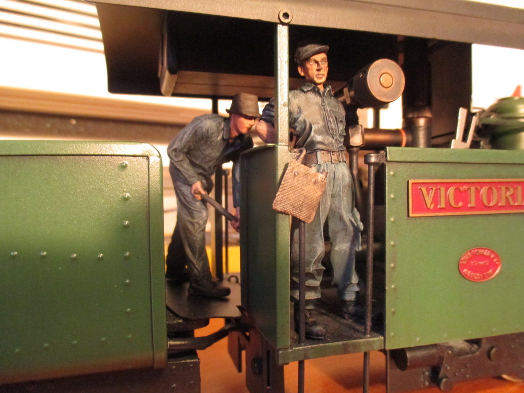

After finishing touch-ups some weeks back, a thick wash of dark (sooty-coloured) grey Tamiya enamel and mineral turps, with a tinge of brown, was brushed over a few square inches at a time. Then with a clean rag, wiped, swirled or dabbed off, leaving (I think) a suitably sooty, grimy residue. It was applied to every nook and cranny including the interior; for which of course the roof was removed. Should've done it before refitting the controls, it would've made for a faster, easier and better result.
It's not the best photo, I should've taken the loco outside first. You'll notice there's a fair amount of lint on the surface - that was from the rag I used, and it's both difficult and time-consuming to rub away. Next time, I'll try using paper towel instead; failing that, I'll bite the bullet and buy some lint-free rags for this express purpose. After a few days to dry, the entire loco and tender were sealed with the earlier-used satin clearcoat. The motion, smokebox and a few other spots will need another hit of wash tomorrow.
The water valves/hoses were painted during touch-up, before the wash-n-wipe treatment.

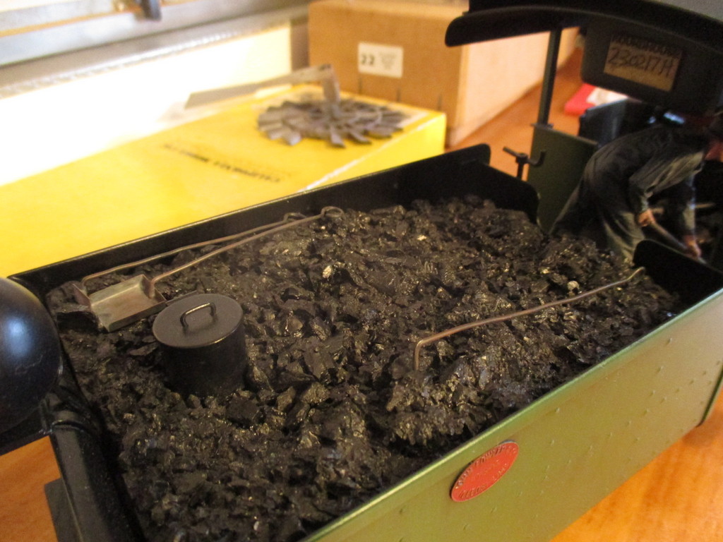

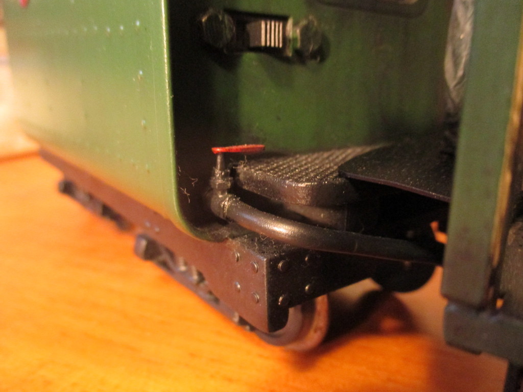

Recesses to accommodate tiny magnets, were cut into the crewmens' boot soles, by offering them up to an end mill spinning in the drill press. After that, the fireman was painted. Fitting the crew around the controls was tricky; they don't quite face the directions I'd like, but they'll do. Magnets were fitted under the footplate to hold the driver in position. Under the fall plate however, there's not enough room to fit magnets for the fireman. Consequently, the brass fall plate was replaced with steel, and I'm hoping that'll be enough to hold the fireman in place.. The water bag is a very nice casting from Ozark Miniatures; I bought enough to equip all my current and planned locos. You may notice the pony wheelset hasn't been re-fitted - I don't want it swinging about and chipping it's own paint off against the cab steps. Refitting it will likely be the very last thing on the list.
The fire irons were fitted, having been made from brass sheet and copper wire over a year ago. I forgot to apply the grime wash to the water hatch, so it's on tomorrow's to-do list..

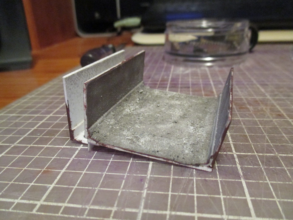

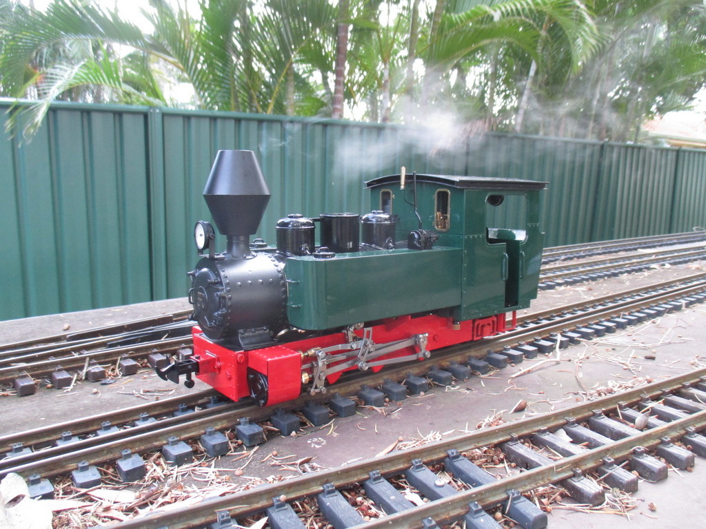

I was going to follow on from the previous work with some more grime-washing, but found one of the ashpan lights wasn't working after re-wiring the tender. Investigation revealed the issue was with the loco - one of the wires had broken away from the plug under the fall plate. I'm not proud of my original ashpan and wiring, so as the broken wire was to be replaced, so too was the remaining wiring and the ashpan itself. Which were all glued into place and had to be pried out. :scratch:
Normally, when I examine someone's past workmanship and think "who the hell made this sh*t?" it's on a full-size sugar mill loco, not a model one I did. :roll:
A few hours later, I had the ashpan that should've been made in the first place. I figure loads of us put battery holders and servos next to boilers and under footplates, so a styrene ashpan on a gas-fired loco will be fine. It's removable, too; held in place by the pony wheel frame. I'll have to make a washer from shim brass to act as a bearing between ashpan and pony frame. Working in small sections, superglue was applied and sprinkled over with ground-up ash and clinker from a 7¼" ashpan. A bit of weathering powders were also helpful in giving the sides a dusty appearance. A quick spray of Tamiya flat clear then had it ready to go.

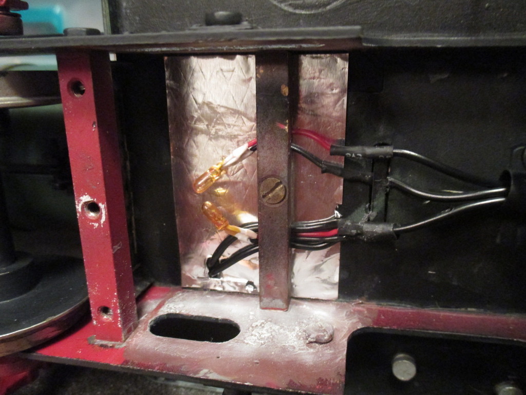

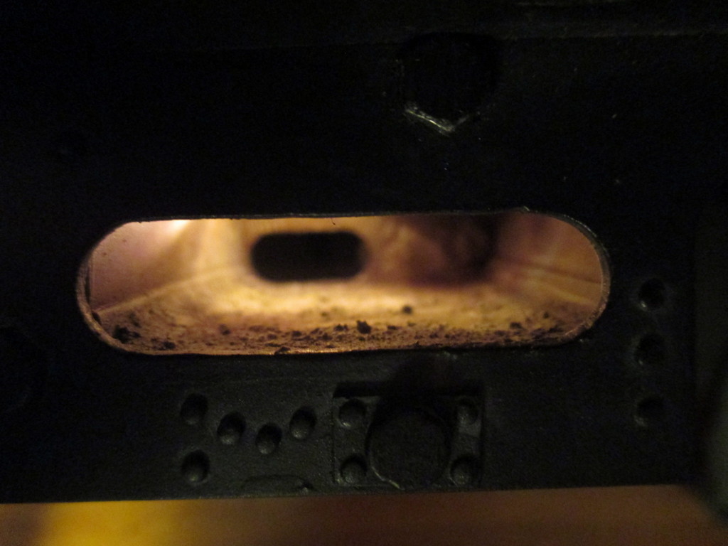

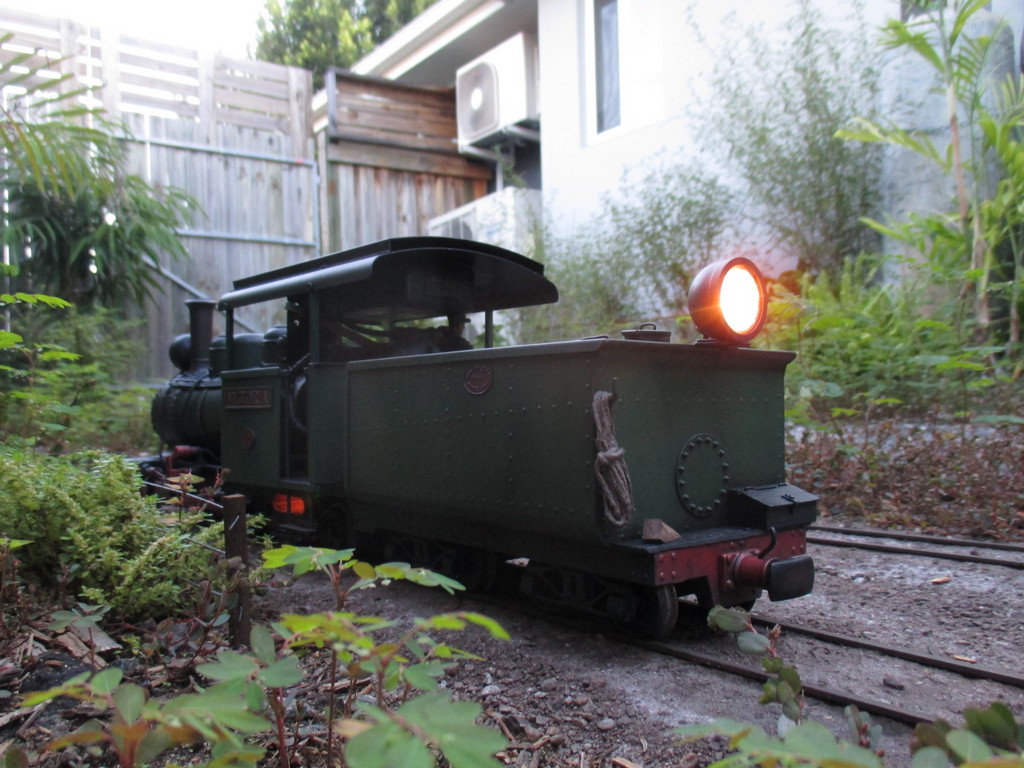

The new wiring is in, held in place only by the frame spacer. An alfoil "reflector" was tacked into place by a drop of cyano in each corner, in hopes it might make an improvement over the somewhat dim output of the old setup. Bulbs were replaced for peace of mind, and just as last time, they're just 3V grain-of-wheat, coloured with Tamiya's Clear Yellow tinted with a little Gloss Red.
The result is a little brighter than last time. Not perfect, but if your face is any more than 6" away from the loco, it looks fine. Since taking this photo, I did dry brush a little more red over the bulbs to adjust their colour. Ideally, I'd remove the frame spacer and use larger bulbs; but the cab and boiler are fixed to the chassis through that spacer.

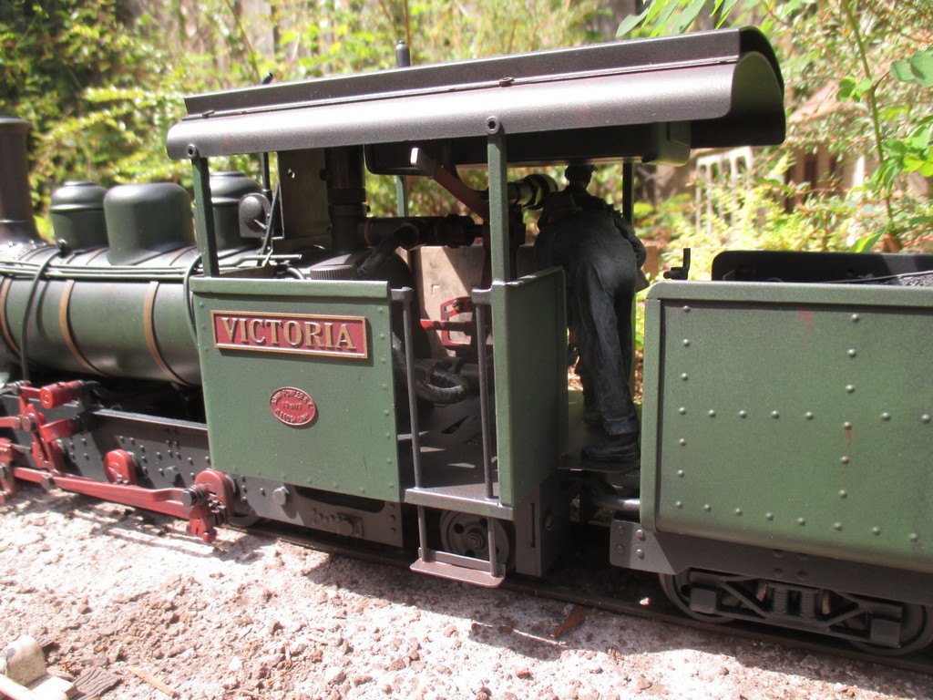

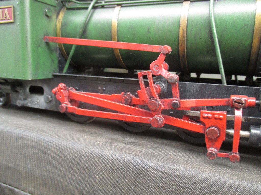

I could then get onto the second hit of grime-washing and whatever else was needed. Used paper towel to wipe it off this time, instead of a rag. Left only a few traces of paper fiber to brush away.. A darker, less-thinned grime was mixed and applied to the motion's joints and pivots.
After that, powders were applied where needed - "rust" on throatplate, cab steps, roof, smokebox and chimney, "snow" around whistle, safety valve and ashpan openings. Looks a bit stark in places right now, but the clearcoat will tone it down a fair bit - in fact I'll certainly have to come back and apply more powder..
Excuse the paint worn from the buffer head; I'm handling the loco by that and the cab roof's underside. Painting the buffers will be one of the very last jobs..

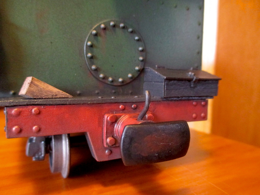

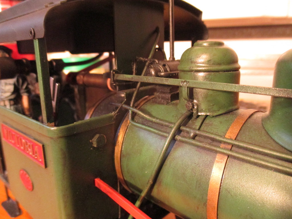

The loco is very nearly done. The buffer heads were painted in the usual way, by rolling and dabbing cotton buds, dipped in black, white and brown enamels. A few rivets and the smokebox/chimney received some dry-brushed rusty streaking. And a chock was added after I found it laying in the box of parts for this loco.
Something I did some time ago but never mentioned, was to put an M3 thread on the end of the drawbar pin. I found the drawbar had a tendency to drop when visiting some bad trackwork, leaving the weight of tender and train, hanging from only the wiring connection to the loco. (I've just realised this is partly why the wire broke off right at the plug.) A washer and hand-strength threadlocker should prevent any loosening..
At the same time, the piston rod glands (which were removed when the loco was stripped) were replaced with the graphite string supplied in the Roundhouse servicing kit - they've been left loose and will be nipped up under steam. Some steam oil was worked into the cylinders and valve chest by capillary action, by backing the gland nut away, and touching a flat-blade screwdriver dipped in oil against where the rods enter the cylinders and steamchests. This was repeated a few times, and the rods worked back and forth a bit to help draw and spread the oil inside. The motion was sparingly lubricated with 20w50 engine oil in the same way, and gently freed-up. Trailing and tender bearings were also oiled. I really need to buy some needle-nozzle oil bottles for the works.. :roll:
Although I can't steam test the loco until the 4th of April (just want to give the airbrushed enamel time to cure before exposure to hot oil) I can at least take the ex-works shots, and look back at the saga this loco has been.
I'm extremely pleased to say that 2½ years after its initial completion, (and five years since first starting the project) "Victoria" is finally finished the way it was originally intended. :oops: Can't wait to see it on a string of wholestick trucks on the next "proper" tramway. :D

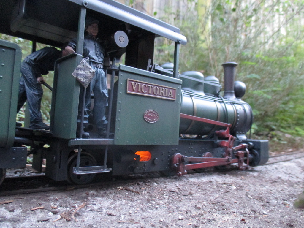

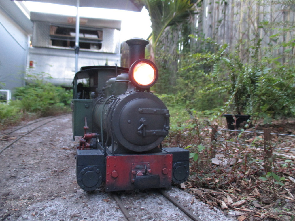

I found the ashpan lights and front headlight were untenably dim, when viewed outdoors in the evening. Checking the voltage with a multimeter, the 3V bulbs were receiving only 2.4V from the fully-charged pair of NiMh AAs in the tender. So I added a third cell, but didn't have a 3-cell holder - only a 4. So I just "blanked off" one of the cell spaces by soldering a wire across it. This did the trick, and all the lights now throw a respectable incandescent beam. 8) They should be fine on 3.6V, I think 4.5V was their limit.
The water bag is hooked over the side, and retained with a blob of blu-tac. Yes, I know the ashpan should have damper doors, but.. :dontknow: :roll:

Tony; Thanks, the rivets (dressmaker's pins) cumulatively took seven hours, and thirty 0.8mm drill bits! During the original build, a mate of mine did something similar on his loco, which soon prompted stripping down my own chassis, after I'd already assembled and timed it.. Shiny wheels and cylinder caps are a pet hate of mine too, especially given how easy they are to deal with - but each to their own, of course..

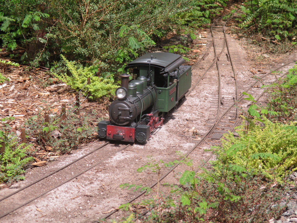

Tested "Victoria" on Thursday and Friday. Had the usual troubles filling the gas tank. You'd think it's warm enough in this country to not require pre-heating a brand-new gas can for every fill. :scratch: Clearly something isn't right, but it happens with all three locos I've steamed since late 2018; one Accy, two Roundhouse - even tried swapping the filler valves on the latter two. Also tried two different nylon gas adapters. All to no avail, who knows why this is.. Maybe I'm doing something wrong, though it's hard to stuff up filling a gas tank. Only thing I've not tried, is a different brand of butane..
Once the tank was finally filled, the loco was soon pleasantly simmering. One strange thing I've noticed, is that the clearcoat that gets hottest (on boiler, smokebox, domes and front headstock, yet not the cylinder cladding?) has turned to a satin finish. This is a bit weird, but I'm wondering if this isn't just off-gassing due to the heat, and my may rectify itself with time..
Worst case, I'll degrease it with alcohol and water, and take my chances with Humbrol flat clear :? - I used it on the Baldwin before I sold it, and it stayed matt under steam..

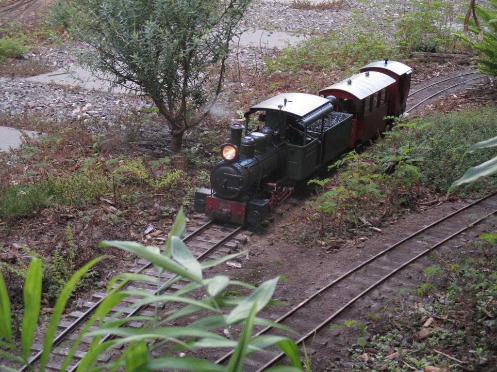

A light-engine trial up and down the elevated "yard" (tightening the cylinder gland nuts before they made a dribbly mess) was very successful, so I called it a day.
The next afternoon, a carriage and requisite momentum van were coupled on for a road test. "Victoria" behaved as you'd expect a Roundhouse, and I look forward to hanging a reasonable train behind it at the AMRA open day in Zillmere next weekend. (plague provisions notwithstanding)
As requested, I took some video. Please excuse the funny transition pacing, slight camera wobble, and my camera's annoying habit of dampening the audio when zooming. In time, I'd like to make better quality and more realistic videos..
