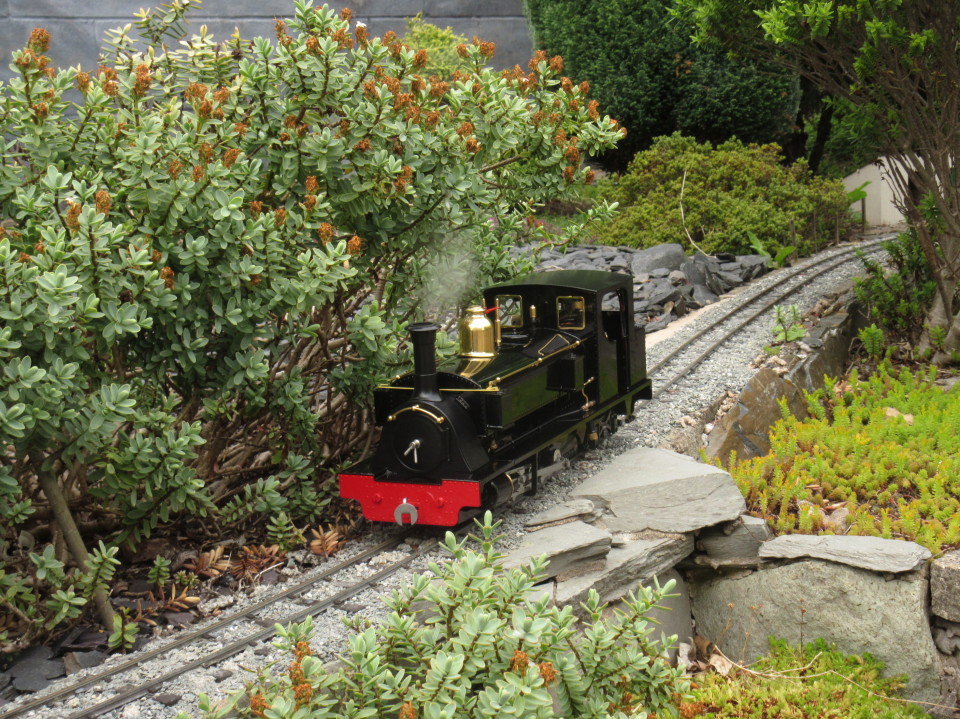

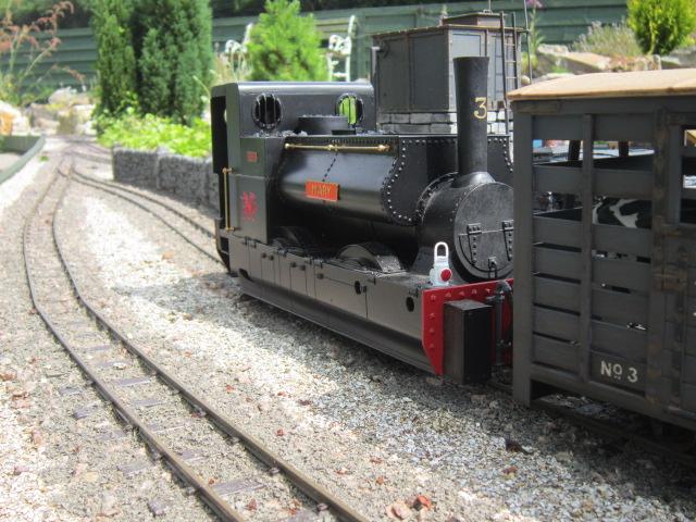

I have personal experience of using both SBR and grano dust as ballast with a great deal of success. My entire trackwork has been finished in this way and has withstood a few winters and regular wet weather conditions here in West Wales with no sign of failure. I fear though, this is not the best time of year to be undertaking such a project as the whole area MUST be kept dry for several days to allow the SR to fully set, even then it will show signs of what appears to be dilution, but not to worry about discolouration, it will settle in time.
Step 1.... choose a warm, dry day.
Step 2.... apply dry ballast material where you would like it to be when set. Avoid touching when wet.
Step 3.... drip NEAT SBR from a container with spout (eg. old PVA bottle) onto ballast without disturbing it and soak it well. All material must be completely coated as it forms a skin when dry.
Step 4.... cover entire area with waterproof sheeting and allow to dry, several days at least and as long as you can for best results.
Even after drying/setting it can look blue if it gets wet but this will disappear after a while without affecting the bond. As you can see in the picture above, it works well and looks good too!
I hope you find this useful... it works for me.

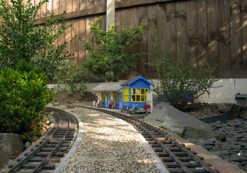

I have used SBR and pigeon grit to surface a number of platforms on my Crowfoot Light Railway. (See www.crowfootlightrailway.webs.com especially the STATIONS page for photos of numerous uses of SBR for this purpose)
See below is a shot of the platform on Bramley Bank where jigstone platform edges border a shallow mortar infil and finished of with about 1/2" deep pigeon grit and SBR. This platform and similar ones elsewhere can be walked on with confidence.
Best advice has to be to use it on a solid base such as mortared brickwork or stable concrete etc.
Don't use SBR unless you are sure your track is where you want it to stay.
Apply it like the small scale modellers apply PVA but don't worry about the washing up liquid.
Apply a small amount of SBR onto the base before placing the granite chippings. Dampen the chippings and place them as required.
Apply SBR one drip at a time and watch the white liquid spread through your granite chippings. To help it along try misting some water onto the top of the chippings and SBR. In time the white liquid will change to almost clear but don't mist on too much water especially on non flat areas as the mix will flow downhill before it dries properly.

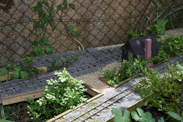

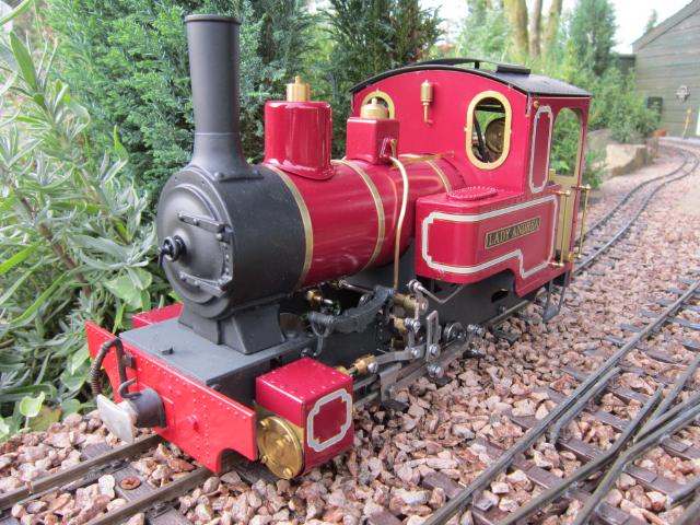

We all make mistakes, practically everything I know was learned that way! On this subject my first was to use horticultural grit which, despite being sieved, was too large for the SBR to bond and, following a winter and the following wet season.... It all fell apart.
The next fail was to have a thick layer of material and too little SBR to penetrate to the bottom causing it to separate and break up.
At last I managed to get it right by keeping the fine ballast to a minimum, soaking well with neat SBR and protecting it from wet weather for as long as possible. Success!!!
This shows the horticultural grit...
Final solution as described above...

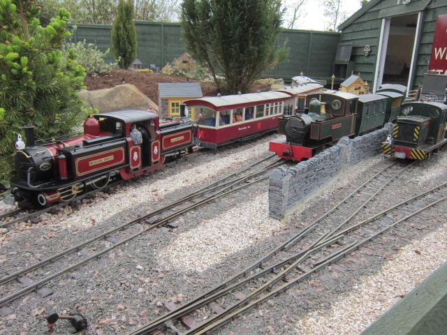

Well today I've ballasted a little trial area in the steaming bay at Afallen, using recycled old ballast recovered from previous track work and crushed back to size. I applied the SBR using Peter's method, and after doing this in the morning, when I went out to check it around an hour and a half ago it had already pretty much set hard. I covered it over with plastic sheeting as the forecast that had just been on the TV was predicting imminent rain and sure enough it is raining now....! I'll see what its like when I'm next back here in a couple of weeks.
- Posts: 5713
Re: Using SBR for fixing ballast
Well done on making a start and being careful to protect it against wet weather.... Summer aint here yet!
Two weeks will be sufficient to prove the system you have followed. Please let us know the final result.

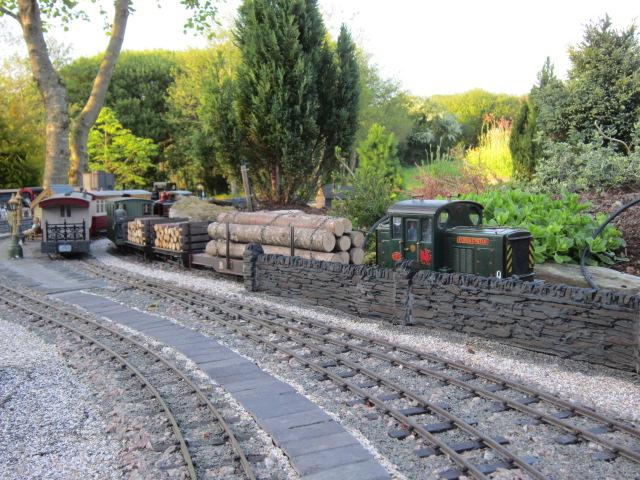

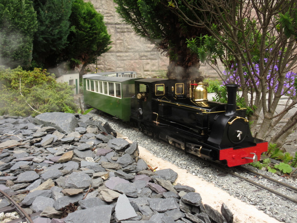

Well I've been (very) slowly working away on re-ballasting the Afonglas and Nant Llwyd Railway and true to form I've found my own method for ballasting. I lay down the grano dust ballast completely dry, but then spray it with a water and PVA mixture (plus a drop of washing up liquid). After this, I then drop on the SBR using a large syringe with a length of tube on the end. The dampening first means that the SBR spreads into the ballast much more quickly then it does straight onto dry ballast. I must admit I am quite generous with the SBR, as it seems to dry really quite quickly, especially if done on a warm, sunny day. I then cover it over, although whenever I've given new ballast an exploratory prod after a few hours, it always seems to have been set hard already.
Anyhow, the upper balloon loop has now been about 2/3rds done, and all of the new ballast has stayed exactly where I put it, a vast improvement. And going back to the start of the thread and the reason for the revival of my railway........ well it arrives on Wednesday (but work means I won't get to show all until Sunday at the earliest).

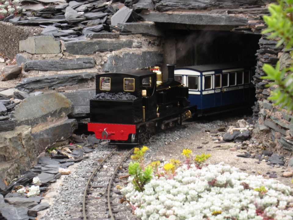

Well, here we go, a picture of one of the re-ballasted sections of the Afonglas and Nant Llwyd Railway.
And the reason for the work? Well, its in the photo too. A beautiful black Roundhouse Beddgelert has joined my fleet, after being ordered at the end of February. It arrived at my parents last Wednesday and returning home for my weekend allowed me to steam it for the first time on Monday 12th June. I've wanted one of these since I first saw one at an Elsecar show, the reason for choosing black being that I like the 12 1/4 inch gauge version at Fairbourne which is black, and nearly everyone seems to get one in red!
A couple more pictures of the ballasted track and Beddgelert, I think both look rather well.
