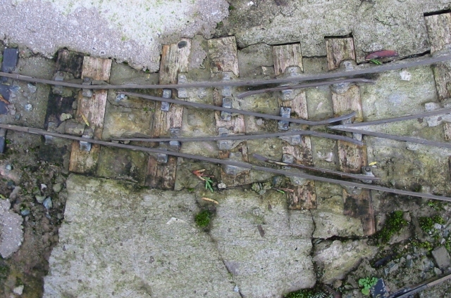

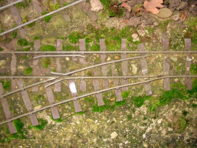

In my early days, around turn of century, I made extensive use of fixed points.
Most were scratch-bodged form plain track split and joined.
Before taking the Dremel to expensive points, see these pics:-
[attachment=1]MRPOINT01.jpg[/attachment]
[attachment=0]MRPOINT02.jpg[/attachment]
These were made from Tenmille track.
That seems to be my limit for posting pics.
Will try next post

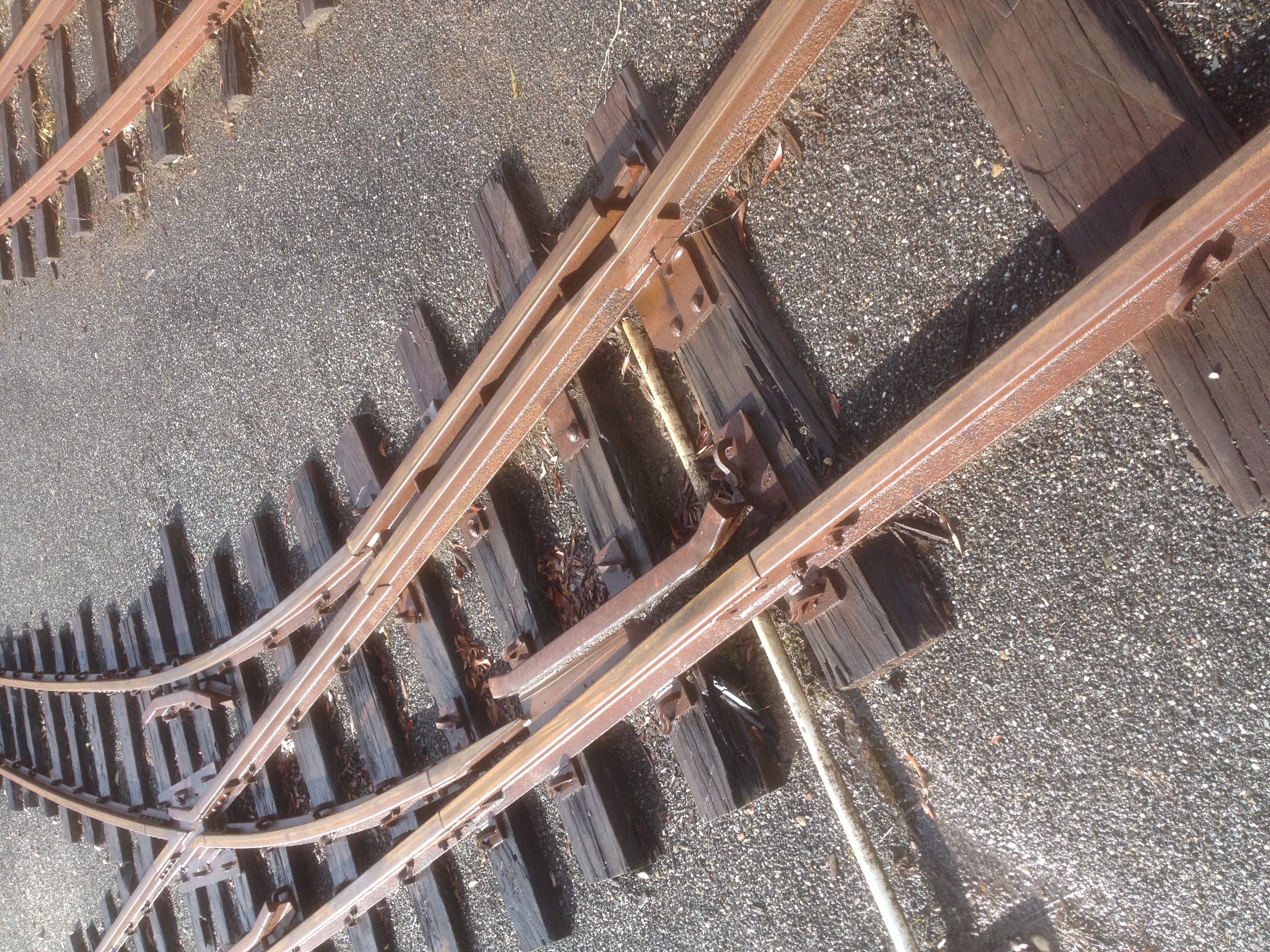

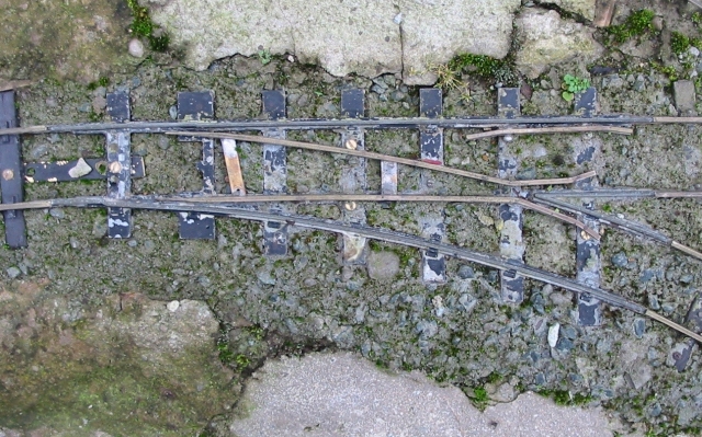

These are from Peco track:-
[attachment=1]MRPOINT03.jpg[/attachment]
[attachment=0]MRPOINT04.jpg[/attachment]

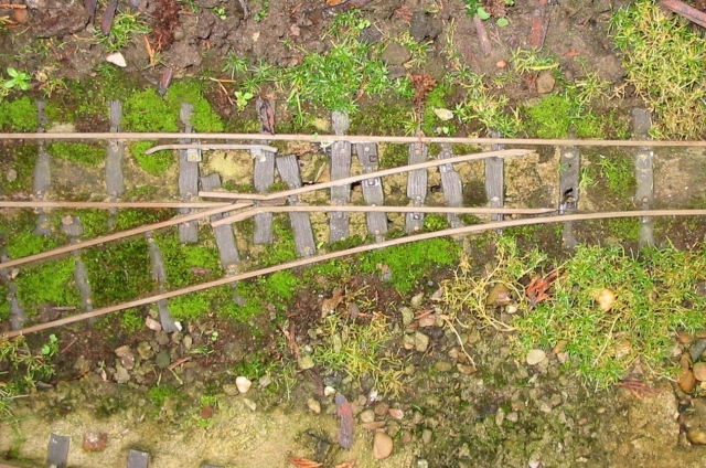

Scratch built on wood sleepers, and short-lived:-
[attachment=1]MRPOINT06.jpg[/attachment]
and one from Mamod track with Peco rail for "blades":-
[attachment=0]MRPOINT05.jpg[/attachment]
These all worked well for several years.
Snags occurred when visitors felt the need to run wrong road.
Then Peco introduced their small radius points, which I fitted with return springs.

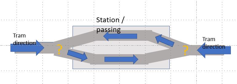

re-opened the case with title TRAM turnouts .. didnt know topic was here
Hello MRAIL Looks like you are real TRAM fan : No I wont accept spring points
Looks to me as if real modern trams have invented a unique and ingenious way of doing this Single track to double passing point
NO moving parts. Nothing up their sleeves
From all the pics here I still dont understand how this can work How the the wheel flange is actually directed according to direction ?
Can anyone make a diagram with a picture of a real one showing hwo the flange is directed with arrows ? ( both ways )
Meantime I have written to some industrial tram companies to see if they can give guidance . Let you know if it comes up trumps I am determined to build them for my tram layout.
here is the puzzle again

Hi chaps,
This latest diagram appears to show Y points at each end of the passing loop.
This would be conventional practice for tramways.
The system I used depends on the tram/train approaching the loop on the straight, and continuing straight ahead.
Exiting the loop is on the curve.
This format of passing loop was once known as "thrown over".
[attachment=0]OpenLoop.jpg[/attachment]
Persuading the vehicle to take the curved approach would be a challenge.

Does anyone know / have links to/ could possibly be allowed to visit the track > recent real tramway / light rail designers To ask them the design of these special passing point track diverters
I am a newbie Wanting to make a tram layout Londoner I look at the newish real Croydon Tram link .
II look at at those trams going single track to passing point stations I cant get close enough to actually see the cross over network in detail
But there is NO hint of any track side control apparatus on these "points" Whether or not there is some moving part in them> surely doubtful.
The maintenance cost of such would surely provoke a fixed solution to send on tram one way .. Plastic drinks bottle stuck in the track etc etc
I have tried to contact modern tramway designers as my best hope to find out the truth. Sadly none have responded Can you help ?
Here is a link to the most excellent amateur documentary of that network now running . Alas the guy who researched it all has died It is very well worth a look
https://www.croydon-tramlink.co.uk/
I did make my own system added a moving flexible joint ( just one). Worked fine but this cannot be the real world solution ?
google earth doesnt come anywhere near close enough to see.
ciao spaeker
