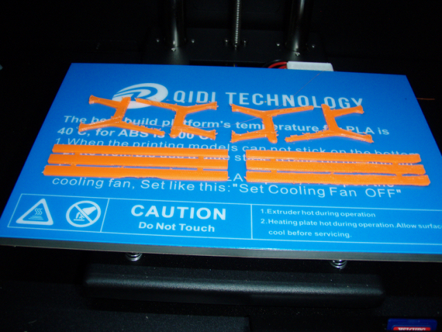

Friday teatime I ordered a QidiTech printer from Amazon. It arrived just before lunch on Saturday. Took me most of the afternoon to get it up and running, due to a problem which turned out to be a clogged filament feeder, due to a small piece of filament presumably left from the factory test run. Saturday evening did a couple of test prints of small solid blocks, as recommended by the manufacturers. Then this morning decided to go for it! One of the drawings I did was for a station platform seat, no particular prototype, just a fairly typical cast iron support, wooden slat bench. The easiest way to print is flat on the print bed, but I wanted the typical raised edge ribs on the cast iron, on both sides, so I designed it as a kit consisting of two pairs of mirror images for the legs and two sets of slats. I only had to draw it once and then duplicated and mirror imaged, thus ensuring that both faces of both legs should be identical.
This is the drawing: Using the reel of PLA filament that came with the machine ( No, I did NOT ask for Fluorescent Orange!!) and the basic settings which were suggested, I set it to run this morning. Took about 1.5 hours to produce this, just finished and still on the print bed:
There were a couple of problems with the print, the RH end of the RH slats lifted and deformed slightly and the filament got caught by the nozzle for some reason on the LH set, but overall I was pretty pleased with the way my drawing actually printed, for a first effort.
It took a few minutes to clean everything up and then could glue the kit together. I wasn't sure what to use but I soon discovered that PLA works nicely with Plasticweld, so that problem is solved. Once cleaned up it was only a few minutes work to assemble the kit:
To be honest, I should have taken a few minutes more to fill some small gaps between the two halves of the legs, but I was impatient to see how it looked when not bright orange! So out with the grey primer followed an hour later by a blast of the Company standard green, and Hey Presto....

I've spent the last couple of weeks playing at drawing things up, to be reasonably comfortable that I would be able to print my own stuff not just library drawings. James uses the Microsoft 3D Builder app but personally I find SketchUp easier, but each to his own.

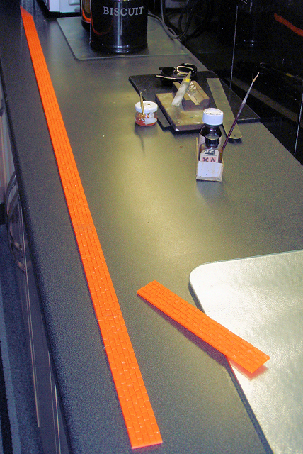

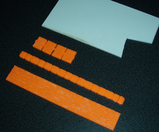

OK, as threatened, progress so far on a station platform.
Basically there are 4 components, one of which is a sheet of 3mm white Foamex which I just happened to have from years ago.
Then there are three 3D Printed items: Stone platform face, Front edge slabs and Rear edge blocks. The front face is 200mm x 30mm, with 5 courses of stone and the ends match so that adjacent sections can be either way round to reduce the 'pattern repeat' effect. To further help this I actually created two different versions, by simply copying the original drawing and changing the shape of a few blocks, the net result is that it should be 4 sections ( 800mm) before the same orientation is repeated, although in fact I just used them as they came.
The front and back edge slabs were simply glued to the top of the stone faces using Plasticweld which goes off instantly and then,, with the Foamex cut to shape, the L shaped faces were Gorilla glued to it. Finally some strips of Foamex were glued underneath to avoid any future warping.
The PLA filament dissolves easily in Plasticweld, as I said, so I made up a glop of bits dissolved in it and used it as filler/strengthener across the joins on the back of the face sections.
I discovered one benefit of 3D printing that I hadn't thought of previously. We've all had the issue of running out of something just before finishing a project, I'm sure. Well, I discovered that I was short of about half a length of a back edge block strip, so, nip out the garage, select right drawing on the SD card, press print, and 40 minutes later I had what I needed!
Painting is the next step, followed by planting in situ, station building, etc. So I'll update as and when.

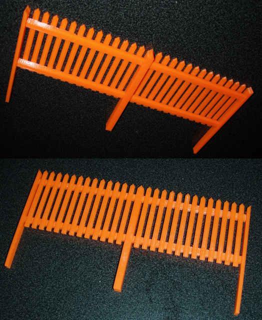

Latest off the printer are the platform fence units. Pic shows one 200mm unit front and back. Based on M&SLR drawing available on t'web. Just shortened the palings a little because they looked overpowering on my narrow platform, and adjusted the panel length to fit without an odd bit.

Those picket fence modules are superb Philip, and totally weather proof as apposed to making up from timber too. 10/10 Mate!

Phillip - thanks for sharing your journey in 3D printing - I'm really enjoying it - I've downloaded Sketch Up for my Mac - are there any good tutorials own youtube you'd recommend with the model maker (rather than architect) in mind??
Love the fences and as you said, aside from the costs, the key advantage is getting something that you exactly need

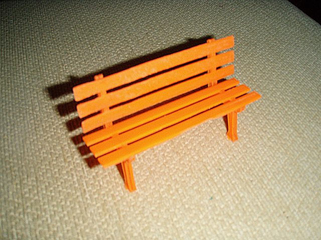

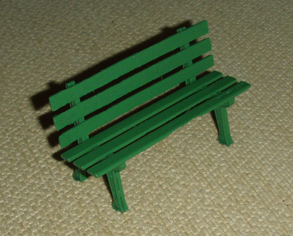

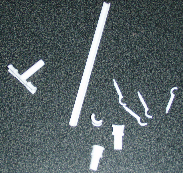

Whilst waiting for some paint to dry ( literally) I thought I'd have a go at a subject that always bugs me when making a building - Rainwater Goods. It's such a basic item on a building and yet the trade offerings are pretty much non-existent as far as I know, apart from some undersized stuff from one of the German plastic kit manufacturers.
I'm fairly pleased with my first attempt, although it does need more work on the drawings to get the bits to mate more neatly, and obviously need to draw up the downpipe, swan necks and brackets.

When you have perfected those put my name on your list of potential customers..... as you say, difficult to source and fiddly to make.
