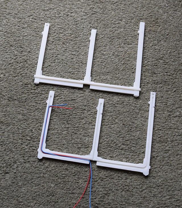

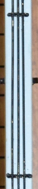

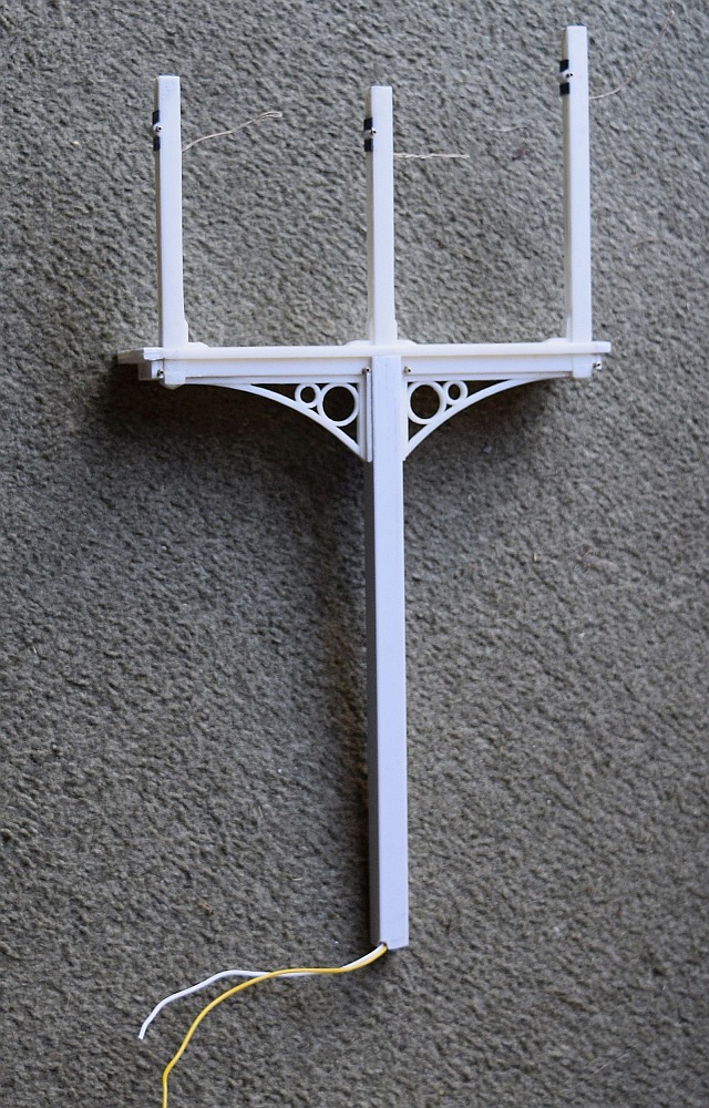

I decided that I would 3D print the gantry, top posts and fancy support brackets as one pair of items, a front and back, but this didn't work because the dimensions would only just fit on the printer's build plate and I had adhesion issues at the extremities. So I removed the support brackets and finials from the drawings and this gave me just enough leeway for it to work. Tbh, they were not my finest prints even so, but some filling and filing sorted them out.
The other thing I did was print a groove in the centre of the posts and gantry. I had noted in Rik's blog that he commented on not thinking soon enough about power supplies for the lamp LED's, so I designed in the internal cableways from the beginning and then laid in the wiring before gluing the two half's together.
DSC_0042 small.jpg (299.58 KiB) Viewed 17882 times

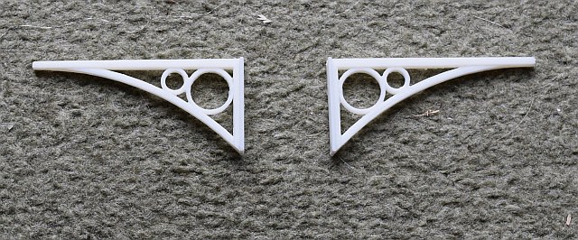

The brackets were then printed separately, again as front and back pairs.
DSC_0046 small.jpg (151.82 KiB) Viewed 17882 times

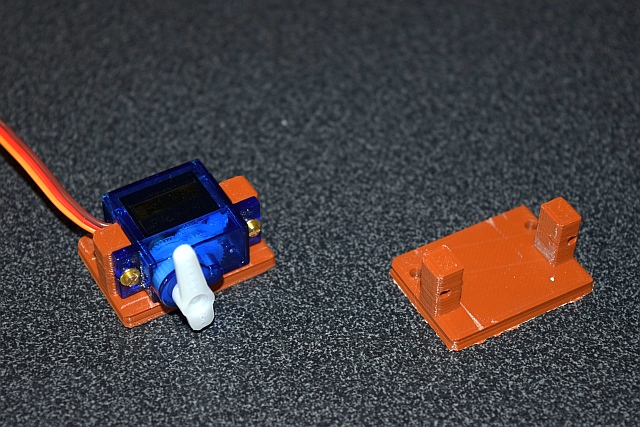

Whilst working on the turnout servo's previously, I had designed and printed a servo mount :
DSC_0016 small.jpg (233.61 KiB) Viewed 17820 times

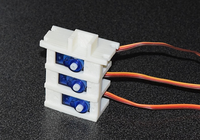

and now a bit of playing around with Sketchup gave me a nice neat stack of three, one above another and each offset sideways by about 2mm, plus a mounting socket for the signal post correctly positioned above to hold everything in line with minimal deflection. As an unplanned bonus it also subsequently allowed the whole thing to stand upright whilst working on the rest of the signal.
DSC_0014 small.jpg (209.33 KiB) Viewed 17820 times

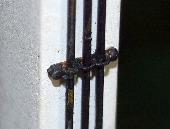

Next came the bit that I had been slightly dreading, the cranks to transfer the up and down rod movements sideways along the bracket and then again vertically up each post.
I worked out that each crank arm needed to be about 6mm from pivot to pivot with arms about 2mm wide and at least 1mm thick for mechanical strength. I didn't fancy trying to cut and drill 4 of those from sheet and in the end I got a length of 1.5mm brass rod and bent it to the shape of the 4 cranks, plus a couple of spares. I then beat it flat with a hammer on a block of steel. It was simple then to drill a 0.8mm hole at the bend of each and a crude jig, consisting of pins hammered into a block of wood, to get the holes all the same distance apart. I used pieces of 0.8mm brass rod for the crank axles and these were soldered at right angles, again using a hole in a piece of wood to hold things square.
Unfortunately I forgot to take pictures of this process but this is a detail of the cranks in situ:
DSC_0030 cranks small.jpg (80.07 KiB) Viewed 17820 times
For bearings, I cut short pieces of 1mm ID brass tube, drilled holes in the signal and inserted them, fixing in place with a tiny smear of Gorilla glue. At this stage the cranks were just left loose in their bearings whilst I worked on everything else. More 0.8mm brass rod was used to form the linkage rods and the holes in the cranks eased to allow nice sliding fit. Working slowly, I found it wasn't as difficult as I had feared and somewhat to my surprise, jiggling the bottom of the main rod caused the top of the upper one to mirror it! The brass rod came in 250mm lengths which wasn't long enough for the vertical centre arm rod, so I had to join that one with a short piece if the 1mm tube. I made a dummy signal arm out of styrene for testing purposes, just using a pin for the axle, running in a bearing tube glued into the post. I had printed integral bearing housings on the sides of the posts and the holes just needed carefully opening to fit. You can see these on the pictures posted yesterday.
Now came the moment of truth - connecting the vertical rods to the servo's! I Confess that it wasn't easy to get them set up and I had to rebend the bottom of the first rod a couple of times. The servo arms are located on their shafts with small splines and of course they were always just not quite holding it where I wanted. The other problem I found on the long vertical rods was that the mechanical resistance in the system caused them to flex when being pushed and they clearly needed to be restrained.
In the 'bits box' I found a length of 1.5 x 1.5 T-section brass and I drilled 3 x 0.8mm holes in the leg of the T, at 2mm spacings. I then carefully opened these holes out to get a loose sliding fit for the 0.8mm rod. A 10mm long piece was cut off and 1.5mm sections filed flat at each end, and fixing holes were drilled in these flats. This triple hole guide was then slid onto the vertical rods and pushed up the post to the centre.
DSC_0025 guides small.jpg (186.67 KiB) Viewed 17820 times
Just holding it in place with a finger and operating the servo's, showed that it worked and did restrain the rods, but somehow it didn't look quite right, and I decided that it actually needed two of them, so I made another! Whilst on the post I drilled through the fixing holes and loosely inserted pins to hold them until I was ready for permanent fixing.
DSC_0030 2x guides small.jpg (100.92 KiB) Viewed 17820 times

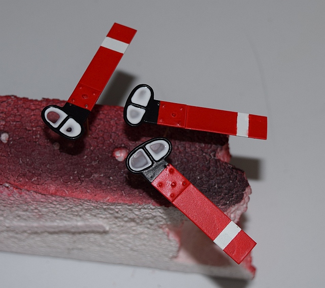

The proper signal arms were next made of brass and nickel silver sheet ( I happened to have a small piece of the right thickness N/S) basically following Rik's method from his blog, but I used brass rod rather than copper wire for the spectacles. Getting ahead of the timeline for a minute now, for the spectacle 'glasses' I had originally intended to use coloured acetate sheet, again as per Rik. However I found a very ancient pot of 'KristalClear" in the cupboard which, with a small drop of water added, proved to still work, so I used that. For anyone who doesn't know it, KristalClear is a very refined PVA which as it's name suggests, dries completely transparent. All you do is dip a cocktail stick in the white liquid and wipe it round the inside of the frame to wet it, then drag the stick flat across the opening in contact with the edges, and it leaves a thin film behind, right across the frame.
DSC_0005 small.jpg (200.45 KiB) Viewed 17820 times
Leave it for an hour or two and it dries to a clear film. These can be coloured using permanent felt tip pens. ( I also did a partial experiment, and I think it might be possible to use ordinary PVA glue to achieve the same effect for signals, where it doesn't matter too much if the 'glass' is not completely transparent).
DSC_0029 coloured glass.jpg (413.15 KiB) Viewed 17820 times

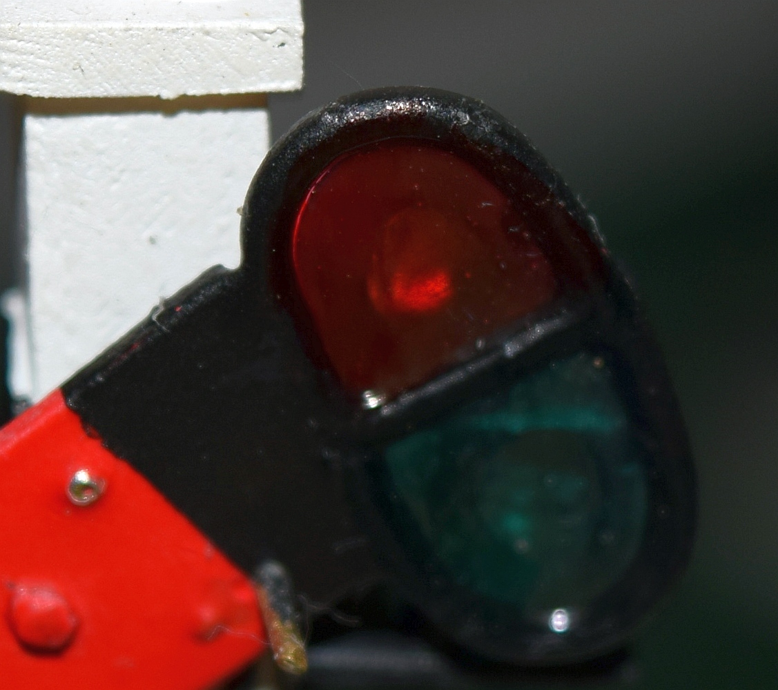

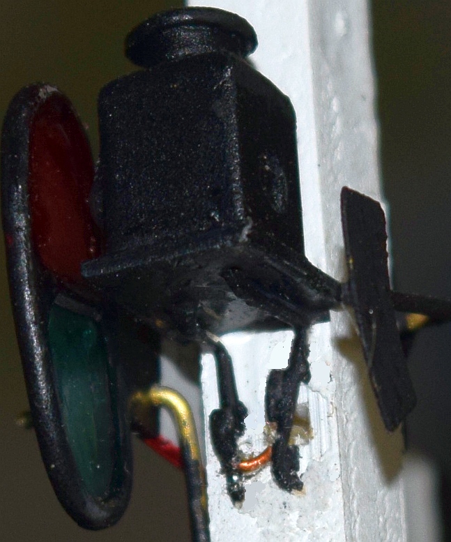

The signal lamps were made almost identically to Rik's build method, with 3 exceptions: 1) I used some 'warm white' LED's running on a low voltage, rather than the flickering candle type. 2) I used rapid set clear epoxy to fill the inside of the lamp bodies rather than Bostik. 3) I used the legs of the LED's as brackets for the lamp shelf. Once the epoxy is set, it's a simple matter to bend the legs to the correct L-shape under the shelf and then put a small additional inward bend at the bottom to plug into 2 small holes drilled in the signal post, either side of the opening from which the wires exit. These power supply wires were then simply soldered to the adjacent legs/brackets.
DSC_0003 small.jpg (279.52 KiB) Viewed 17771 times
(Having seen this rather cruel closeup, I think the paintwork needs some attention!)

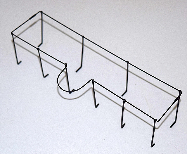

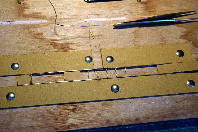

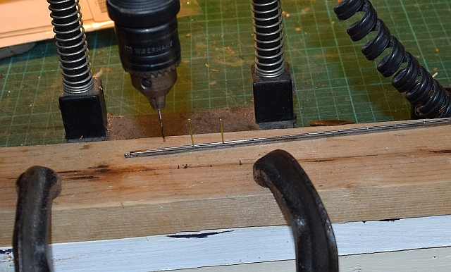

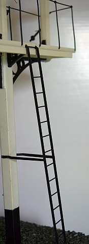

To construct the ladder, I gave a thorough clean to a length of rail twice as long as the ladder, and tinned one side. It was then folded in half with the tinning inside and the soldering iron applied in 2 or 3 places along its length to tack the two sides together. Using my Minicraft drill in it's vertical drill stand I put a 0.8mm hole through the rail webs near one end. I then moved it along by the rung spacing distance and drilled again. I knocked a pin through the first hole into the wood underneath and moved the rail along so that the second hole was on the pin, ensured that the drill was lined up in the web ready for the 3rd hole and put another pin through the first hole. I then drilled the 3rd hole, moved the rail along so that the next pair of holes were on the pins and drilled the 4th hole, etc.
DSC_0002 small.jpg (215.12 KiB) Viewed 17771 times
All the drilling took only a few minutes. I used the soldering iron to split the solder tacks and and then cut the folded end leaving 2 identical ladders sides. I decided to pre-cut the rungs from the 0.8mm brass rod, so I drilled a hole the correct depth into a piece of wood and simply poked it in and cut off flush, until I had enough. A simple jig was made of 2 pieces thick card drawing-pinned to a piece of wood at the correct distance apart, with removable card spacers to keep the sides from accidentally moving inwards during soldering.
DSC_0004 small.jpg (218.14 KiB) Viewed 17771 times

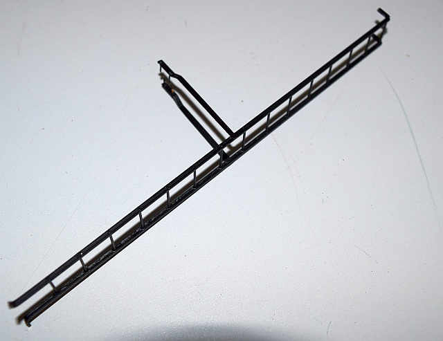

The whole lot was soldered together and then cleaned up. ( Psst... Tom, all done with an 18watt iron!). The tops of the ladder sides were bent over to sit into holes drilled horizontally into the edge of the signal platform, the bottoms were bent out sideways to create fixing anchors and horizontal stays were made to hold it to the post in the centre. These are soldered to the ladder and pinned and glued to the post. Including making the jigs it all took about a couple of hours, and I'm pleased with the result, which looks even better after a couple of coats of paint!
DSC_0011 small.jpg (185.18 KiB) Viewed 17771 times
The ladder was not fixed at this stage and removed for safe keeping whilst the rest of it was being worked on. Similarly the safety rail round the gantry which was fabricated from brass wire, and painted, but kept separate.

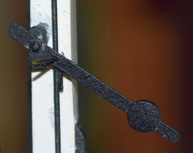

I had it in mind that the balance weight arms were missing from my grand design. Early on I did consider making them work as Rik did, but with all of the cranks and direction changes I was concerned anyway that play in the joints and rod flexing would mechanically smooth out the bouncing, and putting another three joints in the system might be too much. In practice this doesn't seem to be as much of a problem as I feared but who knows what wear will do in future. So, if they couldn't be made to work as part of the mechanics, I thought about cosmetic versions. I made arms and brackets in very much the same way as Rik's version. However the operating rod holes I elongated into slots. I then soldered small L-shaped pieces of 0.5mm brass wire to the vertical rods and slipped the slots over them before fixing to the post. The balance arm now goes up and down in tandem with the signal arm but the slot allows the rod to still move vertically instead of being pushed sideways which a simple hole would do, as it would follow an arc.
DSC_0004 small.jpg (255.06 KiB) Viewed 17771 times

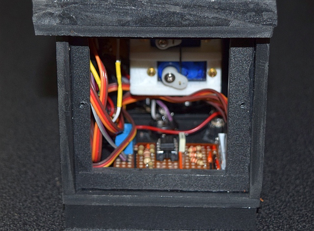

The next step was to build a box around the servo mount to hold a 4 x AA rechargeable battery pack, the Picaxe board, on/off switch, charging socket and a 3-pin DIN socket to provide a connection to the detector switches on the two turnouts. This box was constructed in 5mm Foamex board simply glued together apart from a screw-on access panel. The upstand on the signal post mounting socket at the top of the servo holder was deliberately 10mm high to allow for a 10mm Foamex top plate and everything else is screwed below that, again to allow for maintenance access.

The signal ladder and guard rails were finally fixed in place and that was just about it, job done.
DSC_0002 (1) smaller.jpg (102.61 KiB) Viewed 17759 times

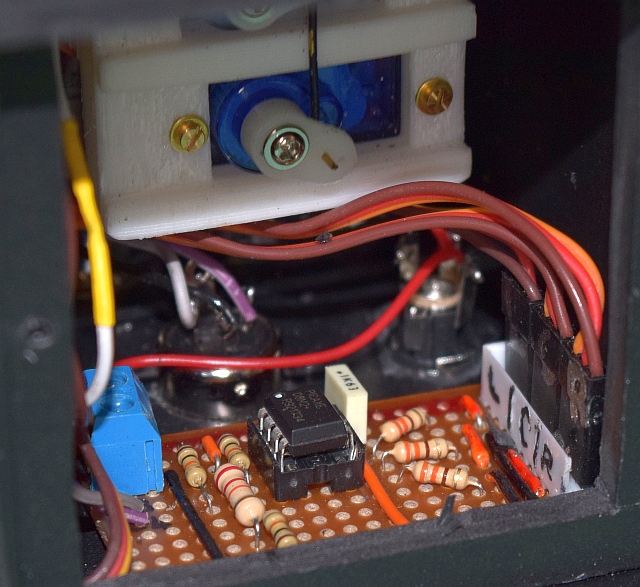

With the signal program working I could reclaim the Picaxe project board and 18M2 chip which I had borrowed from the turnout operation, but that meant acquiring a 2nd one to run the signals. The signals don't actually need the 18pin chip, an 8pin unit provides the the 2 inputs and three outputs necessary, so I decided that rather than spend Β£20 on an official board I would construct my own on stripboard from the info provided on the Picaxe site.
DSC_0003 (2) small.jpg (257.46 KiB) Viewed 17759 times
Since I had a working program it seemed as though it would simply be a matter of changing the pin numbers to match the smaller chip. It didn't take long to physically make the board but it took almost a week of real frustration to get things actually working, due to what seems to be an error in the Picaxe manual circuit. When I did get it working, I was correct in my original assumption, the program did only need the pin numbers changing!
Anyway, with the Picaxe now available, it was a fairly simple matter to install the servo's in the signal box in place of the original Tortoises.

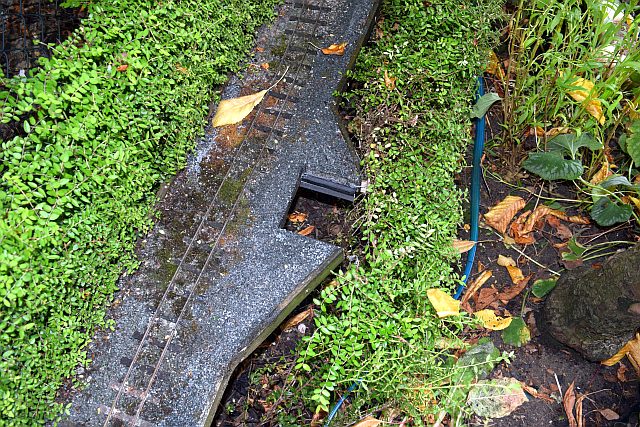

The wiring was already in place, as was the point rodding, and I took the opportunity to do some maintenance on various bits and pieces. At this point, a couple of days ago, I was also finally able to post the video that Tom asked for back at the end of May! For anyone who missed it on the other thread, this is the link: https://youtu.be/NP97X1lkO94

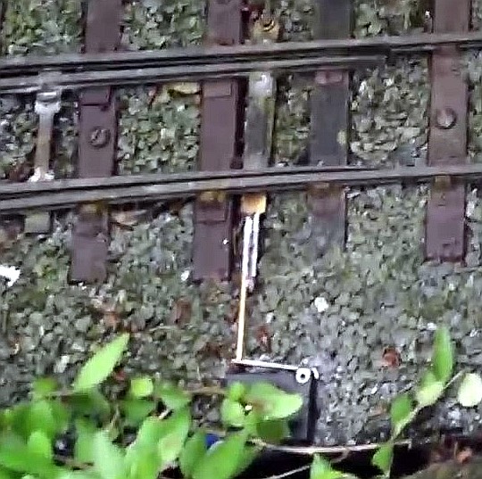

My original intention was to pinch yet another idea from Greg and fix magnets to the ends of the tie bars to operate reed switches which would detect when the point blades moved and provide the electronic input to the signal Picaxe. However I had difficulty in finding a reed switch that was sensitive enough to go on and off with the relatively small 4mm or so movement involved. Then I found some pre-wired waterproof microswitches which are exactly what is needed and ( assuming they really are waterproof!) should be reliable. It simply needed an extension on each tiebar to reach the microswitch at the edge of the ballast and they work fine, triggering the signals exactly as I had always hoped.
Turnout microswitch.jpg (116.98 KiB) Viewed 17759 times
