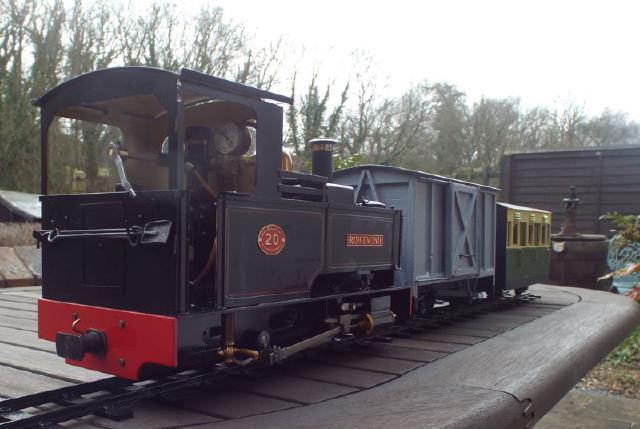

I've asked about janets in the mamod section and now for the ragleth questions.
i'm very tempted to get a "big" loco when funds allow (afte rwedding and christmas)
would a ragleth be a good big loco to get?
i love the look of them and i have both 32 and 45 lines that are available for me to run on so fits in with it being adjustable.
i dont mind running manual but would possibly have r/c fitted in the future.
so my questions are;
good points and bad points?
what are they like to run in manual?
any other info on them would be happily recieved
cheers james
cheers james

Hi, its worth pointing out i do not own a ragleth however (as said in a different thread) my mate does and despite him having problems with it it seems a very nice loco.
heres what i think are the good and bad points from looking at his and other ragleths:
Good:
Reversing valve gear
easy to fit RC
Good at slow running
Big Cab
Nice extra details like coal load etc
improving customer service
good value for money
You can fit a top up valve as the loco isnt filled by safety valve
Can change the gauge
Bad:
Made on a production line in china
company and service still isnt quite as good as roundhouse
very heavy loco for moving and pulling "dead"
to large a loco to suit most narrow gauge lines however does suit W and L or bowwater type lines etc
Seems a bit underpowered for its size but saying that can pull a decent train
cant really fit a water gauge
does seem to be a bit more problems that occur with them compared to other similarly priced locos
in my view though if your after a starter loco thats not of the mamod variety a ragleth offers good value for money and is certainly a big bulky loco. I personally chose a roundhouse Bertie because of there better proportioned size and ease of running however there wasnt much in it, one thing i would say though is that it seems a bit tedious changing the reverser all the time if the ragleth is in manual i find it much easier to just push my bertie and off she goes however I can easily see the advantage of having RC on the reverser (something a Bertie cannot have)
At the end of the day the choice is yours a ragleth is a very good loco but so are berties and millies

If you are looking for a big 0-4-0 loco then you will be pleased with the Ragleth's sizing compared to a RH offering.
I ran mine manual a few times before going about fitting R/C and was pleased with it's ability to run slowly when the regulator is set right although the line you run the loco on (particularly the radius on curves) and the amount of weight it is pulling will also have an impact.
R/C is easy to fit and plenty of places to locate all the required bits. I have even managed to get the battery, regulator servo, on/off switch and receiver in the battery compartment.
Other things I like about the Ragleth is there is a large choice of modifications available from suppliers both mechanically and cosmetically, it create lot's of smoke as it loves oil and you can pull it apart without getting paranoid about breaking anything or messing about with the timing.
Although the RH faithful might persuade you to buy something else you cannot argue that you get a lot of loco for your money.

I had a requirement for a dual gauge locomotive which could be easily Radio Controlled and ended up buying a 2013 Ragleth (the current 2014 style Ragleth has larger side tanks, and the gas tank is now in the cab with a horizontal gas valve) - http://gardenrails.myfreeforum.org/about8744.html
The only gripe I have about Accucraft locomotives is the poor design of the gas tank leading to liquid gas problems on initial light up, but I'm now use to having to relight the burner during some light ups (one of our 16mm Group members regularly has a large poker flame coming out of his Edrig's smokebox door, but he has not managed to find the right length The Train Department replacement gas valve yet).
My Ragleth is my most used locomotive for visiting other Garden Railways & running at exhibitions, and I usually run it with either a rake of Accucraft W & L and L & B wagons or a rake of IP Eng Freelance Goods wagons. It is fitted with The Train Department replacement regulator valve which offers better control, and I find I can get enough control over the gas burner with the vertical post mounted gas valve fitted to my 2013 version. I have a cab mounted gas tank in my Caradoc and I find the gas valve on that is a lot looser and more difficult to finely control.

I have a few Accucraft loco's and value for money they are pretty unbeatable IMHO. They run exceptionally well, easy to maintain, very easy to fit RC, I have done it to all of mine. They simply do not compare with a Mamod, simply a different league, as much as I love my little Mamod, its now more for display than running
Current Accucraft standings are below and I fitted RC to each of them.
Caradoc
Ragleth
Leader
Wrekin
Premier (A leader in disguise)
I would highly recommend any of them not only as a first loco, but also to anyone that has not tried one no matter how many they already have, don't knock it till you try it for yourself I say, not what your "mate" says.
