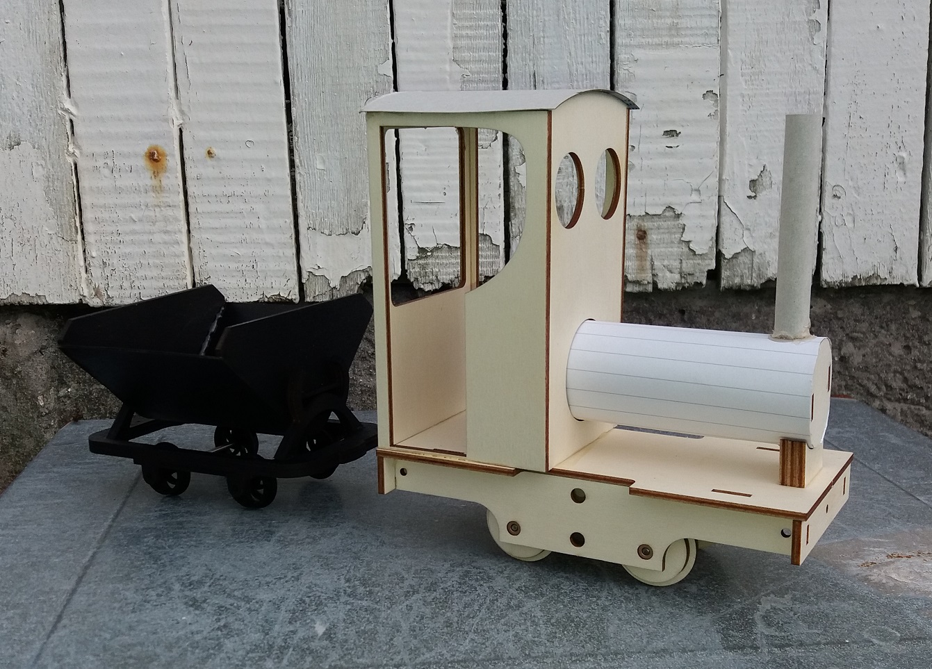

I'm toying with the idea of a 7/8ths Cracker. This was just a quick mock-up from various sketches so the cab is too wide. "Boiler" is 42mm. I quite like how it looks.
