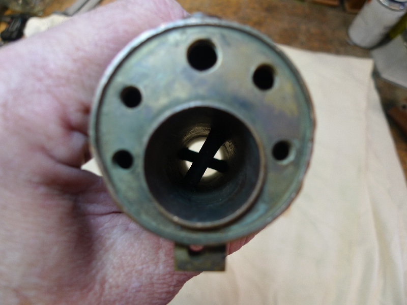

Fortunately, I do however possess a pair of model loco boilers, (I gave a fuller description of them and asked for help on these in a separate post on the "Help Me" forum), built many many years ago by an elderly model engineer who had sadly passed away, and which came into my possession via a local scrapyard some years ago and then stored, almost forgotten. I was worried that the criss-cross water tubes might preclude the use of a "poker" type burner as shown in the "Eric" plans.

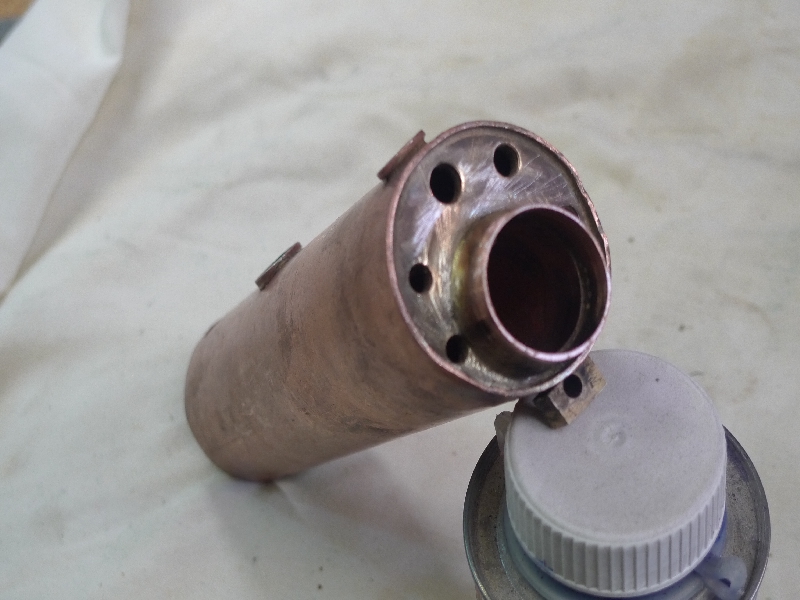

Thanks to Graeme (GTB)'s advice, I got in touch with Jerry at Clevedon Steam, (no connection/usual disclaimer) and after a most helpful chat, discovered the boiler could be fired with one of his gauze propane burners and an "adaptor sleeve".

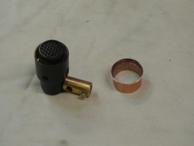

Thanks to Jerry, the burner, jet and a ready part - formed adapter sleeve arrived this morning.
A trial "fit" looked promising.
I silver soldered it onto the small lip of the flue tube, using silver solder paste - very quick and easy, and no need to make up "Easiflow" flux.
The eagle eyed among you may have spotted that there is an abundance of orifices in these boilers - apart from two proper tapped bronze bushes in the boiler top, there are 5 tapped holes in the backplate and two tapped holes at the smokebox end.
Most of these must be blanked off with bushes - for the next job.
None the less, I am encouraged to think I may well end up with a good quality loco boiler, thanks to a chance meeting in a scrapyard!

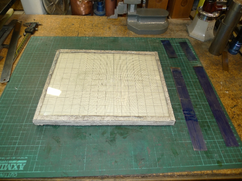

Whilst on the subject of "Flat Surfaces" :-
A very useful "build plate" can be made from an off-cut of plate glass backed with a piece of block-board (or similar) of the same size. Sandwich a sheet of metric squared (or graph) paper between the two and tape the edges together with Gaff Tape.
This plate is really useful in assembling box like structures (rolling stock/buildings) - you can check the right angles by lining the bits up against the squares before gluing finally. Before assembling the paper/glass/block sandwich, I went over the squared lines with a 6B pencil and ruler first so as to make them stand out.
Overspills of glue/cyano/paint etc. will easily be removed from the glass surface with an Xacto blade or similar.
Mine is very old and a bit the worse for wear.
I do not claim this idea as mine (I read about it many years ago somewhere) - but am just passing it along if it will help anyone in their efforts.

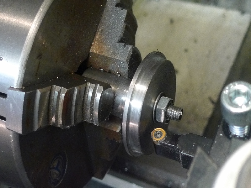

The instructions in the book are very good, and there are more very good articles on wheel turning to be found on the internet. Given that (obviously) each wheel has to be identical, I was a bit nervous about this job, but with the moon and Venus in correct alignment, and the chicken entrails looking good, I felt encouraged to gave it a shot.
No prizes for being the fastest here - take it slowly, step by step and all seemed well.

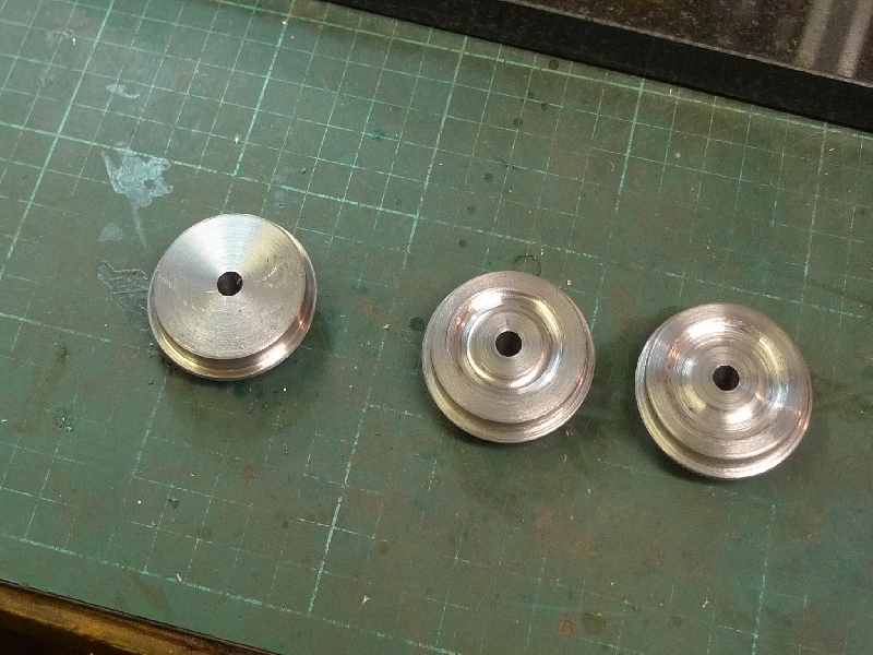

I had ordered a length of 45mm dia. mild steel and cut off four slices each slightly over length for four wheel blanks.
I was not going to maim myself hack-sawing these four blanks from such thick material, but rather used a 1.5mm metal cutting chop-saw disc in my angle grinder.
Follow the instructions, and bring each disc almost to length, and turn the boss on the rear having set up each blank to run true in the lathe four jaw chuck.
I used a lathe ER32 collet to hold each boss and machine the outer face, rim and tread, plus drill and ream 1/4 in. for the axle.
Do the tread angle with the top slide set over to 3 degrees, and all seemed well.
The collet did not allow further work on the inside of the wheel rim, so I swapped the collet setup for a 1/4 inch mandrel I had in stock from an earlier project, as absolute accuracy now is not so important.
This set up was used in the three jaw chuck to finish off the profile edges of the rim with a file.
The outer face boss and recess were then machined with a tipped (rounded) profile tool (the rim has not been profiled yet in this photo!)
Here are two (finished) wheels and one to yet to be face-profiled.
Finally, to drill and tap the inside bosses for the grub-screw.

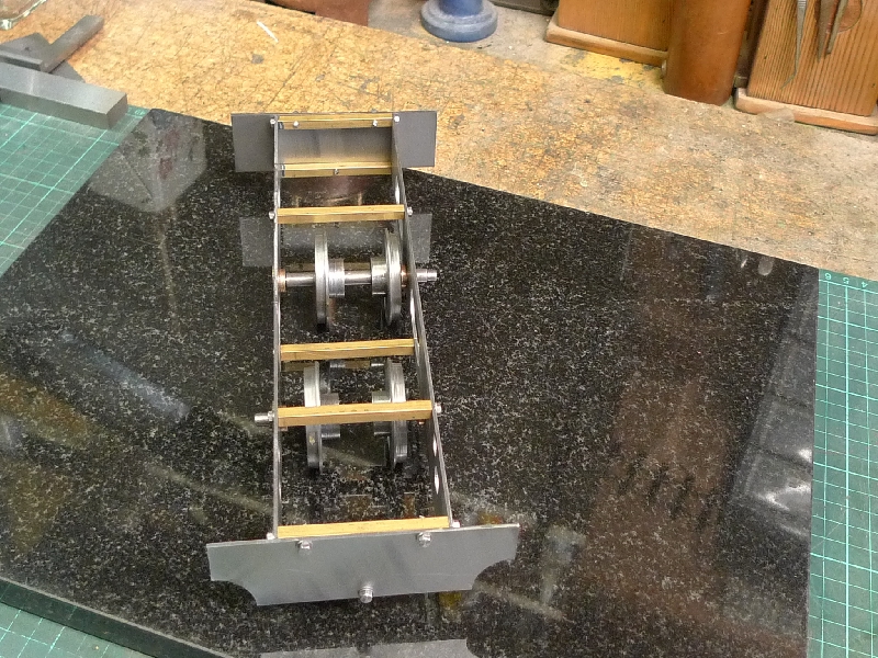

Well here's the finished basic frame and wheels - using the laser cut frame parts.
I have yet to "embellish" the front beam with rivets and am not sure whether to add the wooden blocks/coupling hook to the front/rear beams or indulge in centre couplings.
The book makes a rather vague reference to the fact that the loco can be gauged to either 45mm or 32mm. As you can see, from the second pic. that there is a lot of space between the wheels and axle bushes in the frames when gauged to 32mm.
I assume that when the cranks are fitted, the axle slop will be dealt with? Should I turn up bronze spacers to centre the wheel sets anyway?

The axle sideplay is designed to be controlled by the flycranks. You could fit spacers for 32mm, but it removes the option of changing the gauge if the need arises.Peter6911:111840 wrote: I assume that when the cranks are fitted, the axle slop will be dealt with? Should I turn up bronze spacers to centre the wheel sets anyway?
