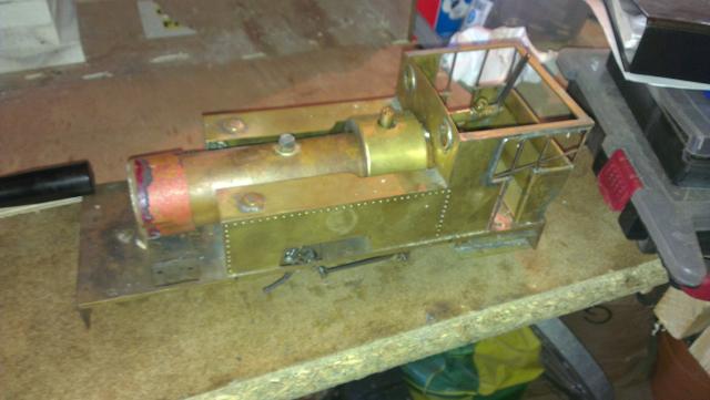

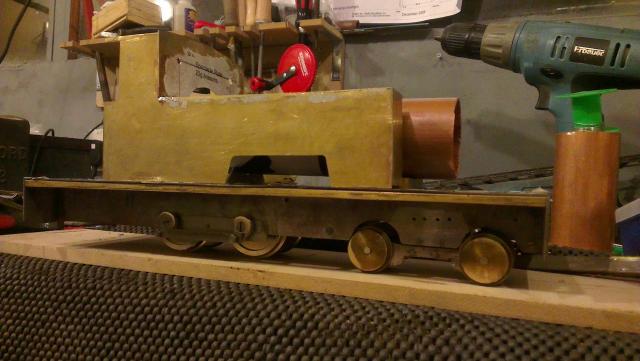

If been reading posts for a while and seeking advice from this forum so i thought it was time to show you what im up to. I have a few bits on the go.
So here goes
Im building isibutu with designs from keith Bucklitch
Complete with my first attempt at homemade cylinders
Its going really with working boiler. Need to modify the valve gear and build the steam chests now.
I am also in the progress if building the line itself. But the hot weather is slowing me down. Heat and heavy blocks do not mix. Ont op of that building small wooden scratch built wagons. Hope to have some track down by the end of next month for simple running. Must finish making the point work

A bit more progress a few more parts on. I want to get the inside of the bunkers done. i dont like the open space, looks funny . Anyway got any good ideas on how to roll the roof? as i would like it removable.

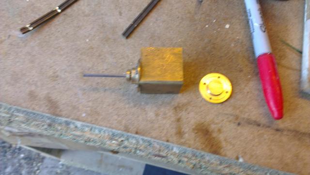

I also made some real progress on the cylinders last night. I just have the slide valve and all the outer gubbins to make and trim up and pollish. then ready to move onto the other side.
