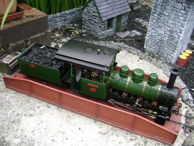

This is mine. It is made from various metals (!) and is rotates on a central pivot surrounded by a 3 inch diameter washer for support. Each end has two model car wheels attached (they're just visible) for support. The whole lot sits on a concrete disc with the wheels running on the concrete surface.

Tony - I think I will go for one in the style of yours. How long is the bridge on yours?

steamyjim:98924 wrote:Tony - I think I will go for one in the style of yours. How long is the bridge on yours?
It is on its second railway now, and on my first it sat on a 2ft x 2ft paving slab, so I reckon about 1ft 10in. Roundhouse list the Fowler as 530mm long, which equates to 1ft 9in.

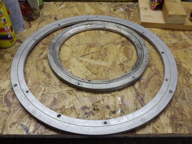

Brian, I also like to rotate my nuts!... The aforementioned 'Lazy Susan', x 2. They were snapped up on eBay for £2.60 with a turntable in mind. The larger one is 20" across!! Each has 6 or 8 nylon bearings between the inner and outer ring and after a squirt of WD40 they spin like good 'uns'!
