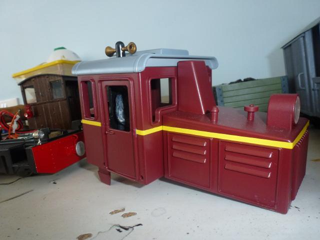

We've been busy here in Gloucestershire!
After 1 year, it looks like we'll soon be finishing our 2 Playmobil locomotives (finally).
So far, the big work is connecting up the huge amount of wiring!

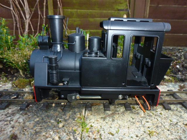

The steam engine now:
So far, the locomotive is almost finished!
All that is needed is:
Wiring up the radio gear and motor.
Attaching the cylinders and valve gear.
Adding the steps, vac/air pipes.
Lining and naming.
The diesel is even closer to finishing!
Both should prove to be useful machines! :)

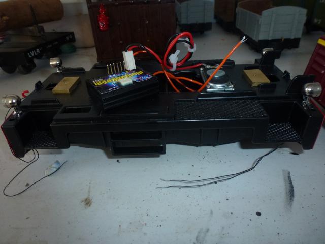

However, I've noticed a weird technical problem with either the reciever or the speed controller...
When I connected it all up for a test run, it all worked beautifully! When I connected it back up it didnt want to know :(
Ideas anyone? It's an Mtronics controller from C2B[/quote]

This may be a bit obvious, but have you connected the ESC to the correct set of servo pins on the receiver?
It is also possible to put the connector on 'upside down' because there is no polarity lock.

Yeah The ESC lead is abit annoying, but I have tried it both ways up.
I use channel 3 (it's a 4 channel controller). Channel 3 is the traditional "left vertical is regulator" so it's nice and easy to remember which one you toggle to make it go faster! :)

Could try it on one of the other servo connectors, just to see if it makes any difference?
Have you got another rx and/or ESC to do temporary connections to, to try to identify which is causing the problem?
I've just had another thought, which just MIGHT be a 'lightbulb' moment - I wonder if in the process of moving things around, you have accidentally somehow affected the ESC calibration with the Rx. It may be worth going through the calibration procedure again, just to be sure.

After more testing (and swearing), I discovered the cause of the problem: the Receiver.
The ESC is working good, but the receiver isn't, looks like I'm going to have to visit antics! :(
