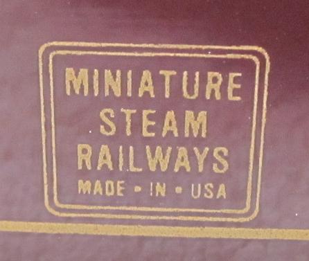

MSR made tenders to match a number of the SL series including the SLK1, SL3 and SL6. I have examples of each of these MSR tender bodies.  The SLK1 black tender missed out on the pinstripes as I understand it this was because of the difficulty in matching the red used by Mamod on the SLK due to variations in Mamod's own production runs and the red used not remaining the same during kit production.
The SL6 tender I have also carries a screen printed MSR logo:
The tender body used on this loco was stripped and powder coated satin black. You can just see in the picture at the rear of the tender 2 small holes that I added in order to mount a brass ladder in order to match the MSR set up. The Plantation's tender used a nice stamped brass ladder on the rear.  Unfortunately Terry did not have any of these - this part was originally from Model Engineering Works who are no longer trading so a close match had to be found. Brandbright supplied the ladder and it is a close match although sadly it is no longer available from them (I think I bought the last ones from them).

So what happened to MSR and why is so little written or known about them compared to other manufacturers?
Well the very sad answer to that is that Jim Wilson passed away in 1995. This fact is covered on the Sidestreet Bannerworks page on MSR.  Jim has been described by Terry as an "Idea Factory" in that he could think up more ‘goodies’ for MSR to work on than could have possibly ever been produced. In fact MSR had started to work on a 2-6-0 using a boiler of MSR’s design and 0-6-0 conversion frames which never really got further than the drawing board. Jim had also ventured into steam mobiles and had been working on a Steam Roller model of an American design, and had even built a prototype for it.  The most amazing item in the MSR works was a "Diesel outline" locomotive which Jim had come up with that was propelled by a Sterling Hot-Air engine.  Believe it or not MSR had also built an amazing Mamod based Panzerzug train for running at shows!! Its very sad that Jim died so suddenly and at a relatively young age.  It makes you wonder what could have happened to MSR had they been able to bring to the market some of these other models.  Terry has been a great help to me in providing information and has stated that running MSR was “fun while it lasted” but when Jim died, a lot of the fun died with him.
MSR were formed right at the start of Mamod’s Steam Loco offering and they continued off and on until Jim’s death in 1995.  MSR produced around 45-50 Plantation engines and 150-175 MSR tenders in various colours. MSR unfortunately did not keep any detailed production records so there is nothing recorded about the rolling stock production. It’s safe to say though that the tank cars and crane car are pretty rare items.
The last MSR
The very last Plantation loco that Terry sent out was a rebuilt one for the Pennsylvania Railroad Museum. The museum had purchased an MSR Plantation Style engine and had used it daily at the museum to demonstrate the principles of steam locomotion to the public, and had literally worn it out!  The MSR loco went back to Terry for a well deserved refurbishment. It must have covered countless miles on the steam display area track at the museum – whether it continues to run in public view I am trying to find out.  I have contacted the museum and will post any new information about it that I find.
